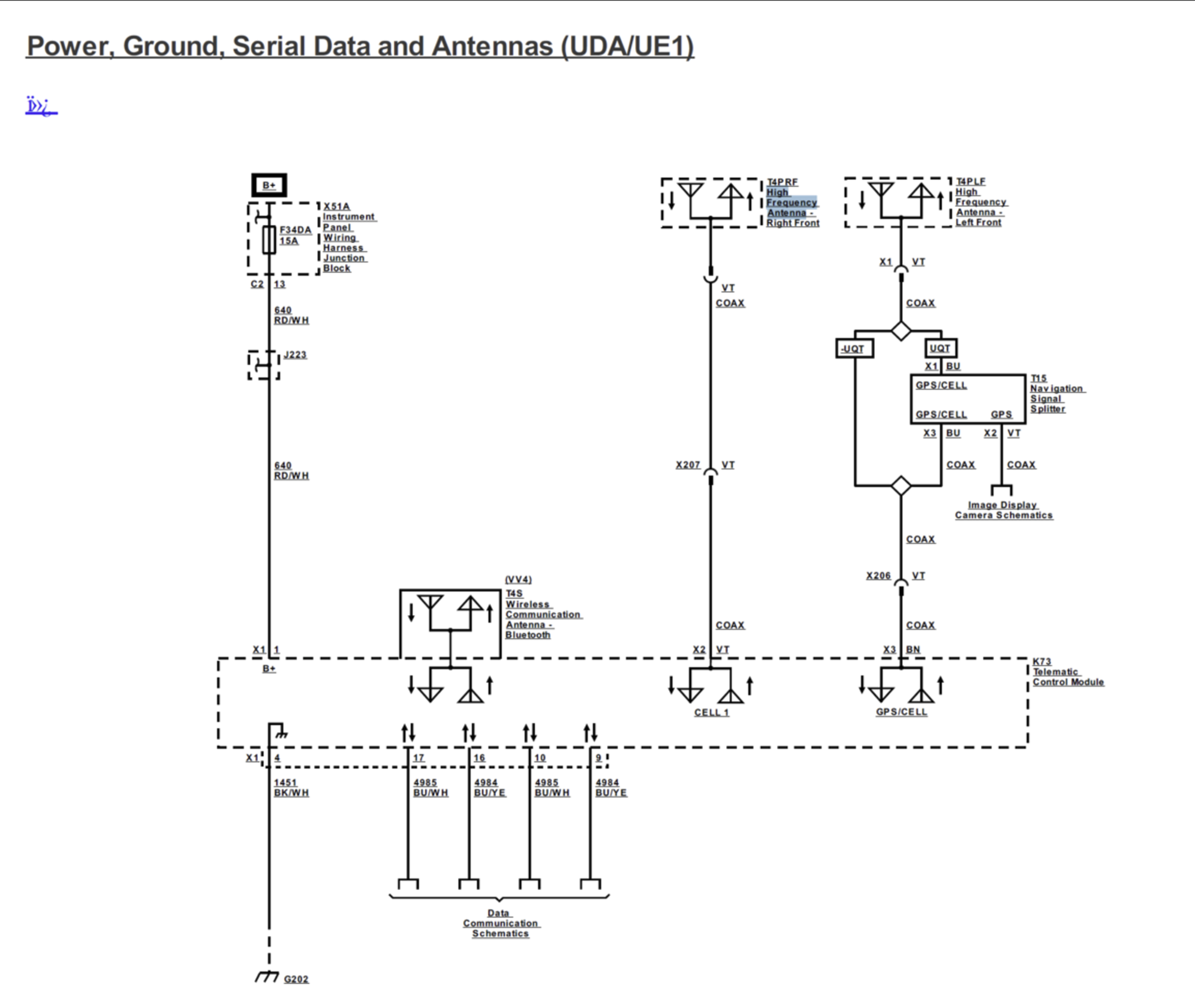

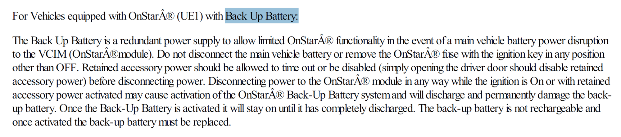

Its going to be F34 in the C8 according to the Owners Manual and the schematic. In the glove box panel. However, there is a back up battery. Based on what the Service Manual says, that battery will go active if the fuse is pulled or if the car battery is disconnected while the ignition is still on. You must wait for the retained power accessory to time out before disconnection the power to the Telematic module in any way, or the back up battery will be enabled - which would allow tracking. That is the whole point - is to allow tracking in the event of an accident that otherwise disables power to Telematics.

Andybump--Thank you for your detailed reply. It appears that the designers planned for such an eventuality. I have owned several Corvettes and until now have considered myself somewhat knowledgeable, but the electronics on these new cars are off the freeken planet. I have been a forum member for many years. What an asset it is to have people like you as members Again, thank you---NoBull

Like another poster mentioned the schematics, it is viciously intertwined with all the other onboard systems. Like it or hate it On-Star is permanent with GM products.

Read carefully though. If you turn off the ignition, and then wait for the retained power accessory to time out, then you can pull the fuse and/or disconnect the battery without triggering the back up battery. Or, at least the it seems to imply that.
