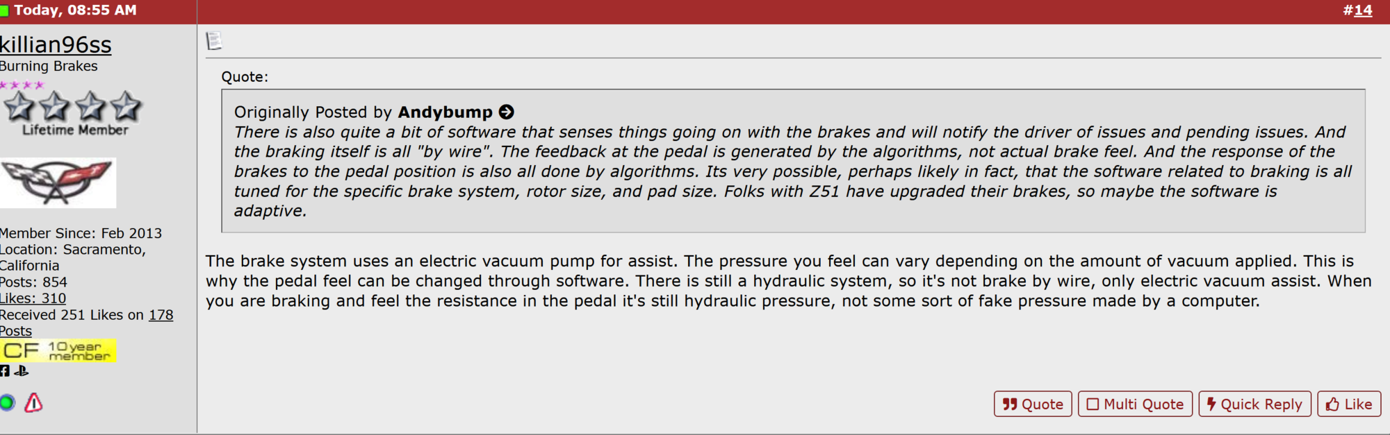

There is also quite a bit of software that senses things going on with the brakes and will notify the driver of issues and pending issues. And the braking itself is all "by wire". The feedback at the pedal is generated by the algorithms, not actual brake feel. And the response of the brakes to the pedal position is also all done by algorithms. Its very possible, perhaps likely in fact, that the software related to braking is all tuned for the specific brake system, rotor size, and pad size. Folks with Z51 have upgraded their brakes, so maybe the software is adaptive.
As correctly pointed out by @killian96ss , in a post he apparently deleted later, the brake system is not entirely by wire. When fully functional feeback to the pedal is regulated by the software, but in the event of a failure, there is actually a connection from the pedal to the hydraulic system.
Last edited by Andybump; Mar 5, 2024 at 09:29 AM. Reason: delete reference to by wire

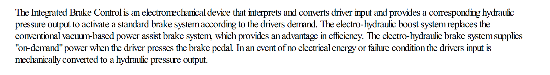

@killian96ss , your explanation, attached, seems inconsistent with the description in the Service Manual. No vacuum booster at all. However, as you pointed out, in the event of a failure, the the driver pedal input will be mechanically transferred to the hydraulic system, so in the event of a failure its not brake-by-wire. I have fixed that error in my earlier post - thanks.

my post was all messed up thinking about another GM vehicle I have with electric vacuum assist (21 Trailblazer), but the systems are similar. I deleted my post as soon as I realized my info wasn't correct, lol. I definitely didn't say the C8 had a vacuum booster as it's just a variable electric vacuum pump which supplies the assist (common on all new GM vehicles).
I've never liked the term "brake by wire" because it's easily confused with "drive by wire" where the gas pedal has no mechanical link to the throttle body, but in the brake system there is still a mechanical link.

Yeah - so that "mechanical" connection to the hydraulics in the even of a "failure" apparently requires a lot more pressure. Too bad the car doesn't have a "test" mode so that one could be familiar with the pressure required in that situation. I'll bet steering real bad too. When ABS first came out, a while back, I recall having my wife test it on wet road so she would understand what was going on if it happened unexpectedly. (not that the mechanics are the same - its just the concept of testing feature like that in safe environment).
