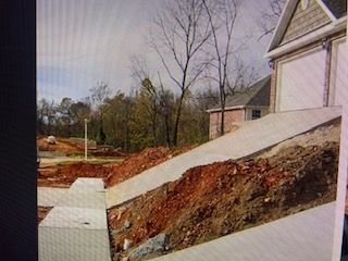

Originally Posted by 449er
Please tell me that driveway is photoshopped? Sam

That aint gonna work!
