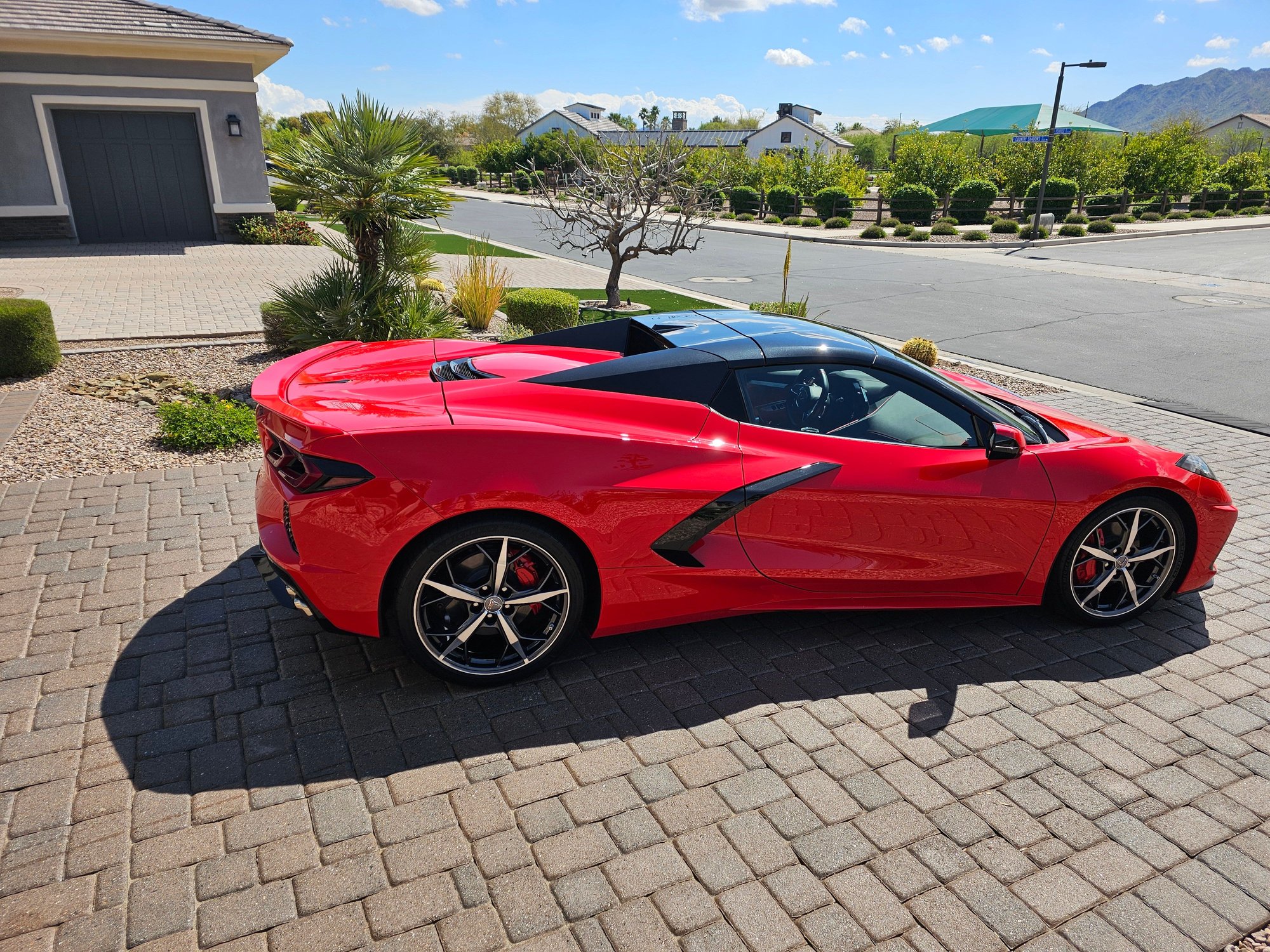

Just had my 2022 paint corrected (clay bar, etc.) and ceramic coated. The paint now looks flawless and the Torch Red looks much deeper and has more gloss than I could ever get with polish and wax. $1350 for all exterior surfaces except the glass.

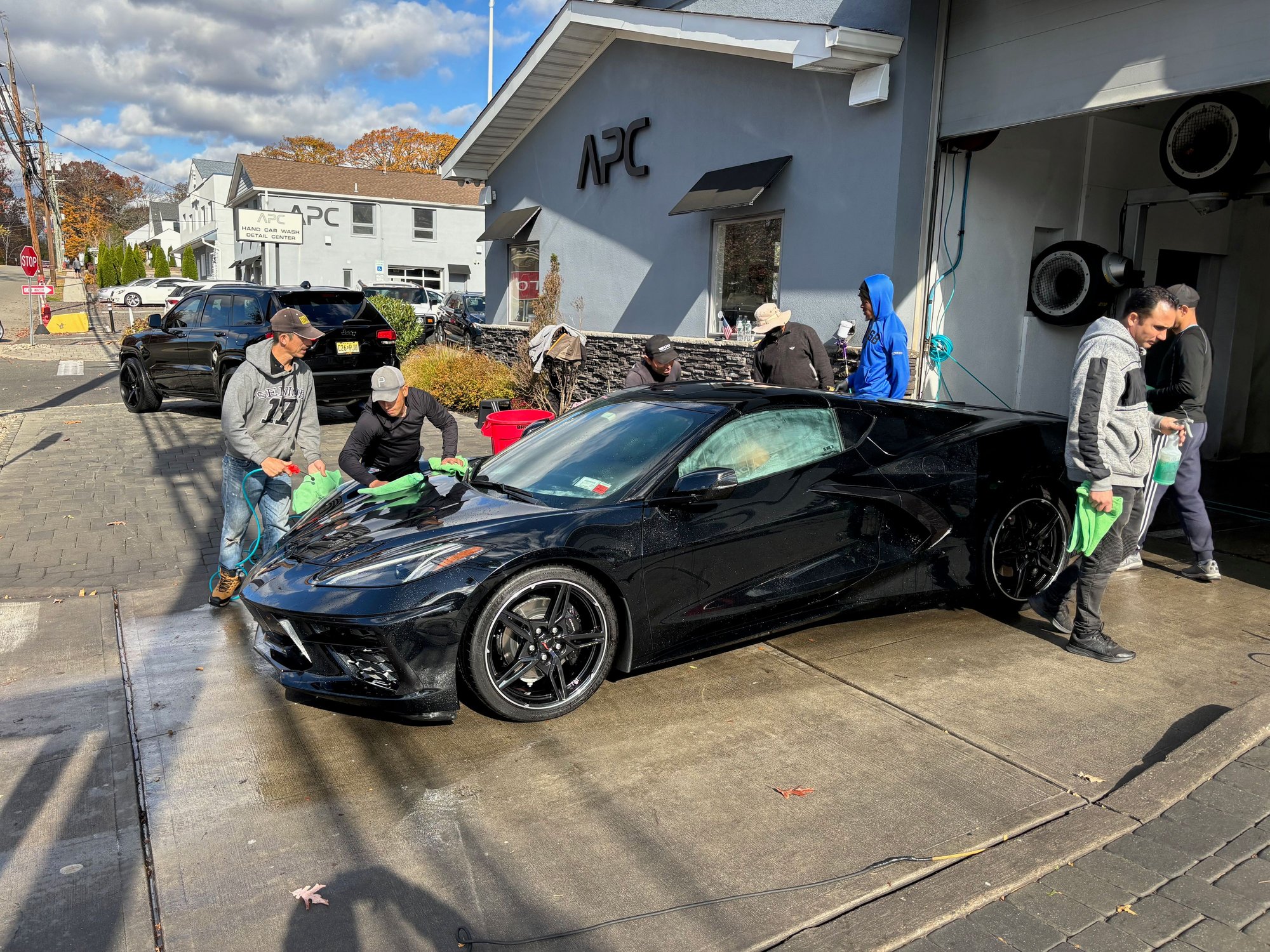

Originally Posted by C8_ANGELONFIRE
Definitely go for the ceramic coat! Helps the paint shine and pop.
Did that car just come out of an automatic car wash ? ?? !!!

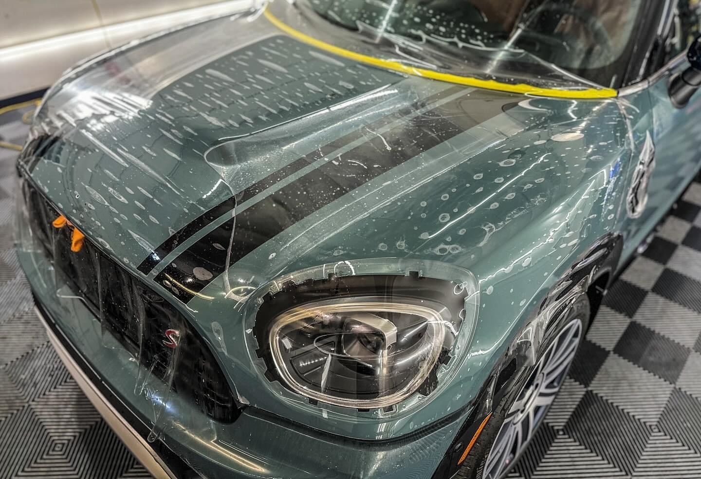

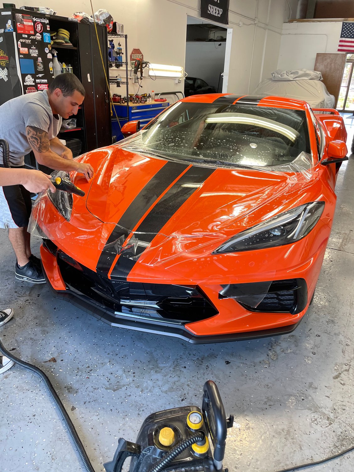

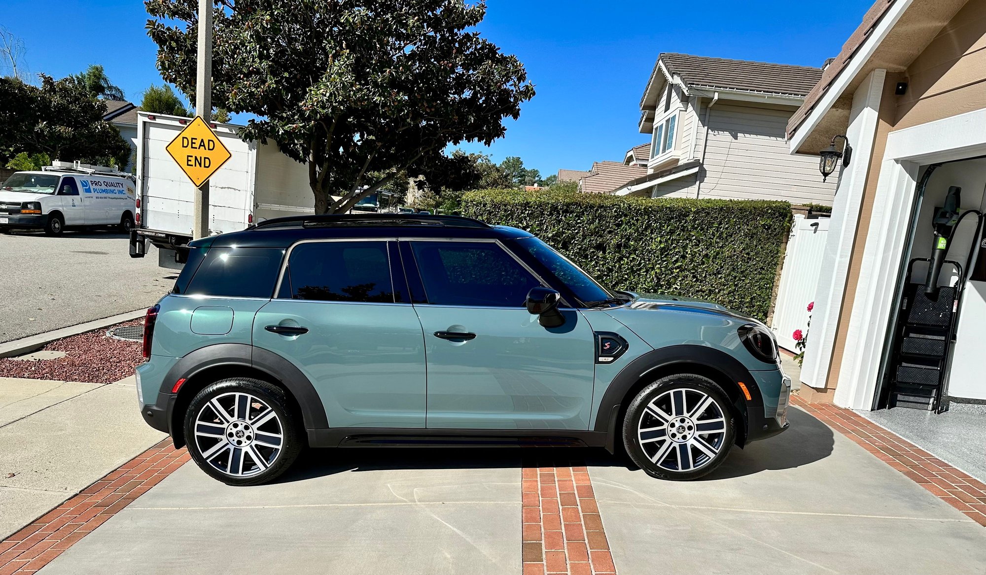

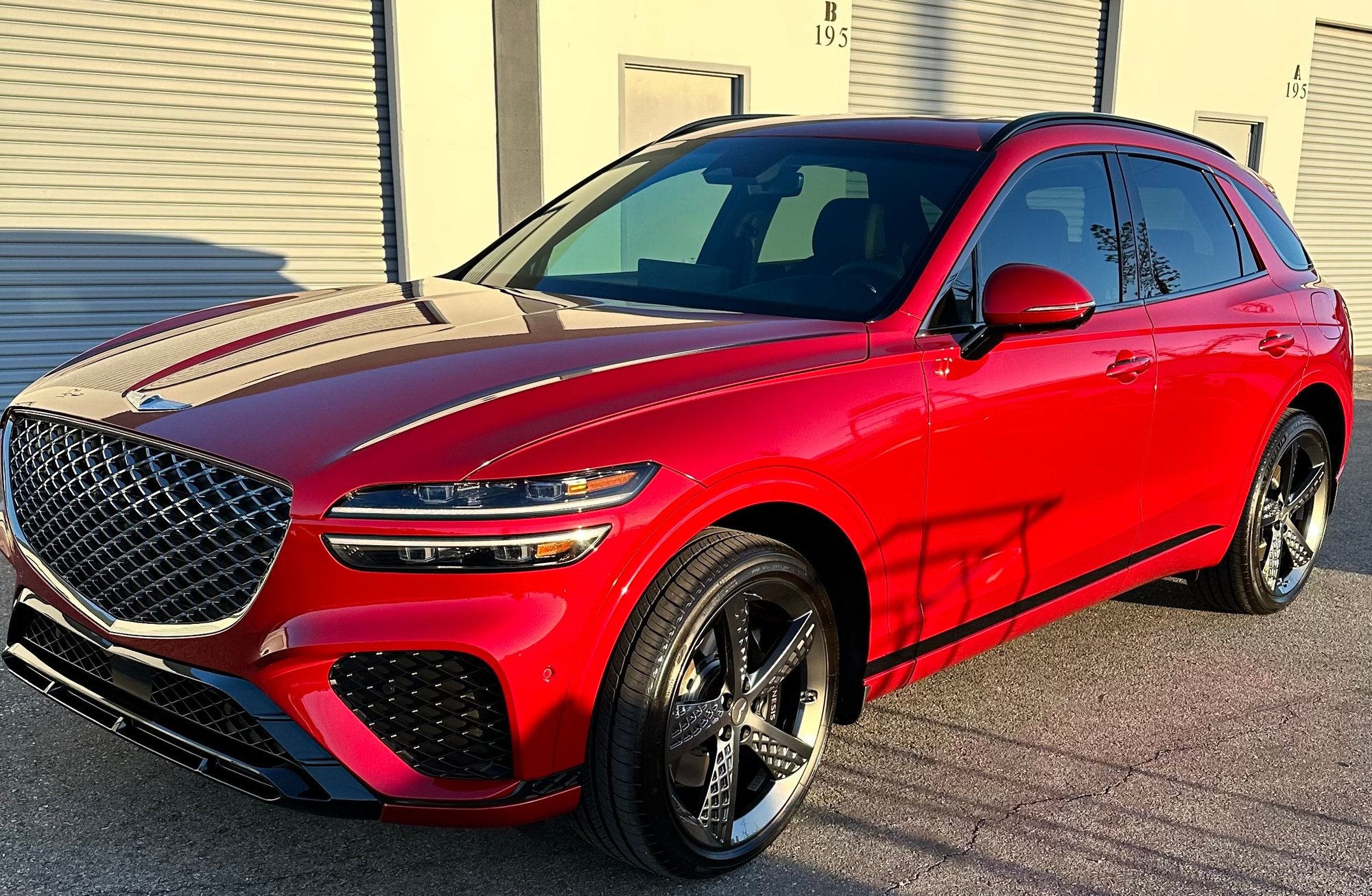

I go through the process with every new car I buy….takes a week at my installer.
1. wash
2. Paint correction
3. PPF (Stek Ultra)
4. 4 layers of Ceramic ( GTechnique Crystal Serum Ultra) including wheels/barrels.
5. Ceramic window tint on all windows (includes windshield and sunroof/pano)
I only use a waterless wash and with the exception of the Mini Cooper, if driven in the rain, never have washed a vehicle in probably a decade. Warranty is 8 years with annual “maintenance” in which my detailer washes then applies a top coat of GTechnique. Yes it’s an investment, but every vehicle that I have sold with this process has returned the cost and then some.

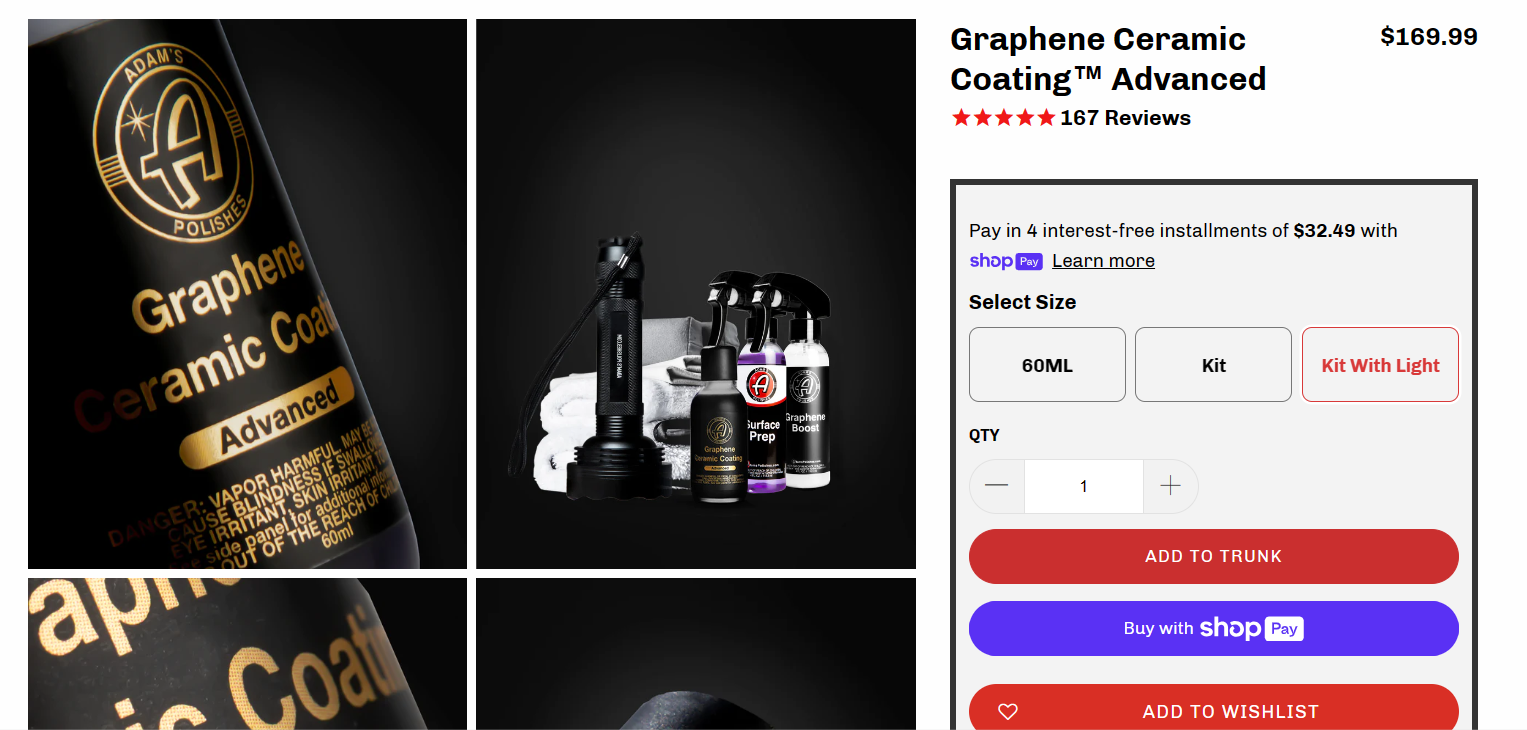

Is this the preferred coating??
red coating??

Yes that is the kit you want... Make sure to use the discount code at the top of the Adam's website - currently its "EGG" for 25% off (as of 3/27/24)

Ask 20 folks and you'll likely get 20 different answers on what the best (or preferred coating is); truth is that if sticking with a major player in the coating game (i.e. not some e-bay or heavily marketed through social media product) it's a pretty safe bet that 90% of folks will be happy with 90% of the coatings available to them. It's when you start looking for that extra 10% of 'goodness' that some products stand out. Does that extra 10% matter to everyone...I'd guess not.
But for some of us the journey is just as important as the destination and that extra 10% matters so down the rabbit hole we went, enjoying the ride the entire way down
