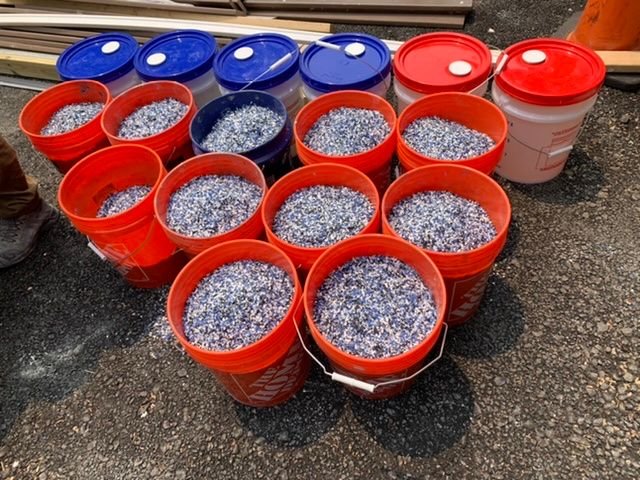

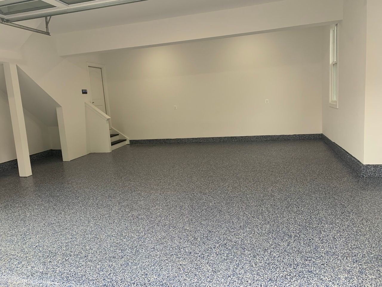

Originally Posted by Performance nut
Hey all, what do you have on your garage floor? I'm about to close on a house and wondering which I'll like better. I have always regretted not doing anything in every house I have owned. This time I'm hoping to do it day 1.

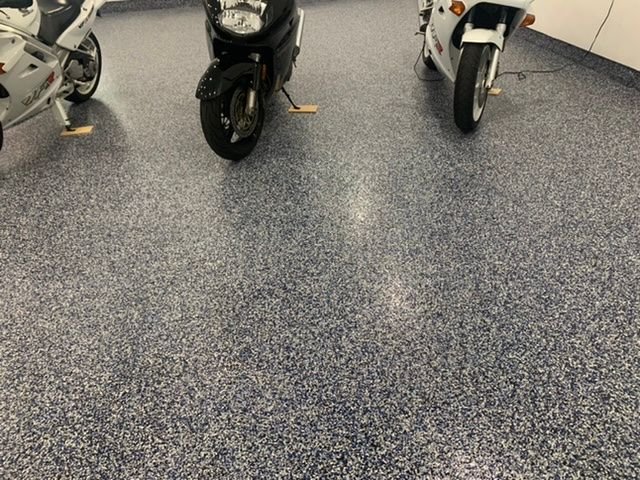

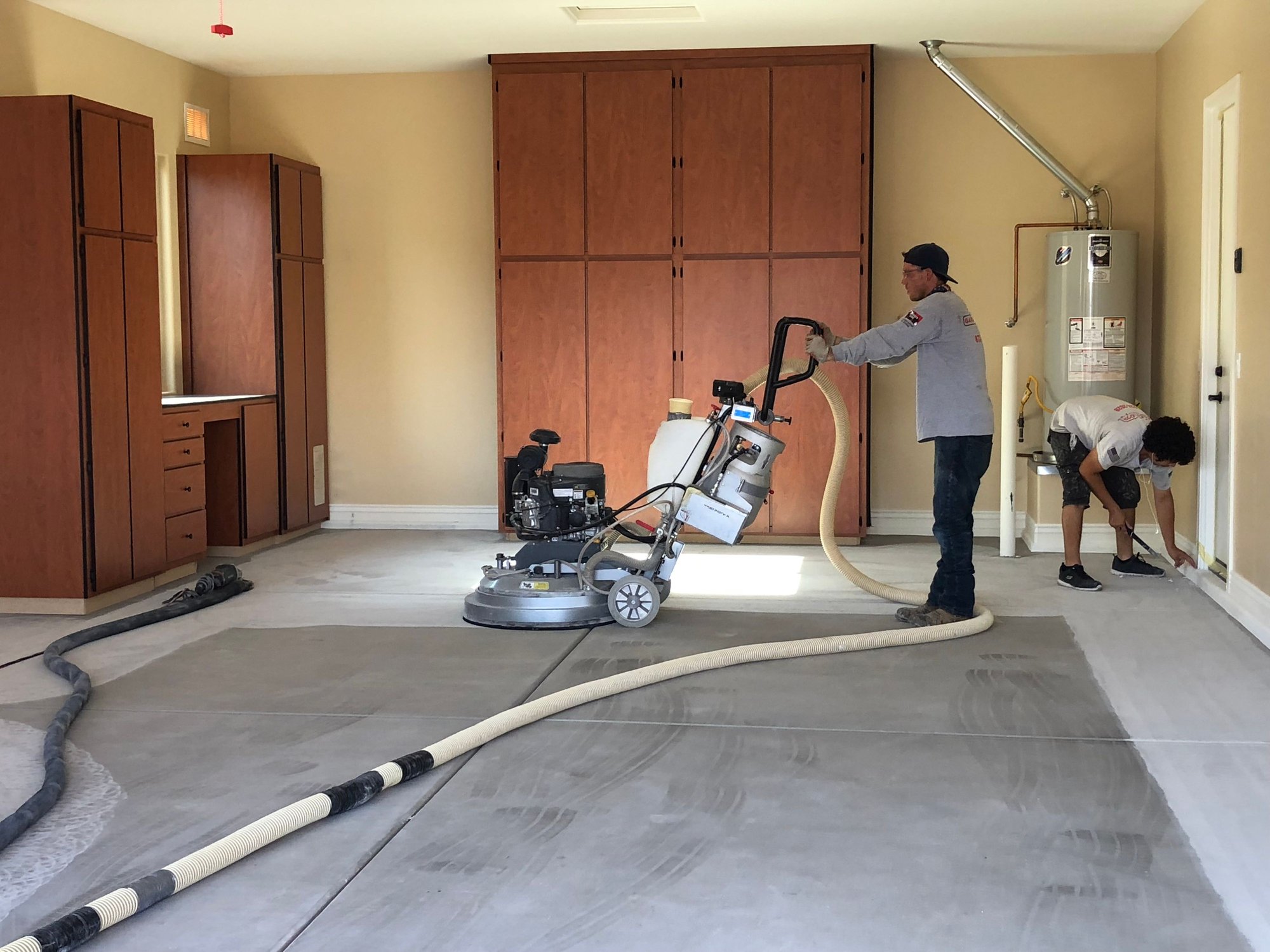

Do it before you move ANYTHING into the house. Once you move in, it won't get done...
Here's ours:
This is sage advice. The floor delayed our move by a week, but if we had started the move first, the floor was - no way.

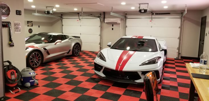

Swisstrax floor tiles for me, pretty much indestructible, comes in many different color choices, & the individual tiles are replaceable once installed

SwissTrax for me, looks great and was easy to install...

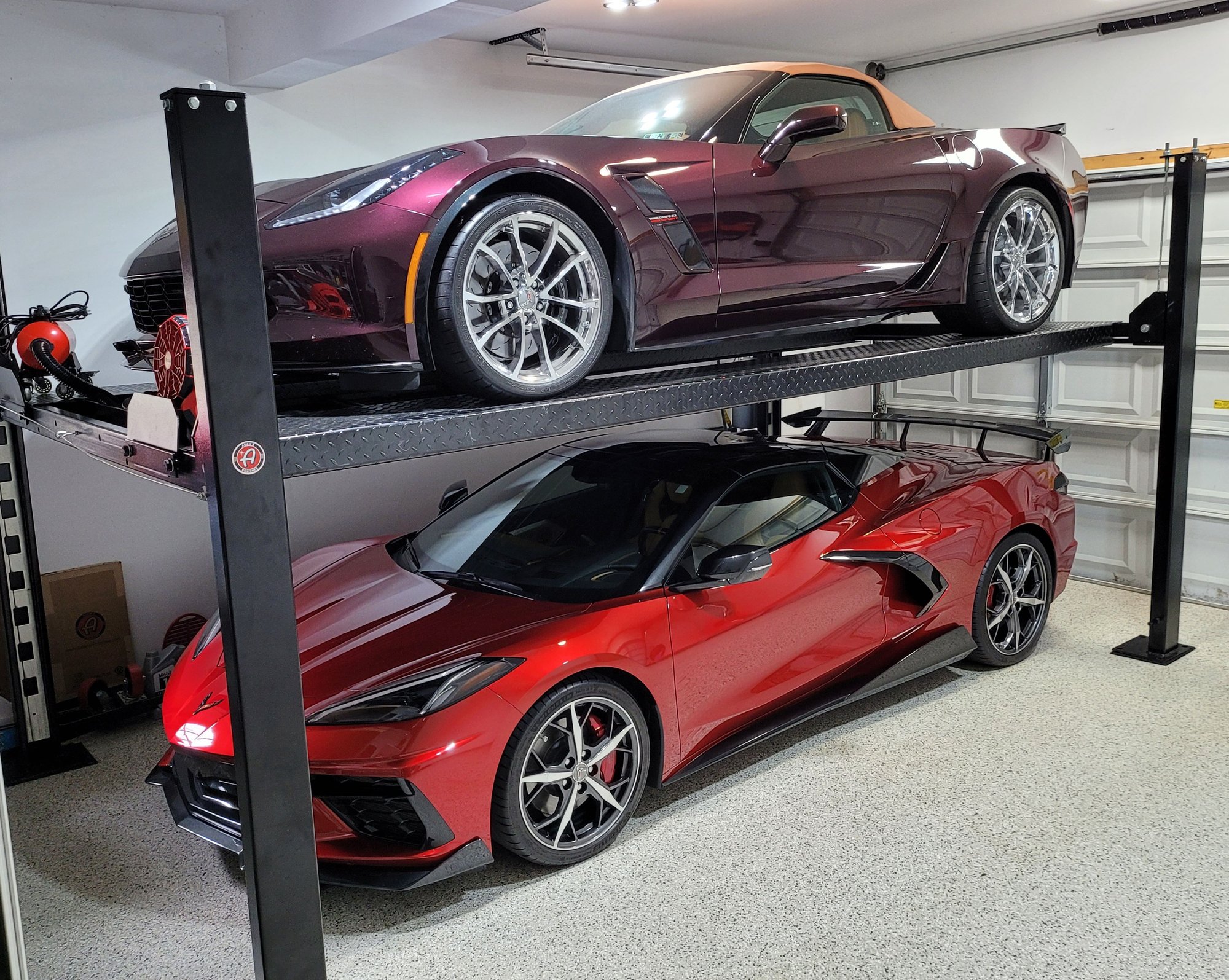

No, I definitely do not sell this. I compared several different flooring materials before buying for myself. My 2-car garage was about $3,300. You have to wait 3 days to drive on it and it takes several weeks for the smell to go away. But after a while it's undetectable.
The temperature listed in the copy may be incorrect as it gets PLENTY cold here in Cinci. I have an electric grill in my garage and use it throughout the winter -- with me often walking in my garage only wearing socks on my feet. This flooring (along with others) seals the moisture out so the floor is significantly warmer than just concrete alone. I think the installers said they used about 70 lbs of flakes in the flooring.

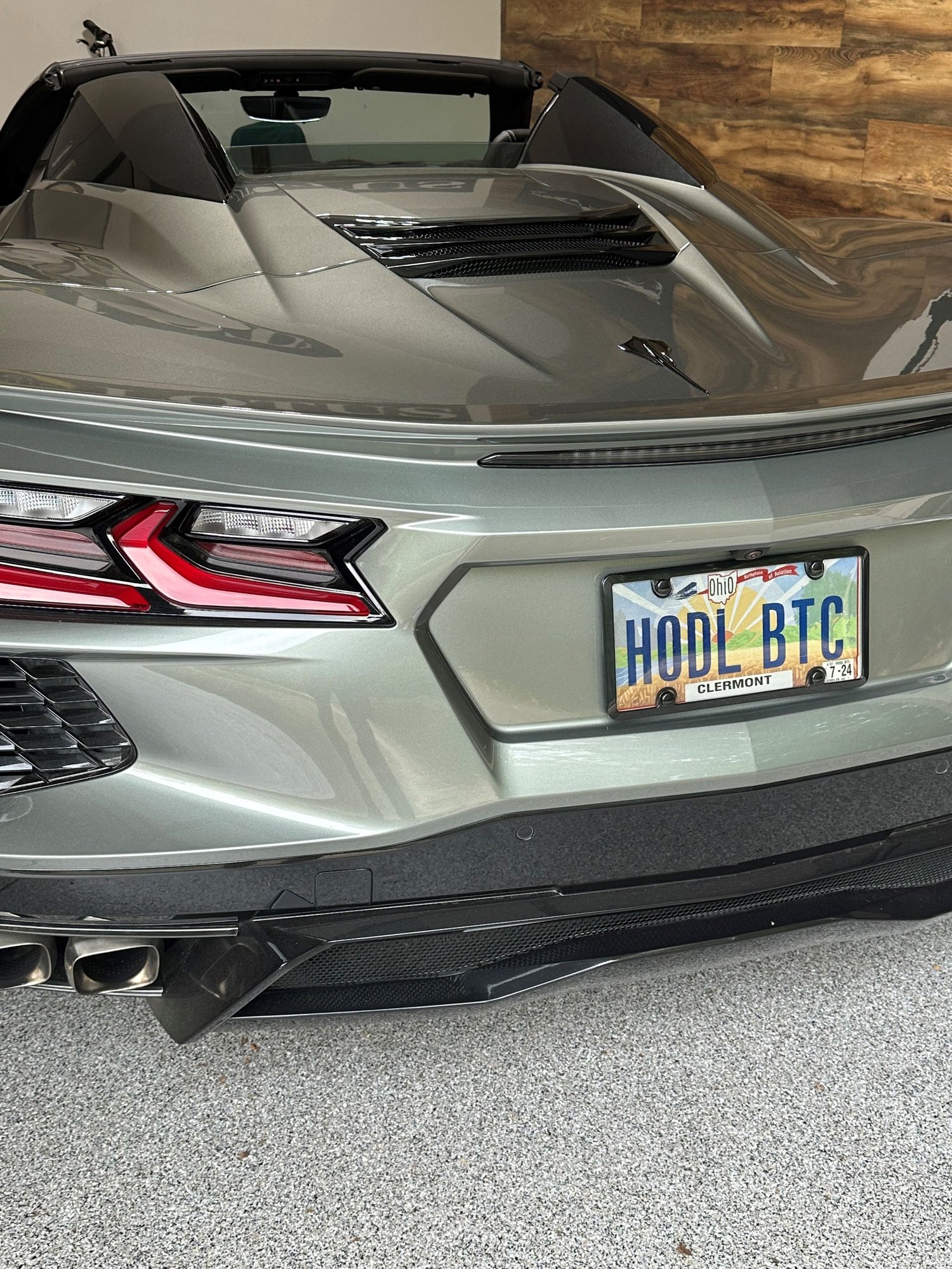

Originally Posted by Skid Row Joe
Photos of your floors ??

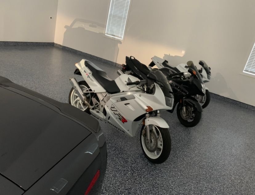

Not a tremendous view of the floor, but you get the picture.

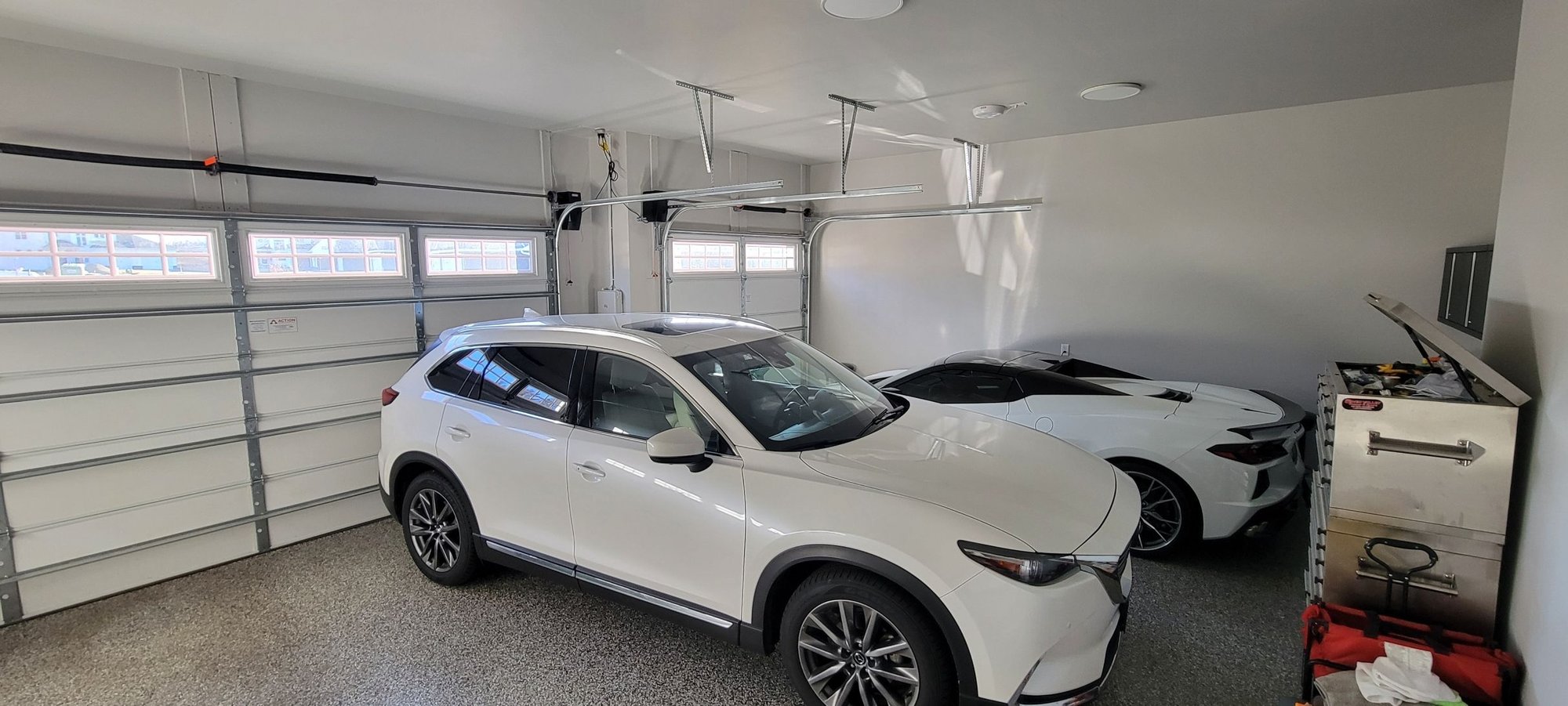

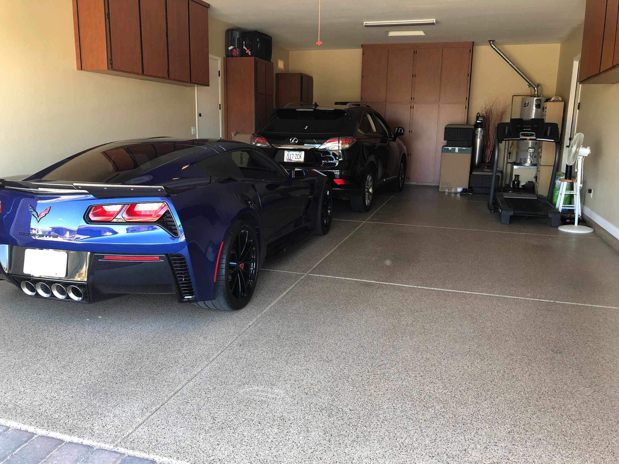

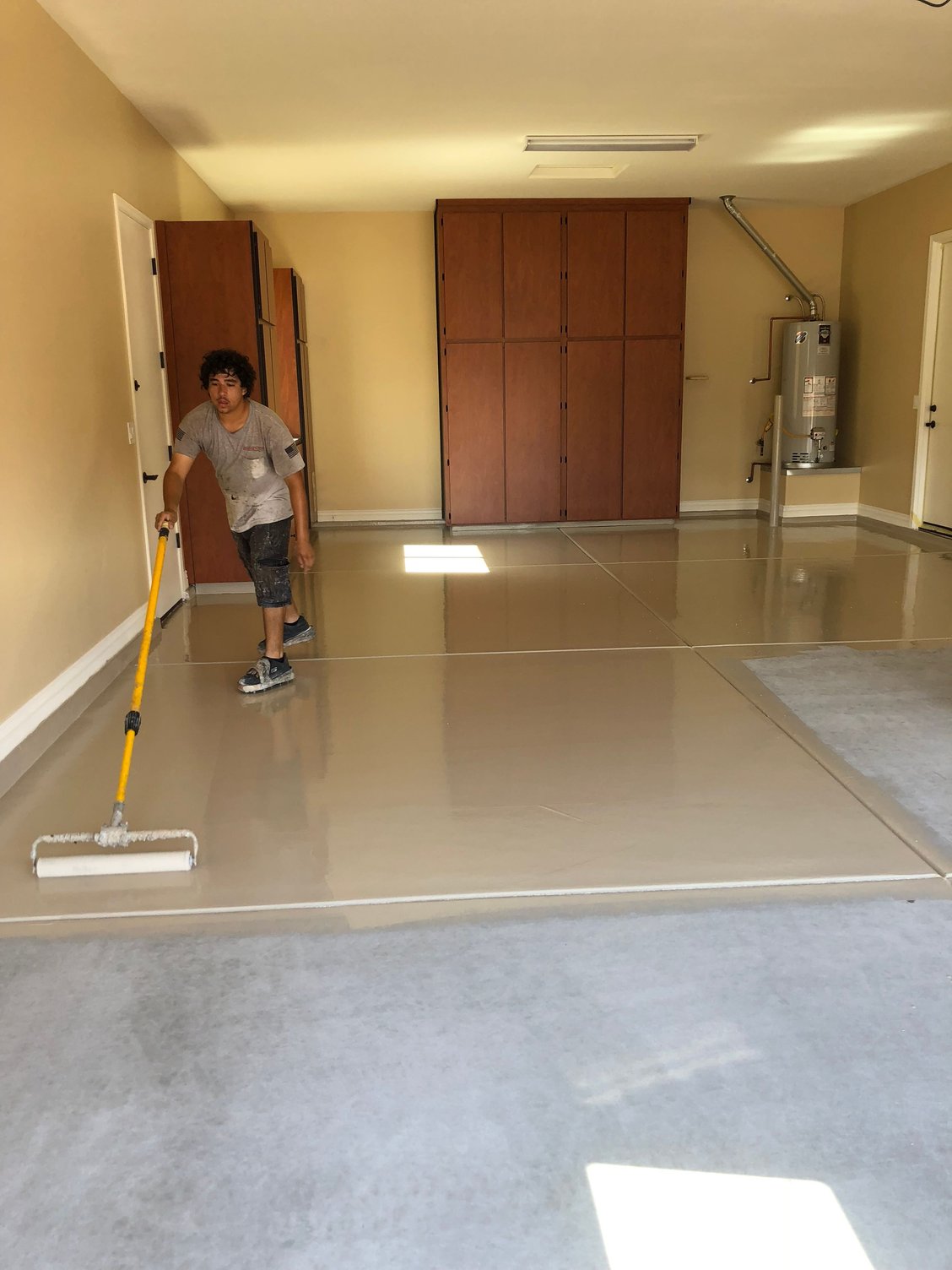

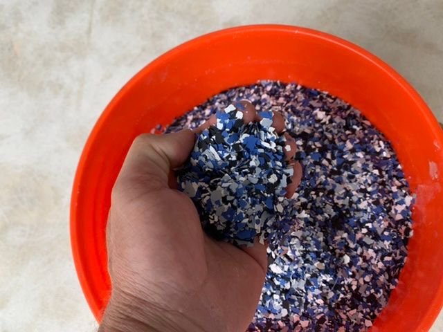

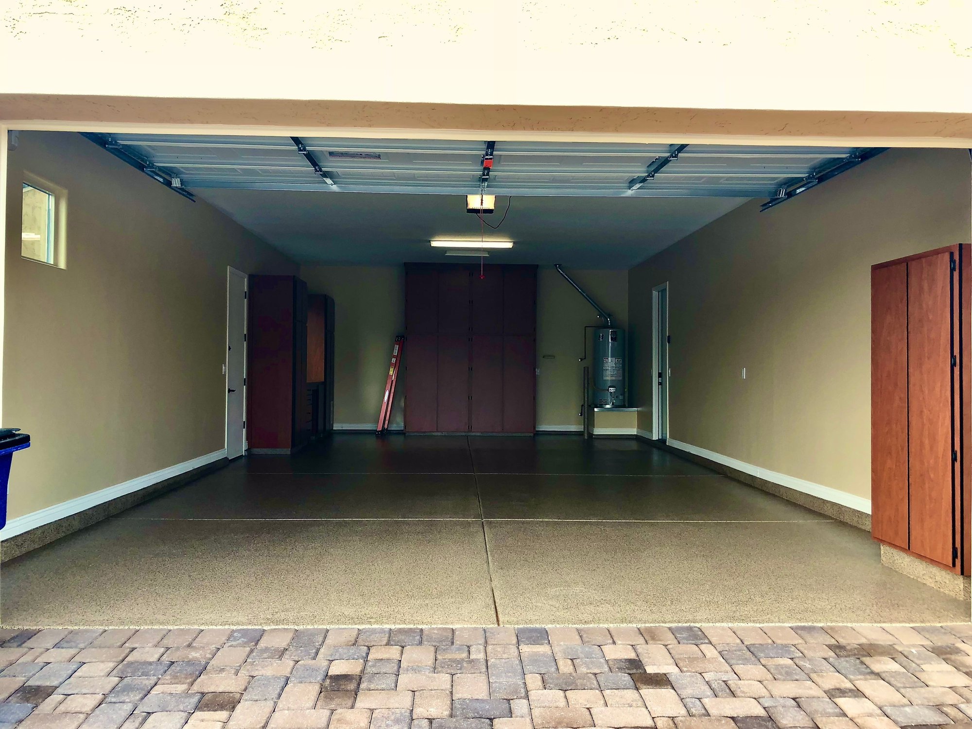

5 layer granite chip epoxy coating professionally done....my garage is 38 x 22....I think it was about $1,100 5 years ago....still holding up great. I've only had to clean it maybe 4 times in all that time....2 coats of clear on top of the 3 other layers...
Floor looks great! That's a pretty deep two car. Is it a Shea by chance? I say that BC we had a Shea home in Encanterra (East of you) and our model had a similar very deep two car.

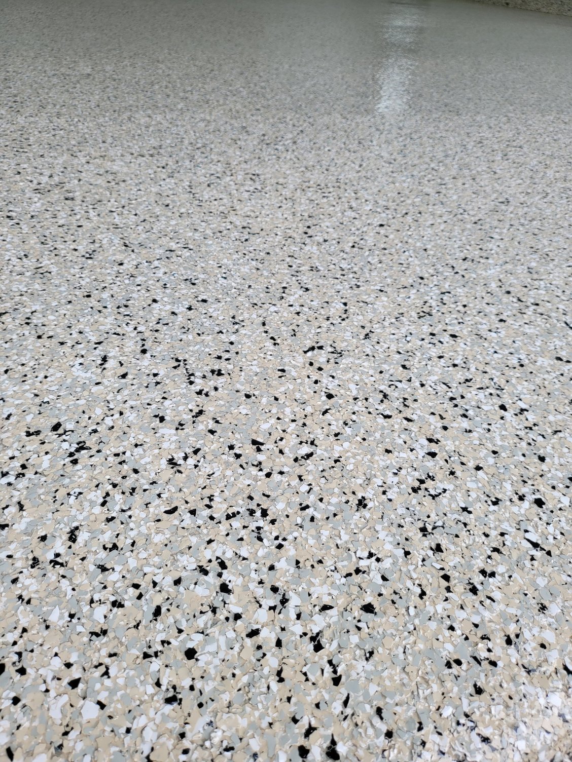

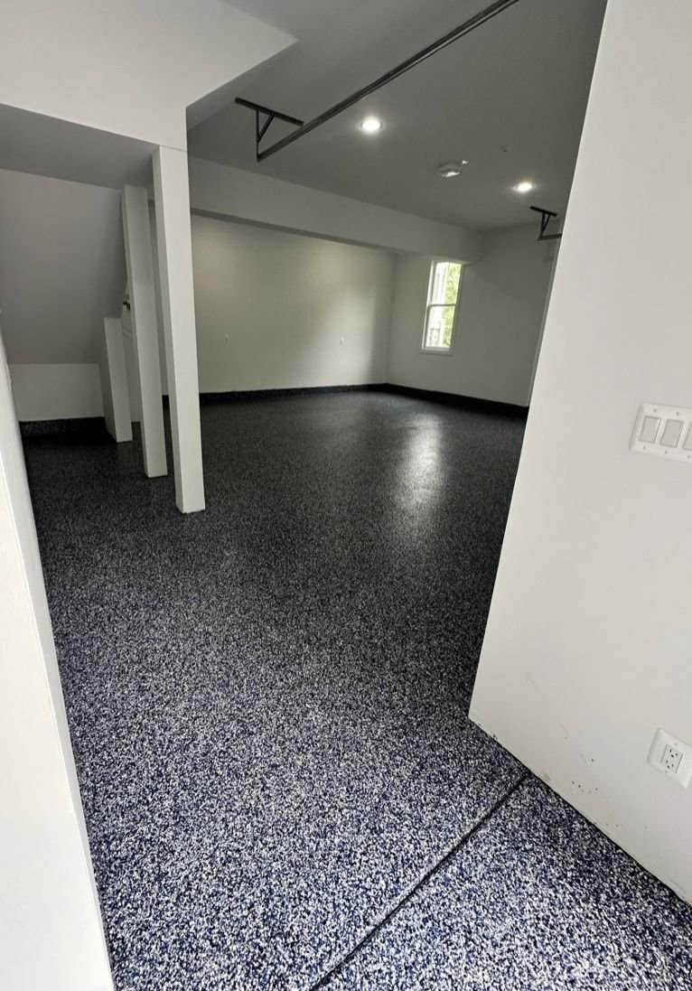

I have used epoxy kits in the past on other garages and really had no issues with them but for this home I had it professionally done. Grind new concrete, fill expansion joints, polyaspartic coating with full chip. Would be my recommendation.
It's actually a double tandem 4 car garage. I park 2 RX350's back to back in it along side my C8 and my wife's treadmill on the right side...these are Taylor Morrison homes. Beautiful to look at but built like crap....
Back when I had my 17 GS....plenty of room...
