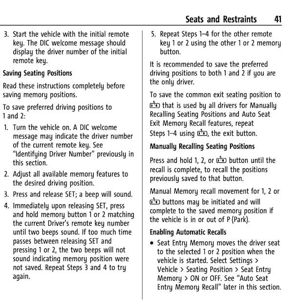

Unfortunately, you have to hold the button to manually recall a seat position. See here from the Owner's Manual:

My ride is a 2025, and the only way to get the memory recall function to work is to press and hold the memory recall button, OR depress the brake pedal and start the engine. this is in line with the operating instructions in the 2025 owners manual...I know Chevy is monitoring CF, I would like to tag them for comments...
