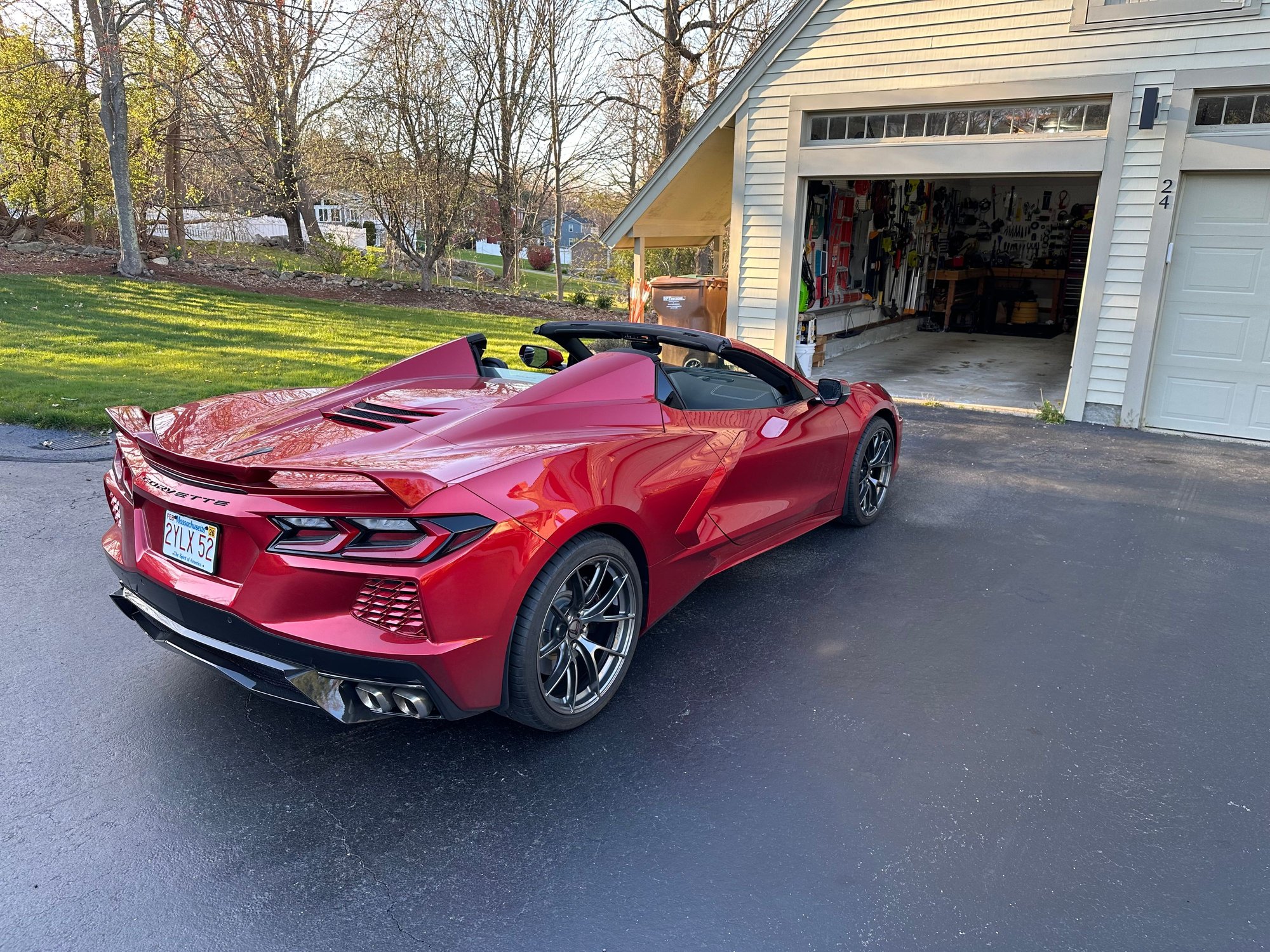

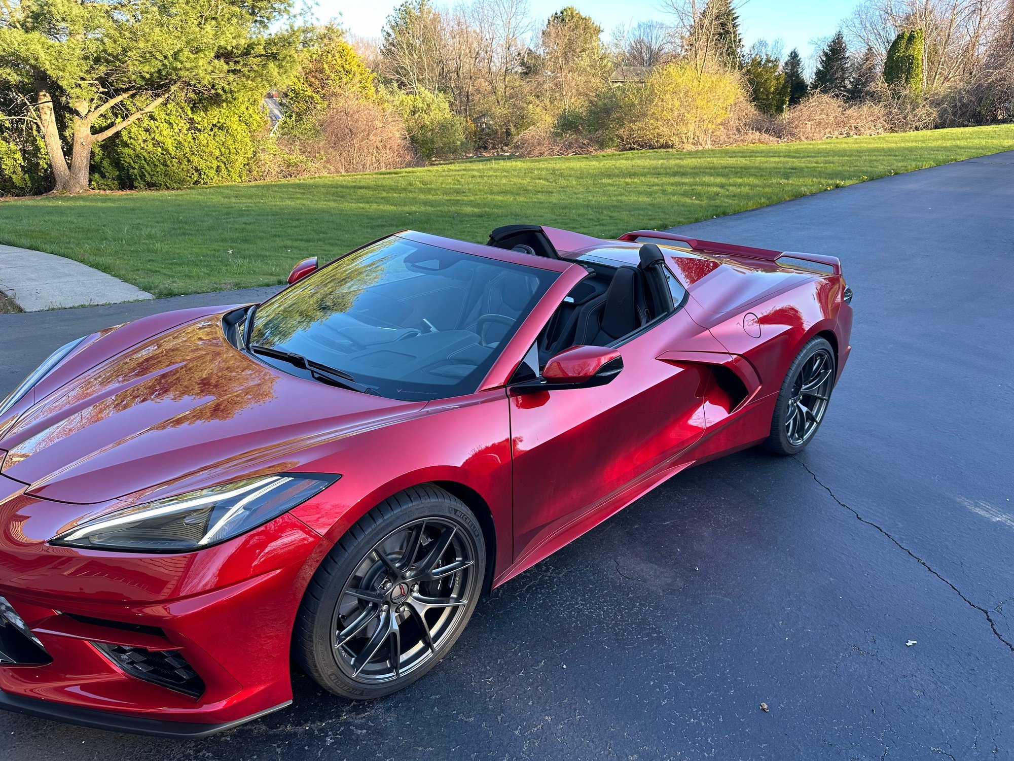

Wheel color makes a difference, with these gray wheels the brake dust is no longer noticeable between washes. Probably not a practical solution and wasn’t why I picked them but a solution nonetheless

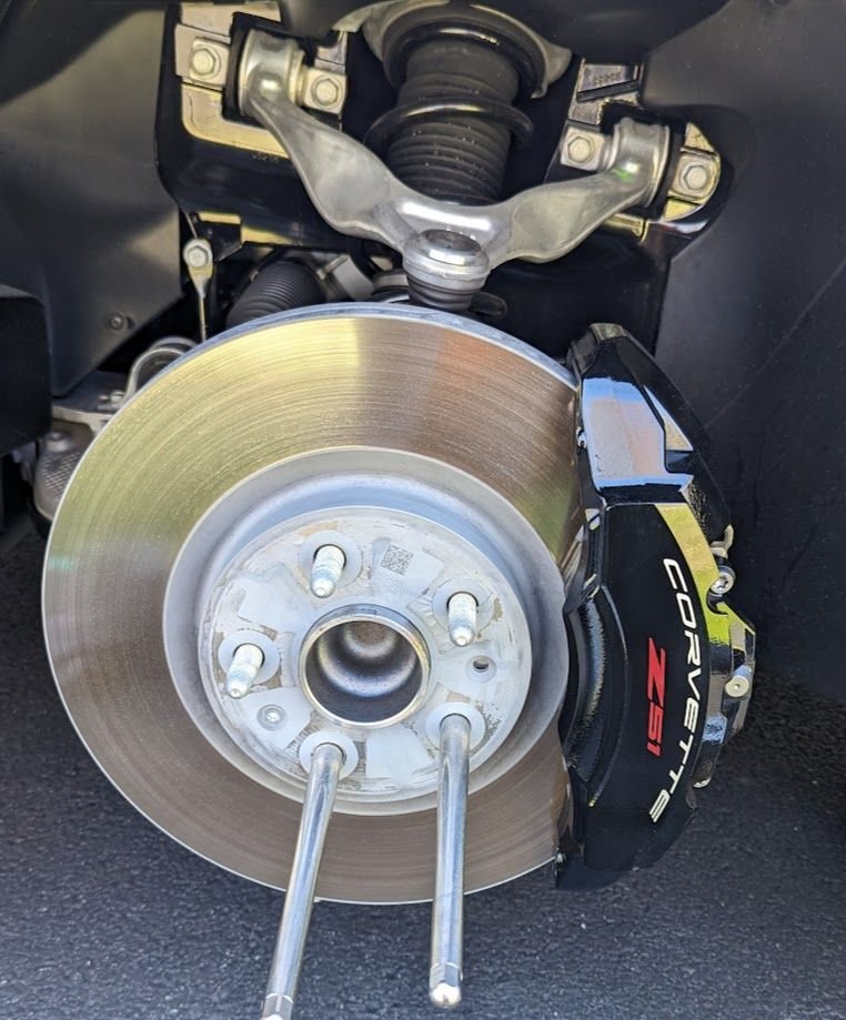

With the Z51Brembo brakes just couldn't get along with the heavy dust. Very heavy. One of my first mods was the 1521 CarboTech low dust break pads. Still have them after 25K+ miles and could not be more pleased with the almost zero dust and overall performance. They matched up perfectly with my lightweight 2-piece Gyro Disc rotors.

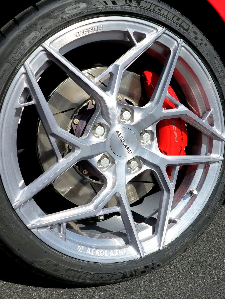

Low Dust Pads and Ceremic on your wheels is great, especially if you go with an upgraded wheel.
