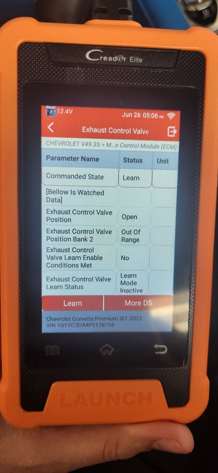

Got the borla atak on my 2023 c8 stingray htc and it threw the CEL code as expected.
I read through the threads and purchased the Creader Elite (Launch) and put the car in accessory mode, followed all the instructions and was able to get to the menu for special functions and learning.
The two areas that need to be learned were the deactivation and the exhaust control valve. The Deactivation one learned on the first try and is without fault.
I cannot get the other one (exhaust valve control) to learn. I says exhaust control valve position bank 2 is out of range and the exhaust control valve learn enable conditions met (no) and learn mode inactive.
I have tried a few times after turning car on and off etc but cannot seem to get the exhaust control valve to relearn.
Anyone have experience with this or other ideas to try?

Can you feel/hear the valves opening and closing during the relearn?
This is what I did and it worked perfectly the first time, but I’ve read that some had to do the relearn a couple times:

For the one it worked on, yes
for the exhaust control valve one, no its says learn but nothing happens
That video is great and the one I used as well.
Of course it cant be that simple though.

Sucks that it’s not working. I disconnected the battery during the install. Not sure if that makes a difference. Perhaps try that to reset. GL
