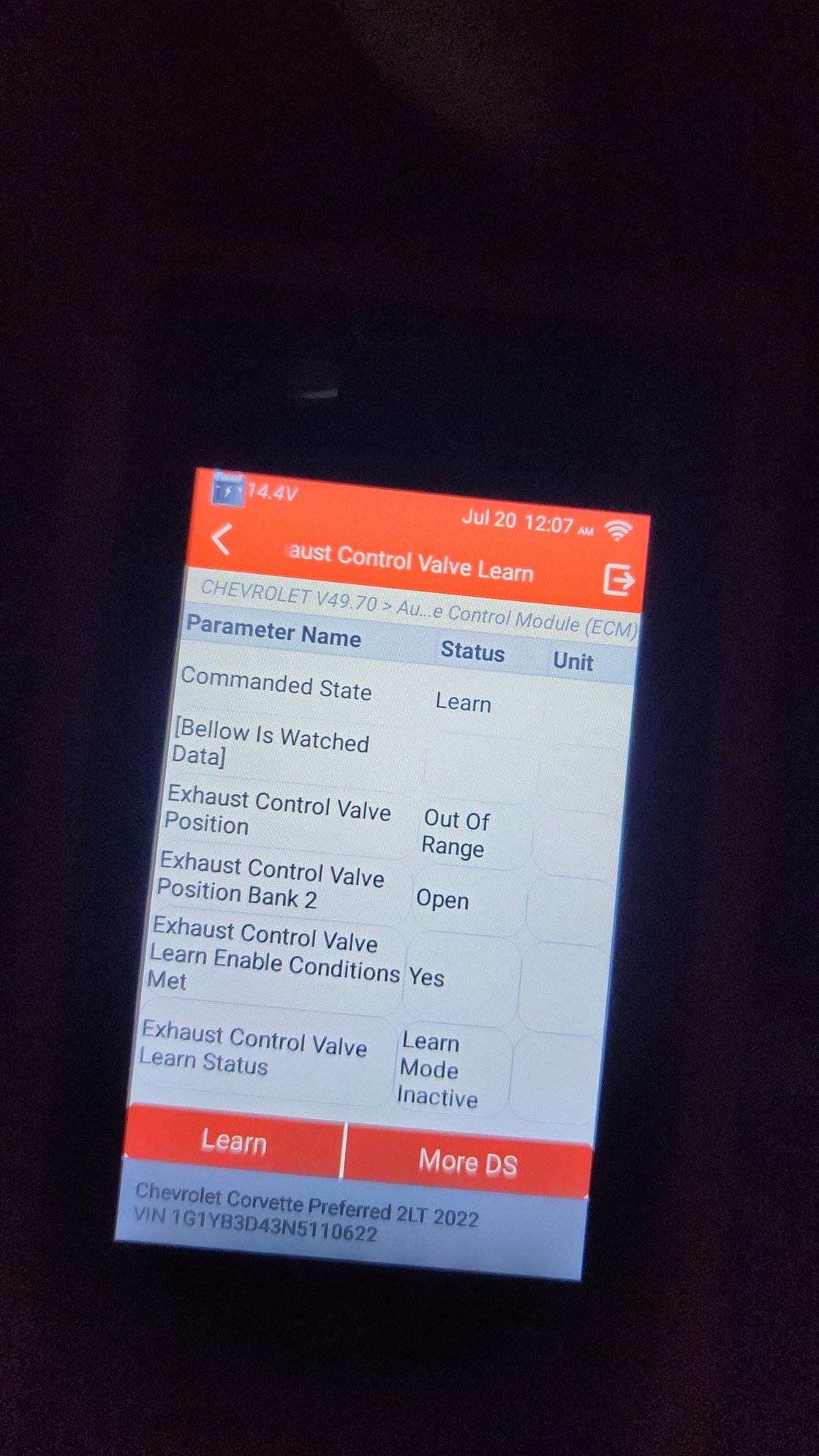

I have a 2022 with NPP. I bought a Borla ATAK. The first two had a defective valve so Borla swapped them out and has been great to work with. I'm on my third and they said if I still have problems then it's just not compatible with my car and I'd have to go back to stock.
My third was installed today and when I am not in Z mode, it shows off and off for exhaust control valve position and exhaust control valve position bank 2. When I switch to Z mode so it stays in V8 mode, I get out of range and open. My last two exhausts have never showed out of range. Nothing changes when I hit learn.
Now I got a CEL because of the exhaust after trying to hit learn.
Suggestions?

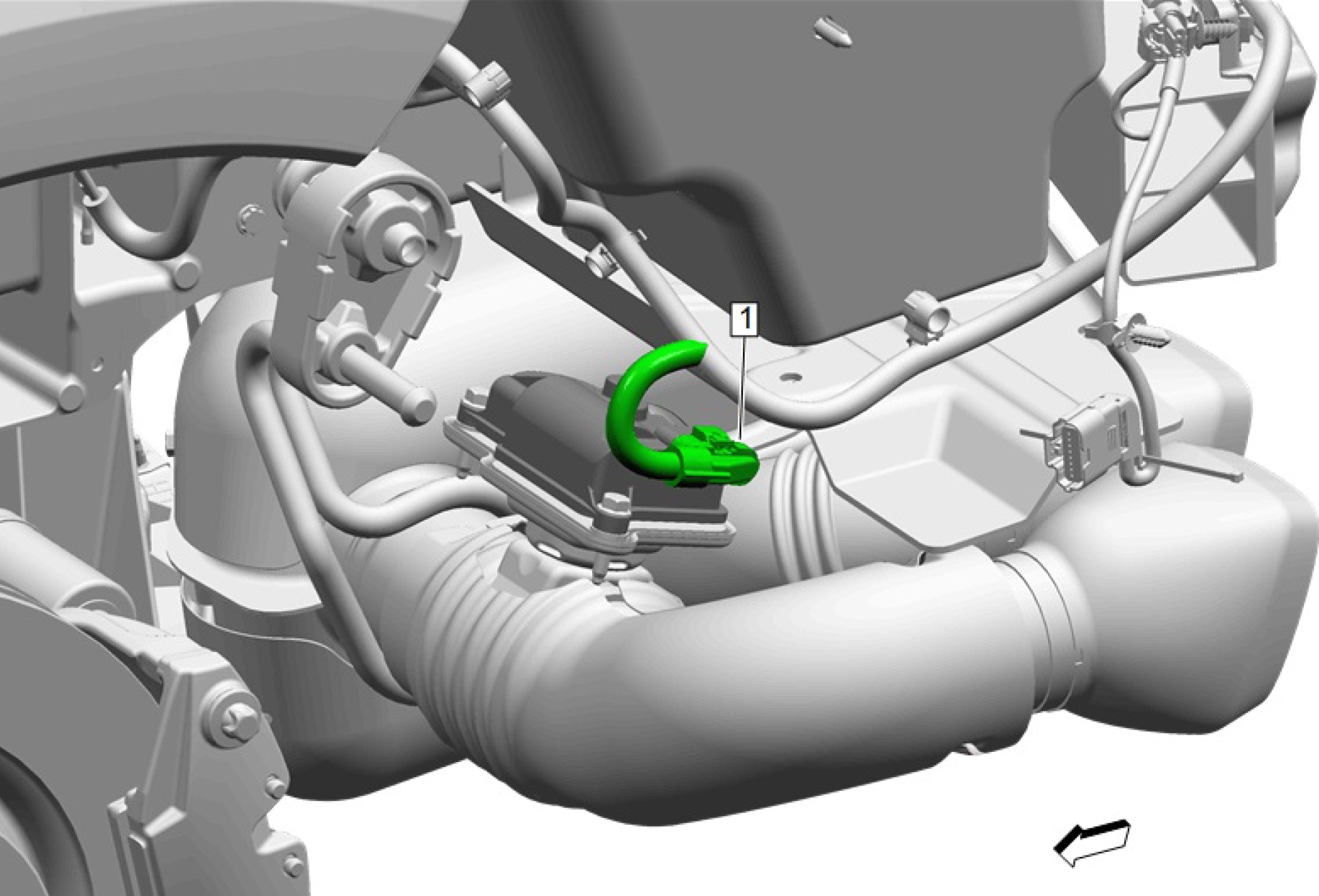

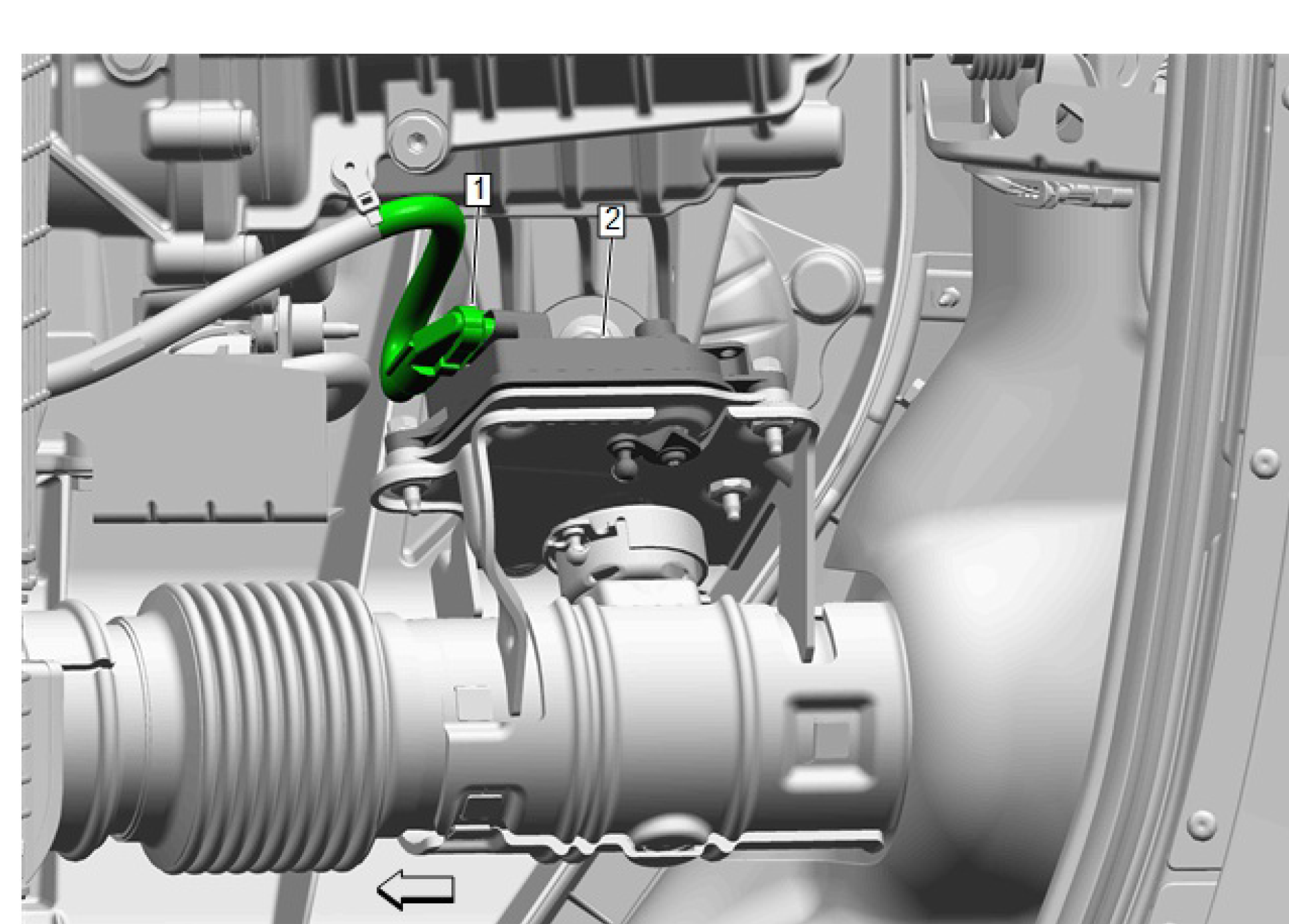

Yes. Check and reseat the connectors to the actuators. Check the integrity of the wiring harness and wires going into the the actuators. Check that the actuators are installed correctly and not loose. And, in the service manual there are procedures for circuit tests etc - get a copy of the manual and follow the procedures for the DTCs that are set.
With the car on the lift, in a shop, one could watch the motion of the tail pipe actuators to verify that they seem to at least work. Actually, you can (I can and have) watch the tail pipe actuators with the car on the ground, just by looking at them (post 30 at this thread
https://www.corvetteforum.com/forums...post1607148160

Thanks, I'll do that. One note, when I hit the Z button, I do get a louder tone, so something is working, but it sounds like not too well.
