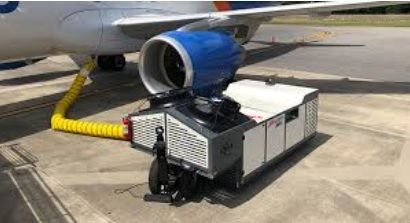

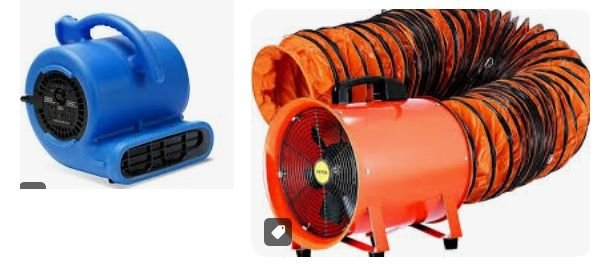

I would love a solution like this to cool the rear engine bay when I get home. I pop my Mustang's hood open when I get home.

But, how would you channel the air into the engine bay?

Stick it in the driver's side fender duct, that's where the engine bay cooling fan is located.
