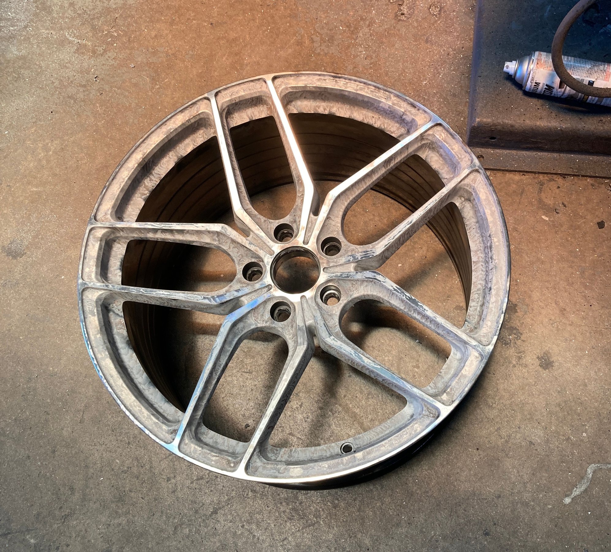

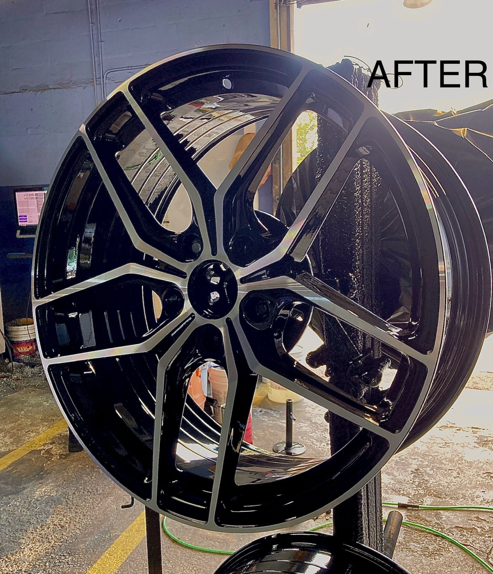

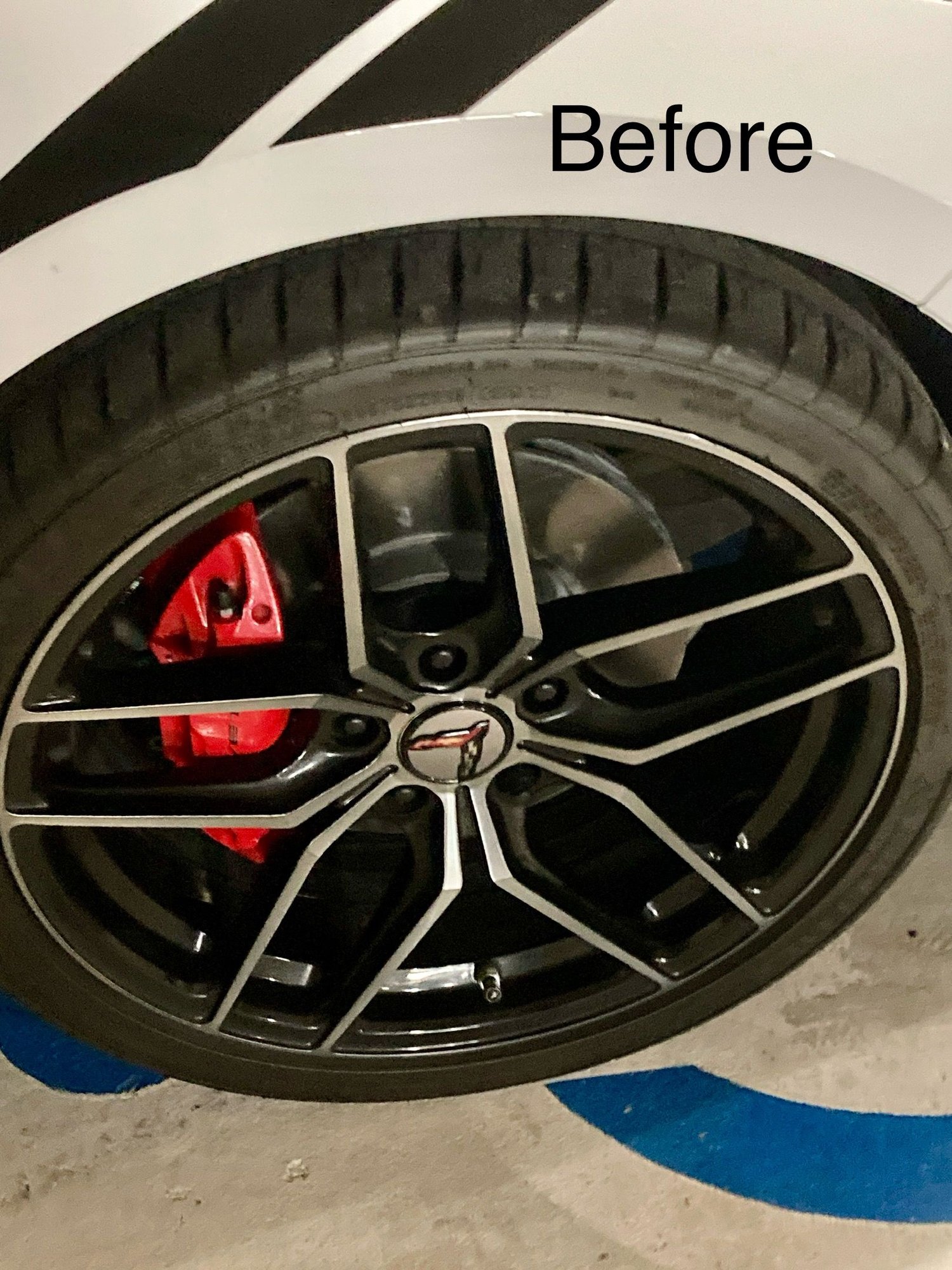

I just went through this whole process about 45 days ago, at wheel refinishing in Fort Lauderdale. I was able to go in and ask every question that’s been asked here and answered to my satisfaction. My wheels were stripped down to the bare metal, then totally powder coated in black, then put in a CNC machine and the machine face was diamond cut off then the whole wheel was coated again with powder coat clear. . They went through the heating process twice. In the same shop on the same day Lamborghini wheels were being done, a set of ZO6 wheels and a McLaren.
the wheel before with a black tint on the macine face, I wanted that removed
stripped
the finished wheel with the machine face now polished to a high gloss relection. cost of the whole process per wheel is about 200.

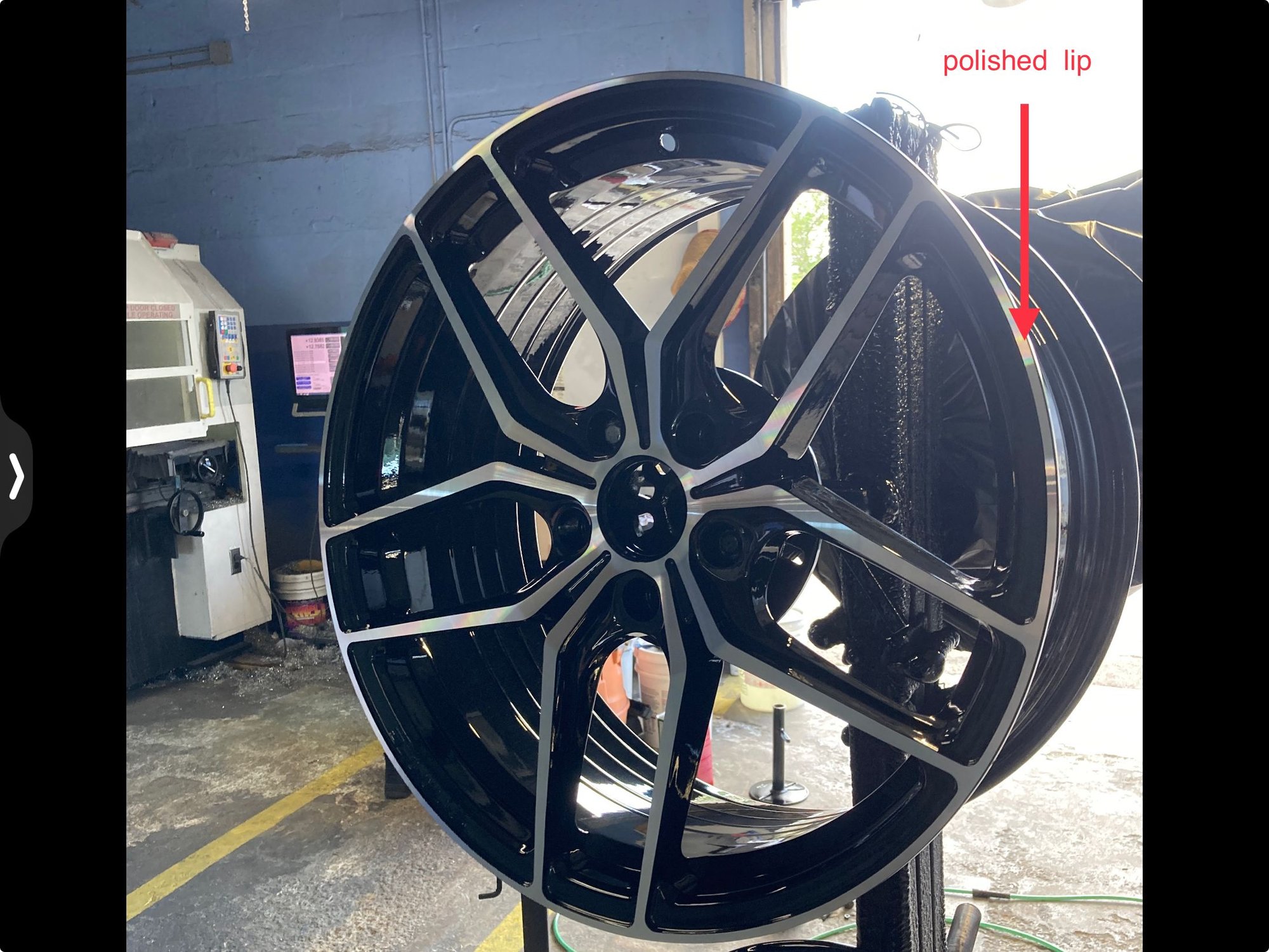

i also found the polished lip version from the factory visually was preferred. For some reason visually the polished lip looks better as the stock silver wheel in all black looks too inset in the fender where the black with polished lip pops more (IMO)

Wow, that is excellent insight. Thank you so much. I never thought of that and now I'm hesitant. I have not idea what "polished lip version" is, but I'll look it up. Thanks!
