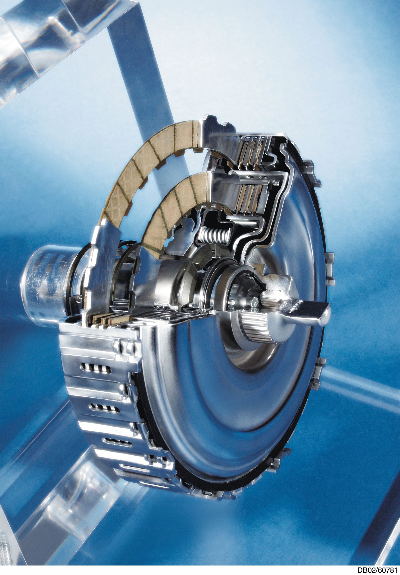

  • I had observed in the 1st ~1000 miles as I crawled into my garage at ~2 mph controlling my easy to see drivers mirror tip to wood door molding to about an inch (so passenger side easily cleared) it was a bit jerky. I attribute that to the multiplate 1st gear clutch wearing in as it was slipping. It has to slip below 4/5 mph OR the engine would stall. After >1000 miles it was smooth. IMO high spots on the multiplate clutch were removed. Good to get that stuff out. FLUSH helps that process.

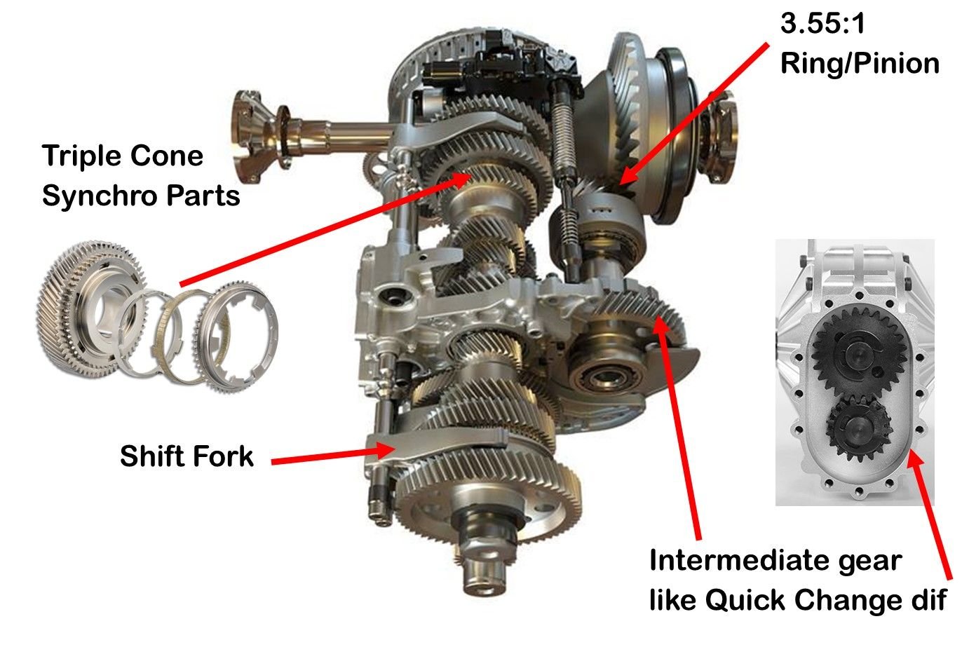

At year 3 with ~8000 miles I had a new DCT filter with FLUSH FIRST and as required all DCT Fluid replace. The DCT is NOT like an engine, where blowby, cold start caused water etc to go into the oil and create contamination. Once that initial wear is removed the filter should easily deal with minor ongoing wear. BUT if you want to change often your prerogative.
DCT is essentially Two 4 speed standard transmissions, little mechanical wear after the initial ~1000 miles.
The concentric multiplate clutch's do have some wear but Tadge said they should last the life of the car.
