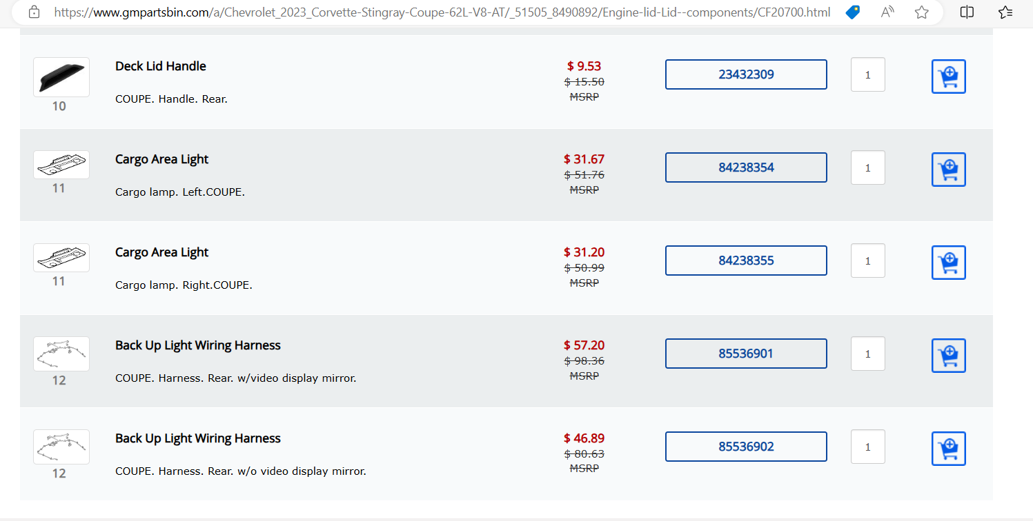

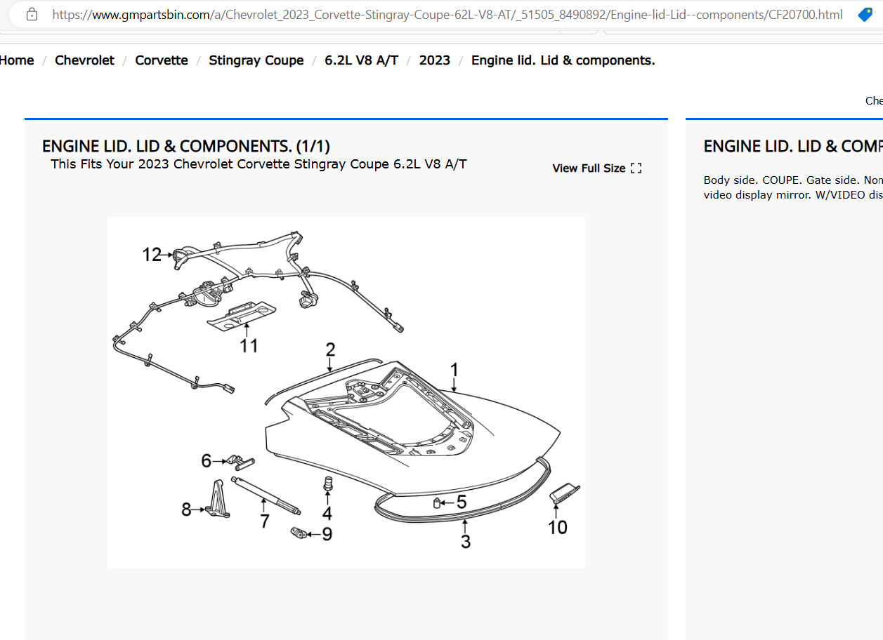

You guys know the correct part number for the harness?? The page here calls it a 'Backup Light Harness' although looks to be part of hatch.
