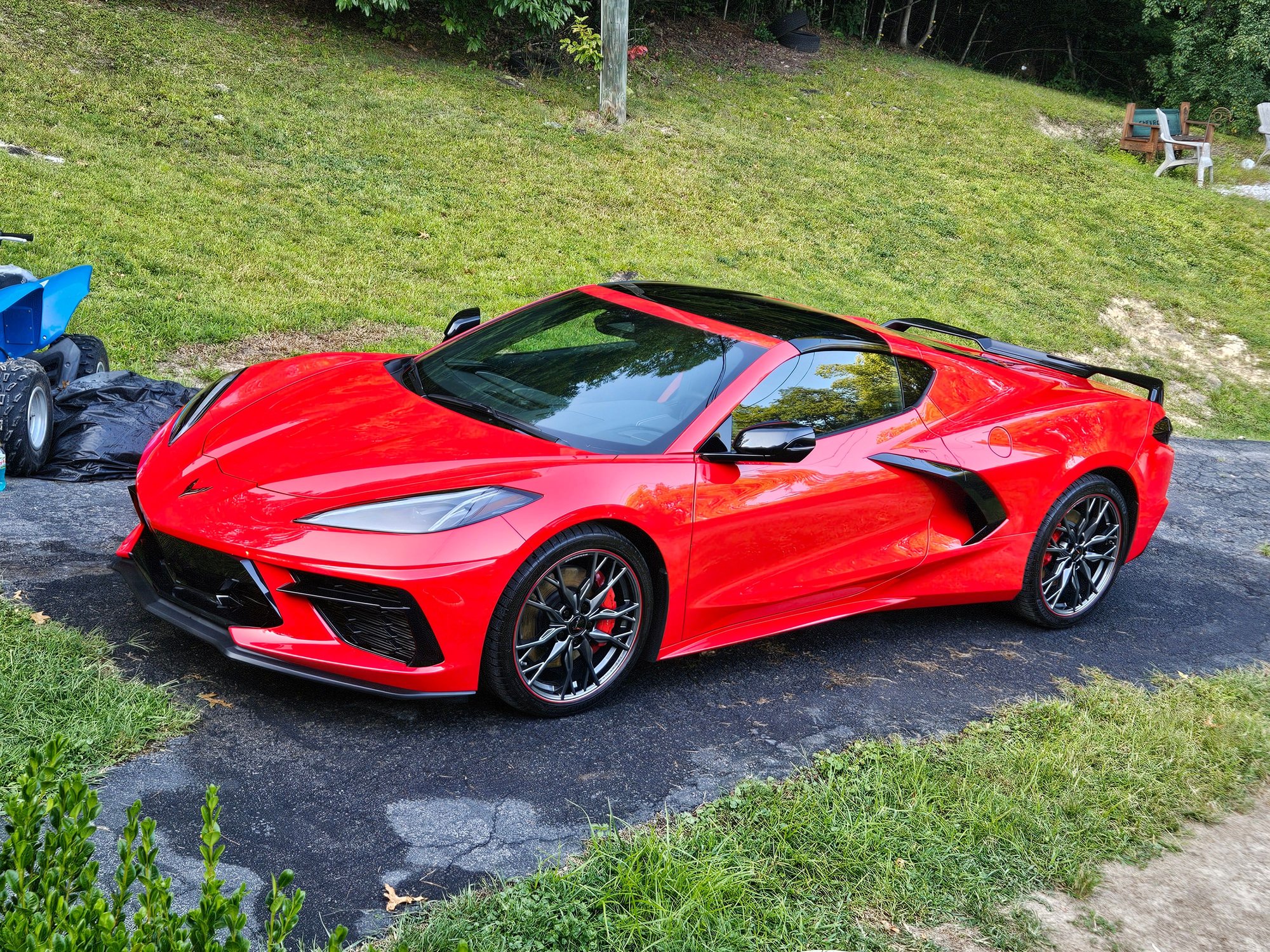

Are those rim savers or rimblades on the wheels?
To C8 Upgrade
