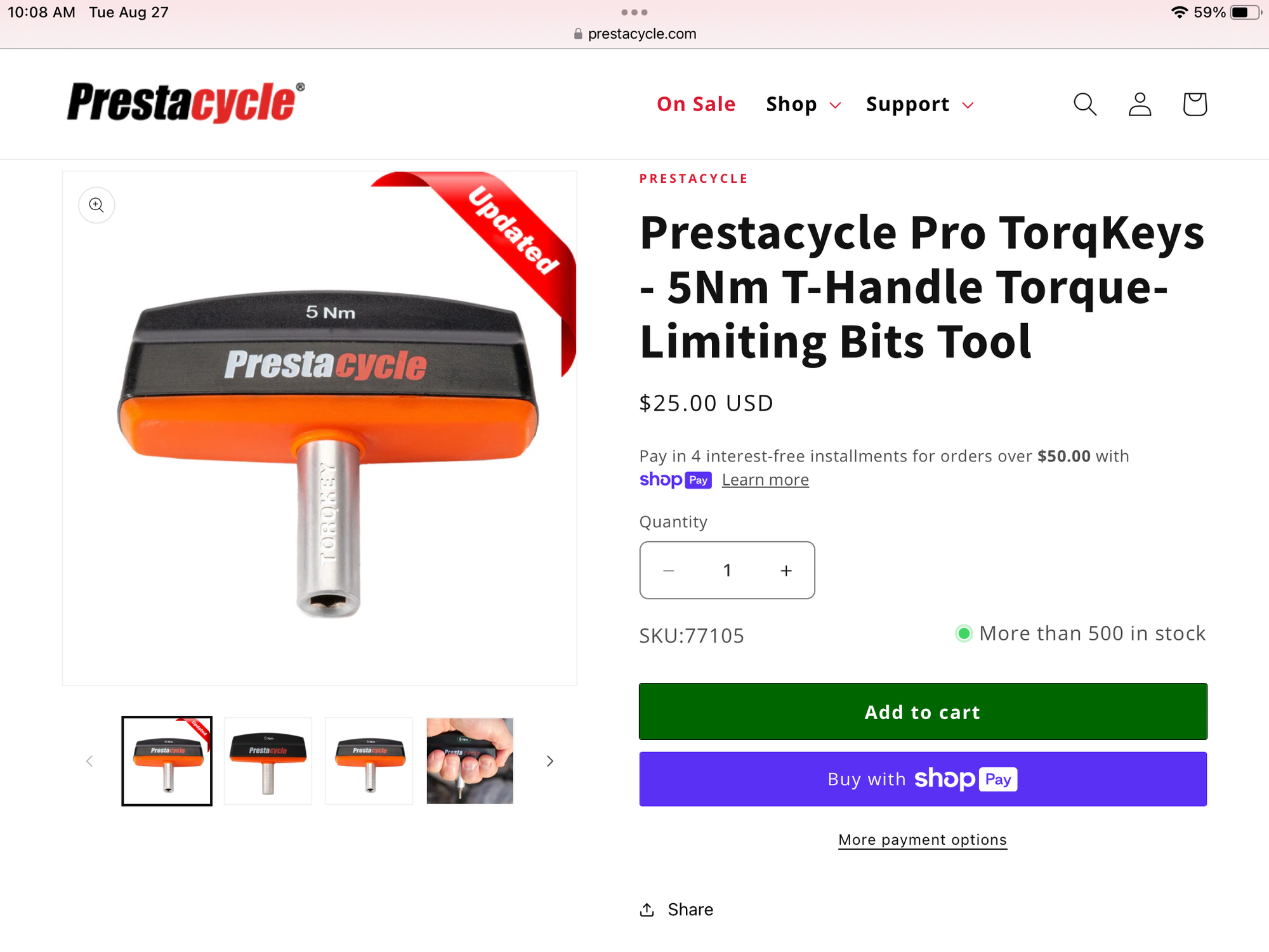

anyone purchase the proper thread chaser for dct filter bolts?? looks difficult to locate?
wonder is dealers have it - seen post of broken bolts
why would bolts be this soft? also bicycle torque wrench? lots of drama with this car thanks
