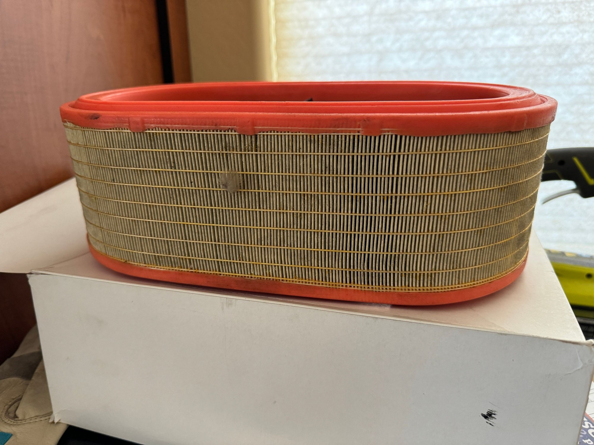

As others have said, get it to 7,000 miles before the service. Make sure they at least check the engine air cleaner, especially if you live in a dusty area. You can easily do it yourself but check it nonetheless. This is my filter at 3 years and 6,936 miles in AZ.
Manual says inspect, and replace if necessary.
