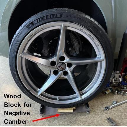

I made what I call a "Tire Slide" to remove the wheels (espeically the rear 13 rims) without risking breaking a CCB ceramic rotor. I used the foam rotor pads that came with the E-Ray . You'll note 8 inch long wheel stud extenders. The car is jacked just high enough to have ~1/4 inch clearance to the "Tire Slide." When the wheel is pulled off the lug extenders it safely drops on to the "Tire Slide."
To put the tire/wheel back just tilt it slightly with a small wood block. That allows the top rim hole to slip on the extender. When you push the wheel on, the bottom two lug extenders are then in place to push on!
Built the "Tire Slide" from some scrap 1/4 inch thick wood and $10 for 4 casters!

How I removed the 13-inch-wide, 21-inch rear E-Ray wheel:
Pic shows my home made "Tire Slide" (made from scrap 1/4-inch wood with 4 casters) so no lifting to remove or install wheel/tire! Note also use 8-inch lug extensions and the foam ceramic protective rotor pads supplied with E-Ray CCB brakes. Avoids of heavy 13-inch-wide rim hitting brittle ceramic rotors that can crack!
