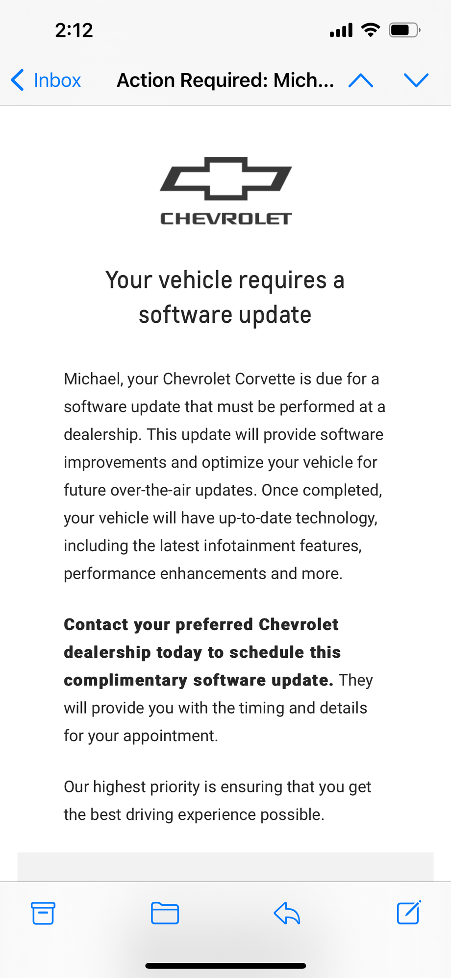

There is a active recall out about this exact issue, I just went to the dealership yesterday to get a software update to prevent this,,, (It took about 2 hours)
Old Oct 15, 2024 | 02:15 PM
NJMikeC8's Avatar
NJMikeC8
Posts: 621
Likes: 411
From: New Jersey
2023 C8 of the Year Finalist - Modified
Received the below email from Chevrolet on my 2023 coupe. Had Ciocca do the update (no charge).
The update took 90 minutes.
Yes, but that recall only pertains to 2023's. The OP said he has a 2021.
