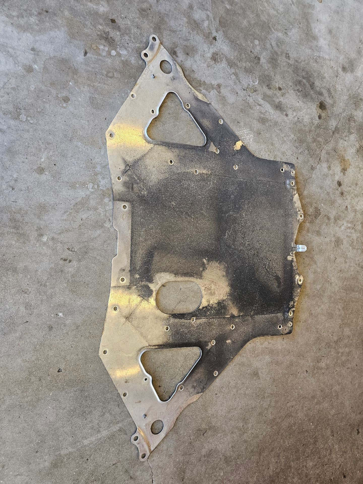

Well, went to an independent shop to get my 22,500 DCT filter service and as soon as they took the underbelly covering off it was clear there is a leak.
I had them finish the service but have already set an appointment with a dealer (not one I particularly like but best near me) to have it looked at.
Glad it’s under warranty and their problem but still a bummer. My exhaust has a squeaky valve as well. I am already on my second active exhaust. Might be a new trans and exhaust coming soon…
Hopefully not but only time will tell.

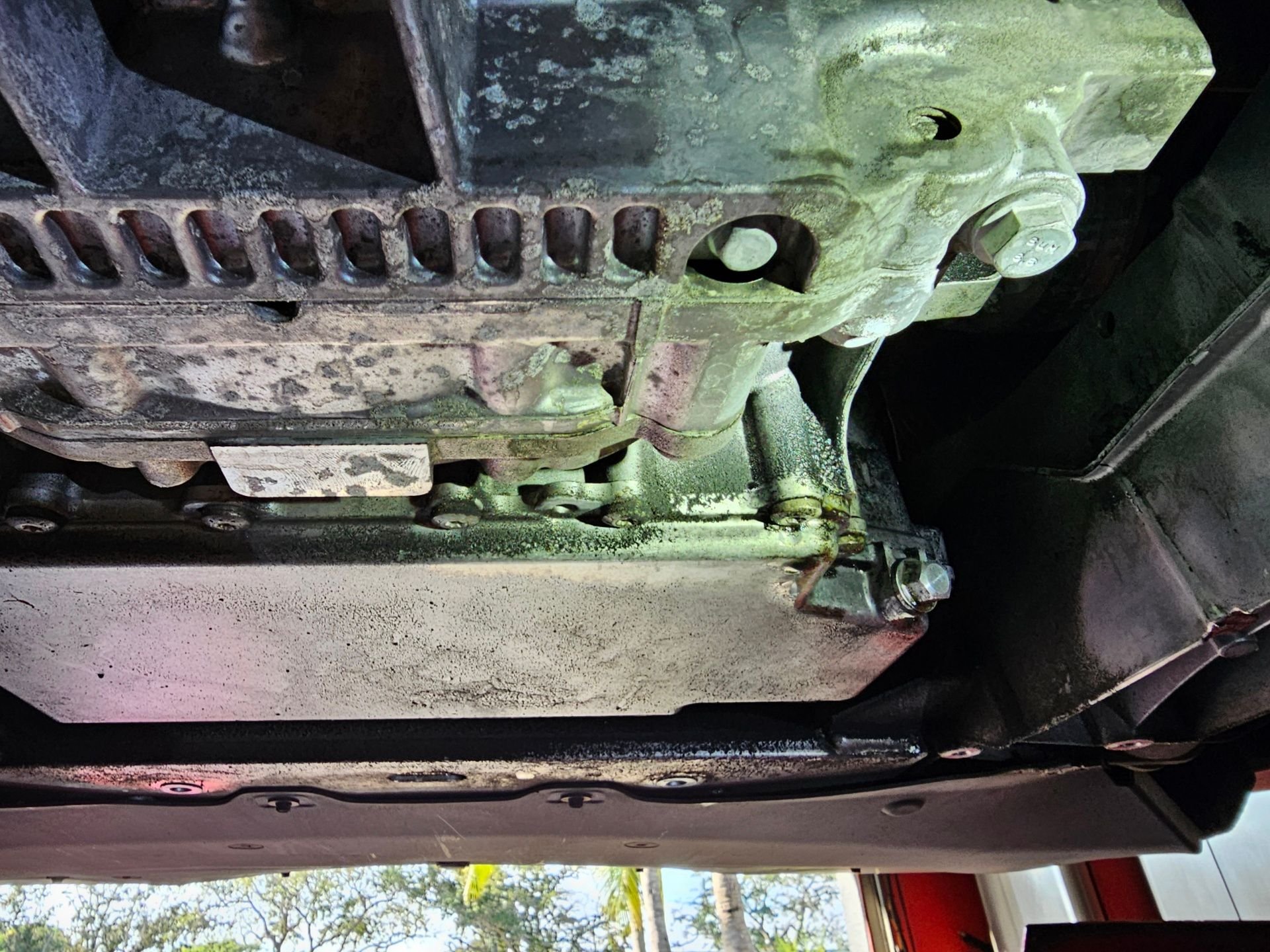

Looks like the drain bolt is leaking. Did someone change the fluid in the past?
Only the dealership until yesterday. Going back to the same dealership that did the last oil change. At first I thought the shop said the trans was leaking but called them and he did say it was in fact oil. Was in a hurry when I was picking it up, should of slowed down and asked a few more questions.

I’d leave that cover off get underneath there and power wash everything real good. I’d think twice about ripping a car apart for sloppy work in the past especially by modern day monkeys.
The shop I went to cleaned the underbody panel. I figure that will show fresh oil over the next 2 weeks while I wait to bring it in. The rest is left as is. Hopefully it is a drain plug and not cross threaded or over torqued. I checked the oil level today and it was bang on so can't be losing much.

Could also be case porosity.
not that bad.
That was my first thought. I am no wrench and wasn't there when they found the leak so will just have wait and see what they say from Chevy.
