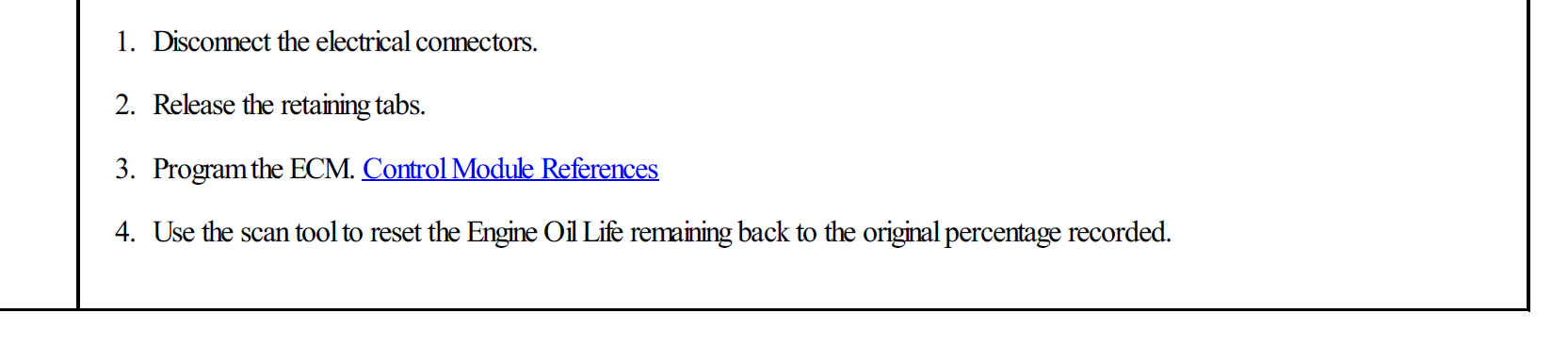

And there may be one other thing. I think the Oil Life System function resides in the ECM. I believe I have read, in the service manual, that when the ECM is replaced, the remaining oil life can be recorded, and then it can be re-entered in the new module. If I can find that later, I will post it. But probably that cannot be done with the Filter Life System - I am not sure - that is speculation.
Found it -
