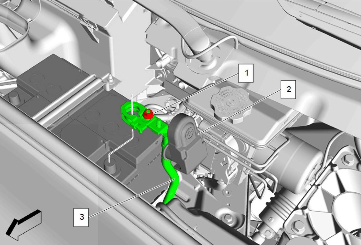

I did not want to take my panels off and take a picture, but here are some views of the battery in its native habitat. I think there is room. If I were going to get one though, I would pop the panels off and plan where its going.

That looks like one nut to remove for the battery hold down. I've read there's as many as two for the top brace/holdown and another one at the base of the battery.
Two. Here is the other one, like you said.
