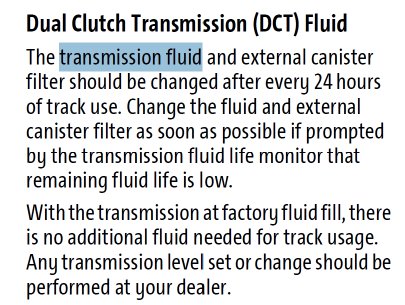

This really prompts more questions. Since the Z06 does not/ never did have the overfill requirement/ recommendation, why did yours have it and who put it in? I assume yours was used and a previous owner?
Originally Posted by Luke42_02
Great questions.
I talked to the engineer in charge of the transmission at the Bash in 2022. The way he presented it to me was that the case (all cases) have plenty of room for extra fluid and that the Z06 comes with two extra quarts from the factory. I can tell you that I pulled the fill bolt on this Z06 very briefly and carefully to see if I would be able to add fluid and fluid came rushing out at me. In the manual, it shows to fill it to the fill plug and then add two quarts via the plug on the top of the transmission under the air box.
I believe there is a leak test required in the manual. I was 100% sure there was no leak and did not perform the test. Probably a missed opportunity, sorry about that.
To Trans Filter change with flush.
