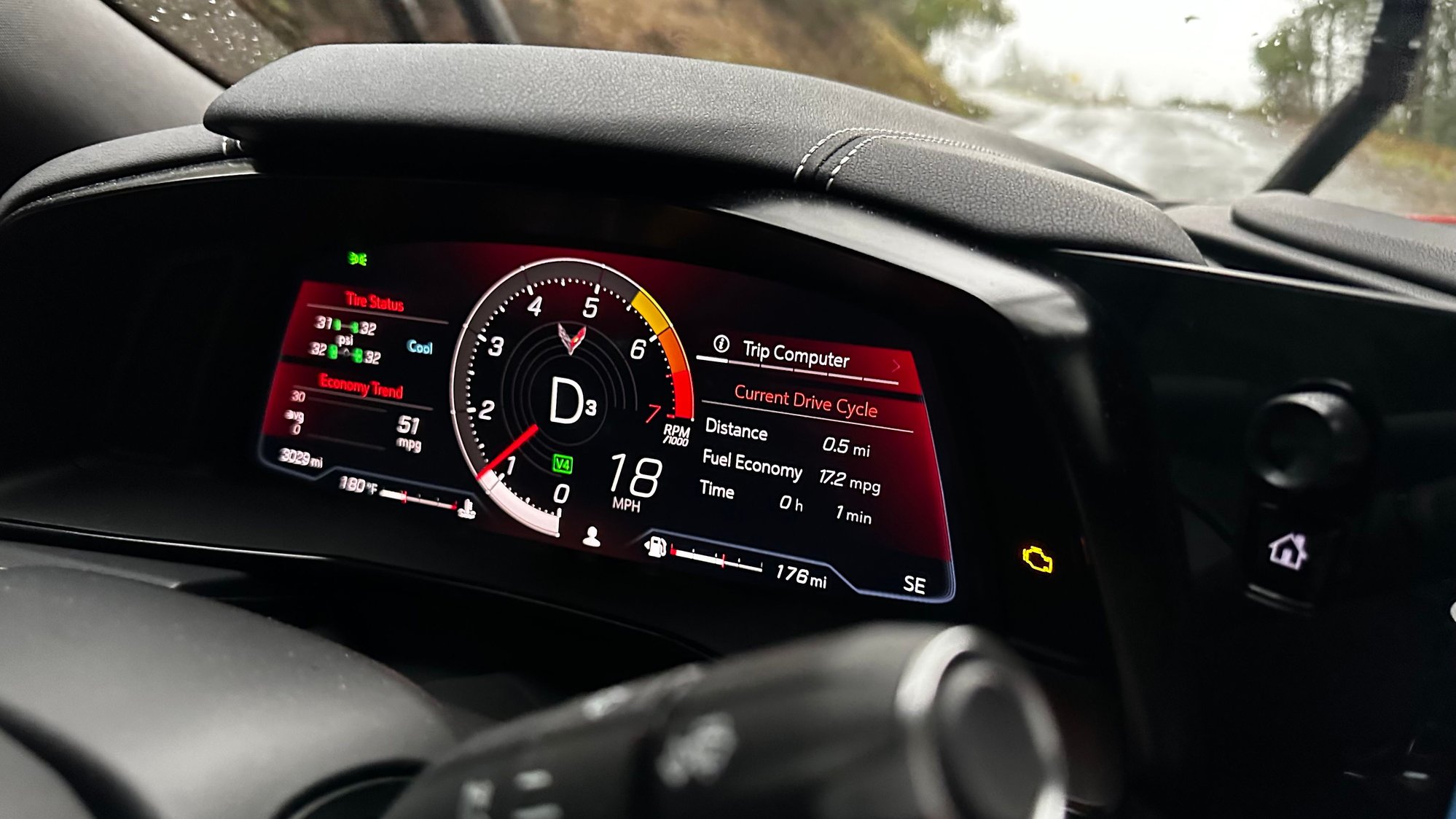

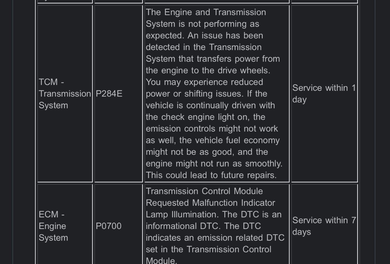

Codes P284E and P7000. Got the dreaded “idle creep temporarily disabled” message while driving the car normally. Car runs fine. Anyone with thoughts or input on the two codes? This Vette that replaced my lemon I bought from Fremont Chevrolet just 2 months ago threw these at 3000 miles. Fun times right? I think I’m about done with Corvette. 300 miles from home on New Years. TWO brand new corvettes. Two with faulty DCT issues. Brining the car into Fremont tomorrow. I am so done with this S$&t. It took 3 weeks for the buyback on the first one. Who knows what in the hell happens now? Yes I woke up with a darn anxiety attack this morning. Almost 180k worth of Corvettes in 2 months turning into lemons…. I just want the nightmare to end at this point. I already missed work and had to take PTO dragging this car down there, almost stranded my partner and I 300+ miles from home… the whole experience has just been abysmal. I wish to God they’d figure out these DCT issues. It’s going to kill the Corvette brand at this rate. I really hate saying that too. Loved my car.
Update 1: While sitting at In N Out eating on our roadtrip back home, I got back in the car and the CEL cleared itself and never came back. Still taking the car in tomorrow due to it being DCT related.
Update 2: Car is in service and they are inspecting it. CEL did not return and shifts were normal when driving. They are thinking it might be software related. Will keep you all updated when they know more.
Update 3: Car is trying to pass diagnostics. We are thinking it’s the transmission fork sensor itself that took a **** if it doesn’t clear and pass. Code was stored in history but we’re not seeing anything else aside from the P284E. If it’s just the sensor I’ll count myself lucky.
Update 4: CEL was caused by a failure of the Manual Shift Detent for gears 5-7. Service requires the transmission drained, cover panels to be removed, transmission mounts removed, and the part replaced.

When my '22 Z51 HTC had 300 miles on the odometer I got a CEL and "idle creep disabled message." DTC's 0700 and P2854 [solenoid]. Car ran fine and the CEL cleared itself later that day. I figured it was a fluke and did not take car to the dealer until I had my "first service" at 7,843 miles. Car drove fine at all times and the problem has not returned. Now have over 36,000 miles on the car and all systems go. Hopefully your situation is minor. Good luck.

I had one instance where the transmission skipped the even gears while slowing down at a red light. When I took the car out of manual mode and put it in drive, the transmission shifted normal. No DIC message or engine light ever came on. I hooked up a code reader and one of the transmission solenoids had set an internal code. I took my car to the dealer and after their diagnosis, it was determined that the valve body needed to be replaced. The point I'm trying to make is that even though a DIC message or check engine light goes away and the transmission appears to behave normally, don't think the transmission doesn't have a problem.
Update: The internal code was a P2856 - Clutch 'B' Pressure Charge Performance. Like I said, there was no DIC message or Check Engine Light. The only way I found it was with a code reader.

Seems like a few different things are causing the issues but mostly debris in the solenoids. Sometimes they clear themselves and sometimes the electronic flush clears it. 100% it's a big deal when it happens to you no matter how many people say it's random or seldom. Like many I also have it in the back of my head no only on trips but every time I drive my car.
