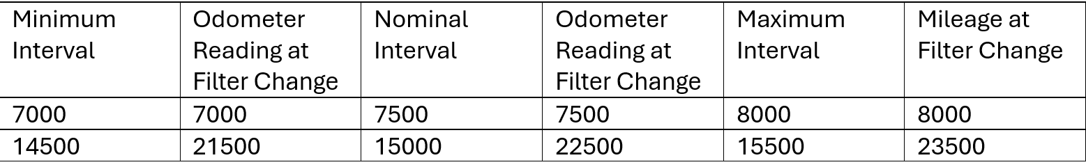

Default When do the Stars Align
Bottom line up front:
The miles per year where it is possible for the DCT filter and fluid replacement events to be coincident at the three year mark is between 7167 miles per year, and 7833 miles per year. Outside of that, with a lower miles per year the three year event will happen before the filter needs to be changed, and above 7833 miles per year, the filter will need to be changed before three years. This considers a +/-500 mile tolerance on the first and second filter change.
The nominal odometer readings for the filter changes are 7500, 22,500, then every 22,500 miles after. The first interval is 7500 miles, the second interval is 15000, all subsequent intervals are 22,500 miles. The tolerance on the first change interval is +/- 500 miles. I am going to assume that the tolerance on the second change is +/-500. For subsequent changes the tolerance on the interval is one side – less than 22,500 miles and not more.
The nominal intervals for fluid changes are at least every three years or at least every 45000 miles. I am going to assume that the tolerance is one sided – less than or equal to three years or 45000 miles and not more.
With these conditions and assumptions, what miles driven per year would result in the filter change and fluid change being aligned (or coincident)?
Certainly 7500 miles per year would result in perfect alignment. At year one the filter is changed. At year three, with 22,500 miles, the filter and fluid can be changed.
What about less or more miles per year? To figure that, the tolerances need to be considered (in my view). Compare three cases – the most frequent filter changes, nominal filter changes, and least frequent changes like this:
So, this table shows that if the filter is changed at 7000 miles and then 14500 miles later the mileage at the second filter change will be 21500. If the filter is changed at 8000 miles, and then 15500 miles later, the mileage will be 23500. To coincide with the three year event, the corresponding miles per year must be between 21500/3=7167 and 23500/3=7833.
So the miles per year window where its possible for the 2nd filter change to coincide with the three year event is 7167 to 7833. Pretty narrow. If the mileage exceeds that, the filter will need to be changed before the three year mark. In those cases, its acceptable to change the fluid too, if one wants to do that, so yes with higher mileage the filter and fluid can be changed at the same time, but will result in early changes of the fluid - sooner than three years. If the mileage is less than 7167, then the three year will be reached and the fluid must be changed before the filter change is required. Can the second filter change be early? Maybe. But the service intervals do not align.
The bolded is what I have been saying all along.
My real-world experience with my recently traded 2022, which had a tad below 30k miles on the odometer, aligned where it was prudent to change the filter and the fluid together. Yes, I had the fluid changed early, but the OLM was in the teens, so I thought it prudent to have the tech change them both.
As to your question, I preface my answer as an unofficial opinion based on the letter GM sent; it seems changing the filter is the more concerning part of this from GM's perspective. It is why the letter states, "If you had your transmission filter replaced prior to 7,500 miles, it still needs to be done again between 7,000-8,000 miles.
It seems that some folks are trying to avoid having to pay to have the fluid and the filter changed simultaneously. I get not changing the fluid unnecessarily, but I let the OLM dictate when I need to make a change, and the mileage GM set is my cue to change the filter. If I hit the mileage for the filter and I am close (30% or less) on the fluid, I will have the tech change both. YMMV.
Thanks! At first, I did not know what question I had asked - but I see it was what I intended to be rhetorical. " I said "can the filter be changed early" Maybe." But the context was the 2nd filter change, not the first one (or the first required one anyway). The first required one must be between 7000-8000 miles. The question was meant to be with respect to the second filter change at 22,500 miles. If it was changed at 7,500 miles, and again at, say 15000 miles, is it ok to go a full 22,500 miles before the third change? We know that when the filter is changed at 7,500, the next change is a mere 15000 miles later, whereas all the later ones are 22,5000 miles. It has been suggested, by me and others, and purely speculation, that the second interval is still short because there is still some extra break-in debris being shed between 7,500 and 22,500 miles. If that is true, then changing it sooner, say at 15000 instead of 22,500 miles and going a full 22,500 miles for the third change might be a problem, if there was additional debris still being generated. So, the "maybe" is because I do not know. And, since I don't know...........
My own plan is to make sure I change it near 22,500 miles, so I don't have to give it further thought. I have already changed the fluid, but still dont quite have the minimum 7000 miles for the filter. But I will change it between 7000 and 8000 miles, the again near 22,500 miles, making sure its no more than 15000 miles (give or take a little) from the previous change. The next one, and everyone after that will be 22,500 miles or less from previous one.
