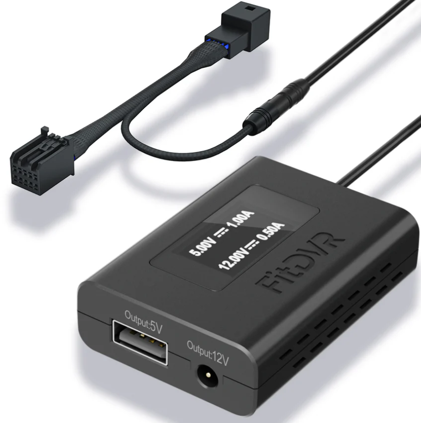

I added a Uniden R4. Originally I ran the wire from the socket under the glove box. Then I found this.
https://fitdvr.com/collections/chevr...adillac-d3-019
you can get it on Amazon, also added a USB port, which is nice.
I had a Fitcam on my last car and it was great.

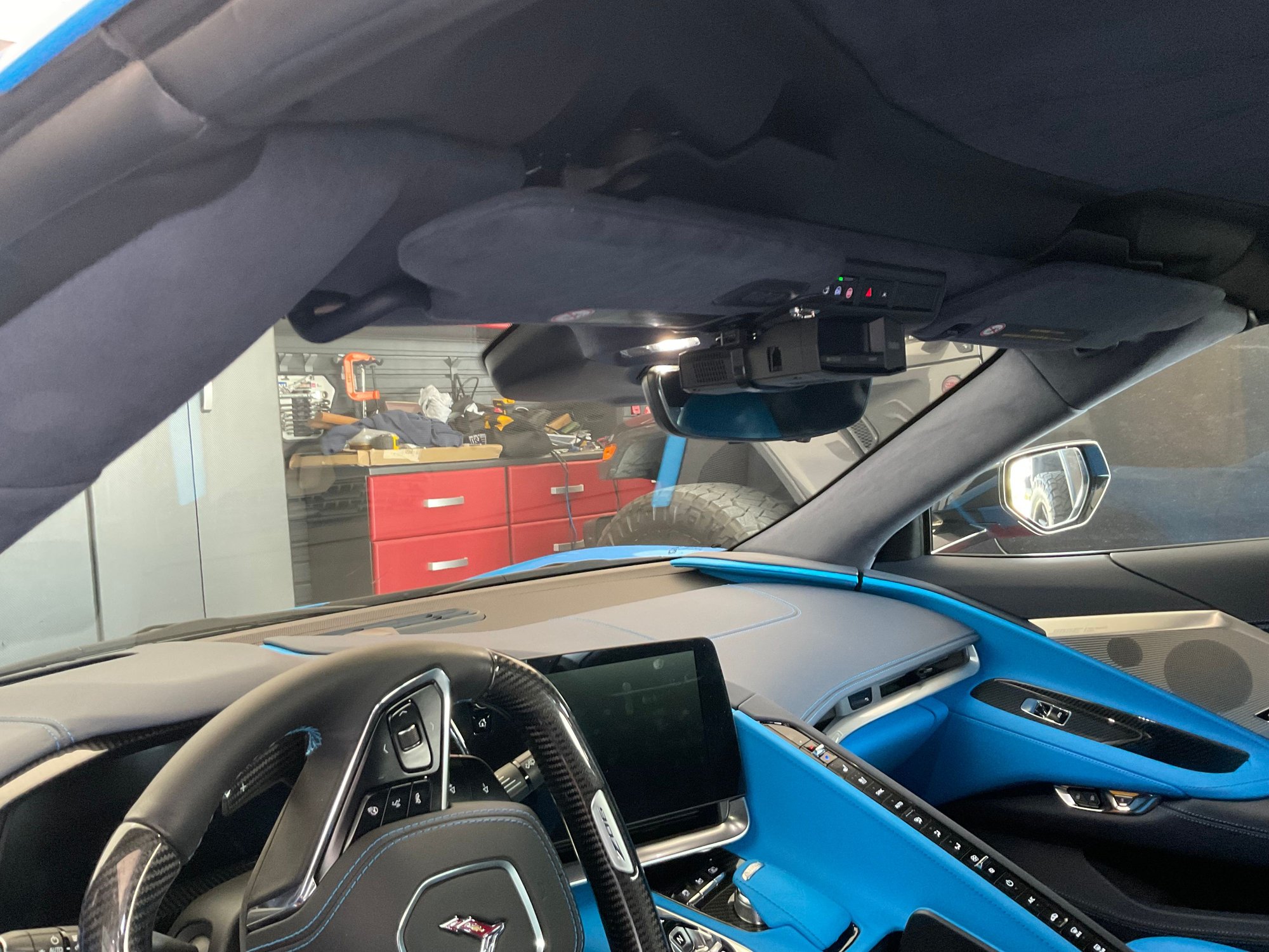

Installed an R8 and already saved me some heartache.

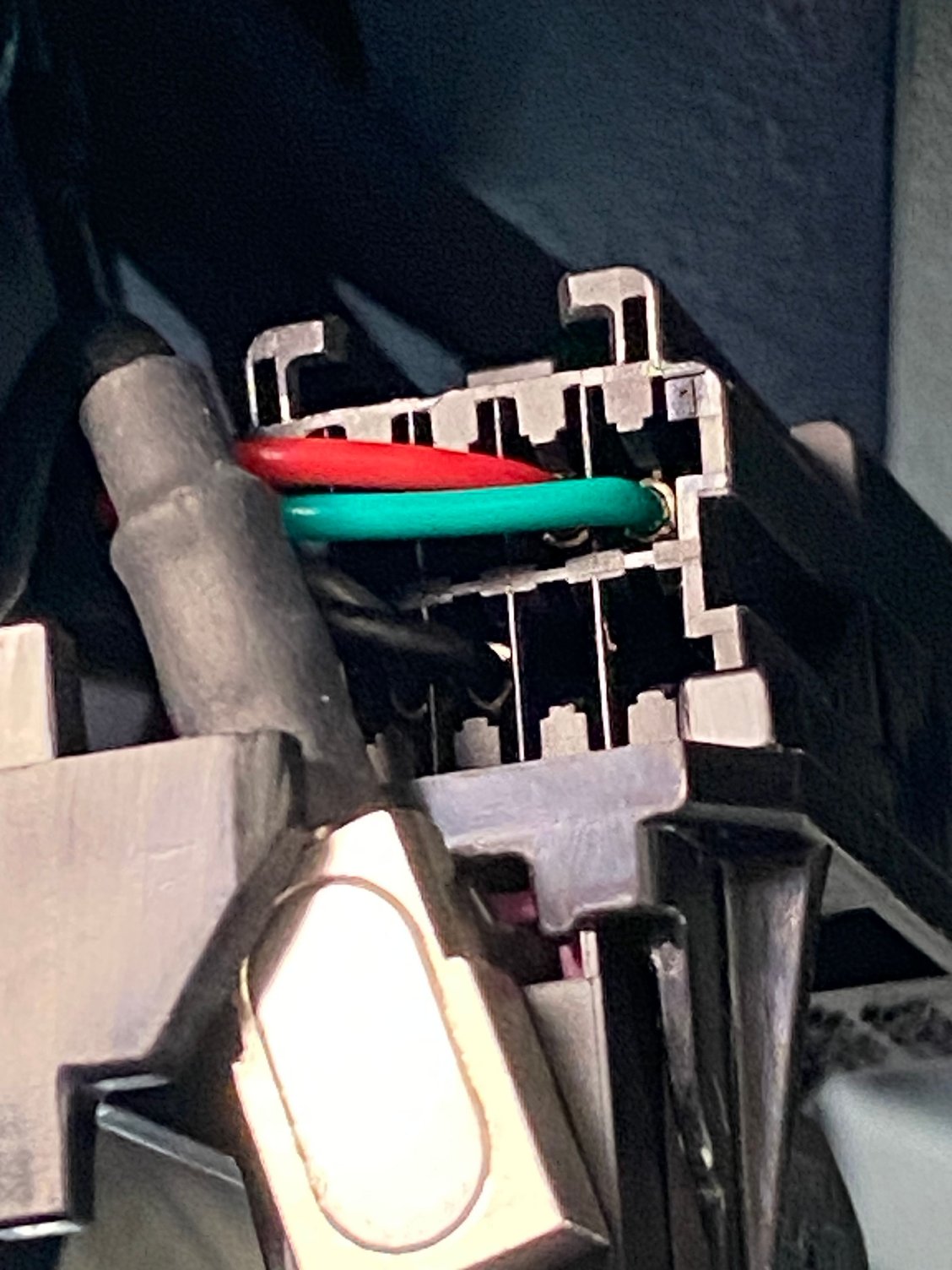

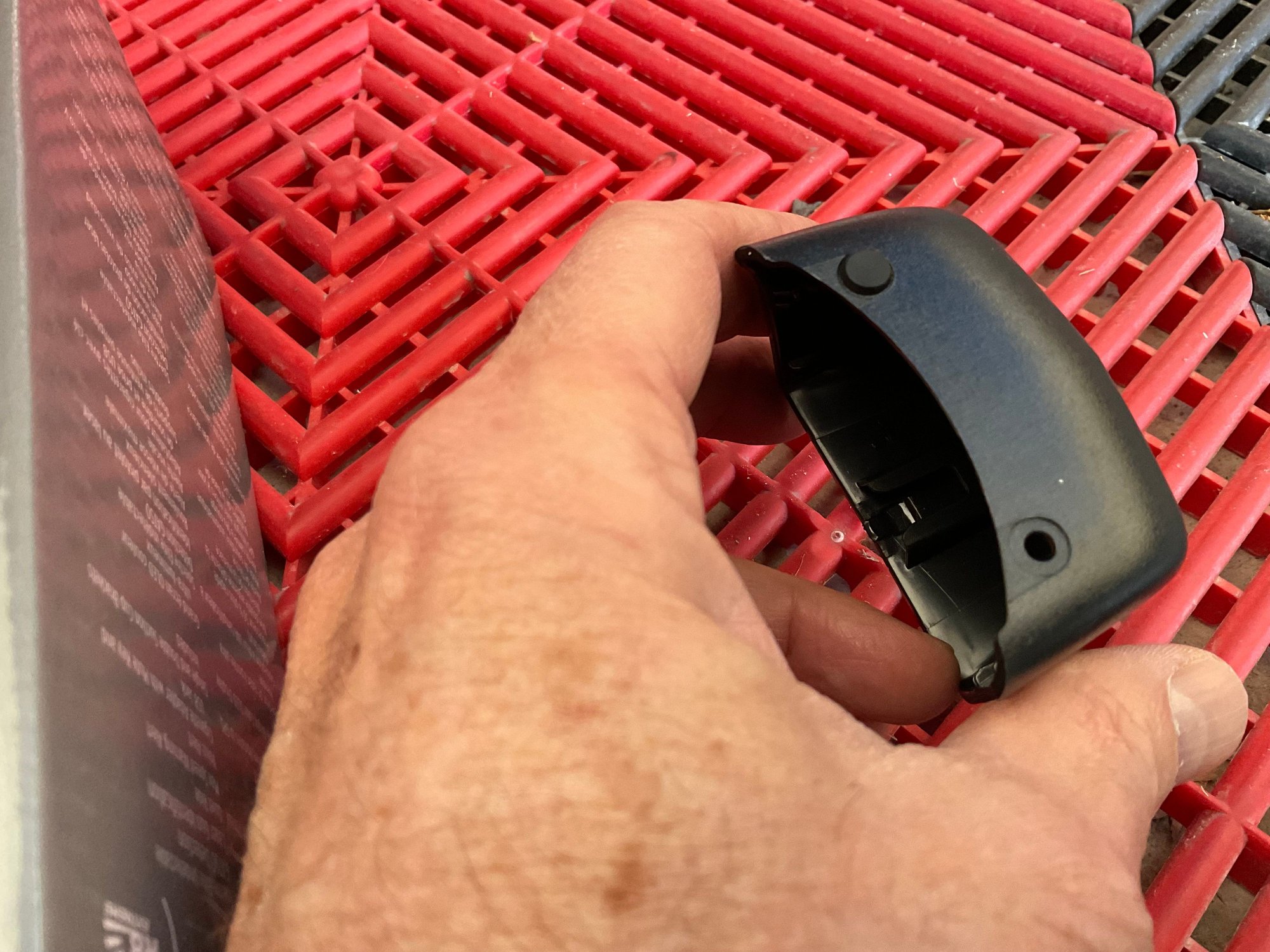

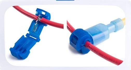

I used the mirror tap from Amazon. Once I popped the cover off of the mirror, there are two options. Either pull one of the rubber bumpers out and run the wires through the hole (what I started to do) or simply run the wires out the top of the cover (there is plenty of room on my 2025).
With the cover removed, the wire tap is east. Red to red on the top row and black to black middle of the bottom row.
With the cover removed, the wire tap is easy. Red to red on the top row and black to black middle of the bottom row.
I bought a visor clip made to hold your sunglasses off Amazon for Les than $10 and used a wire tie to hold my R8 in place. It is solid and works great with zero visibility issues.
I bought a visor clip made to hold your sunglasses off Amazon for less than $10 and used a wire tie to hold my R8 in place. It is solid and works great with zero visibility issues.

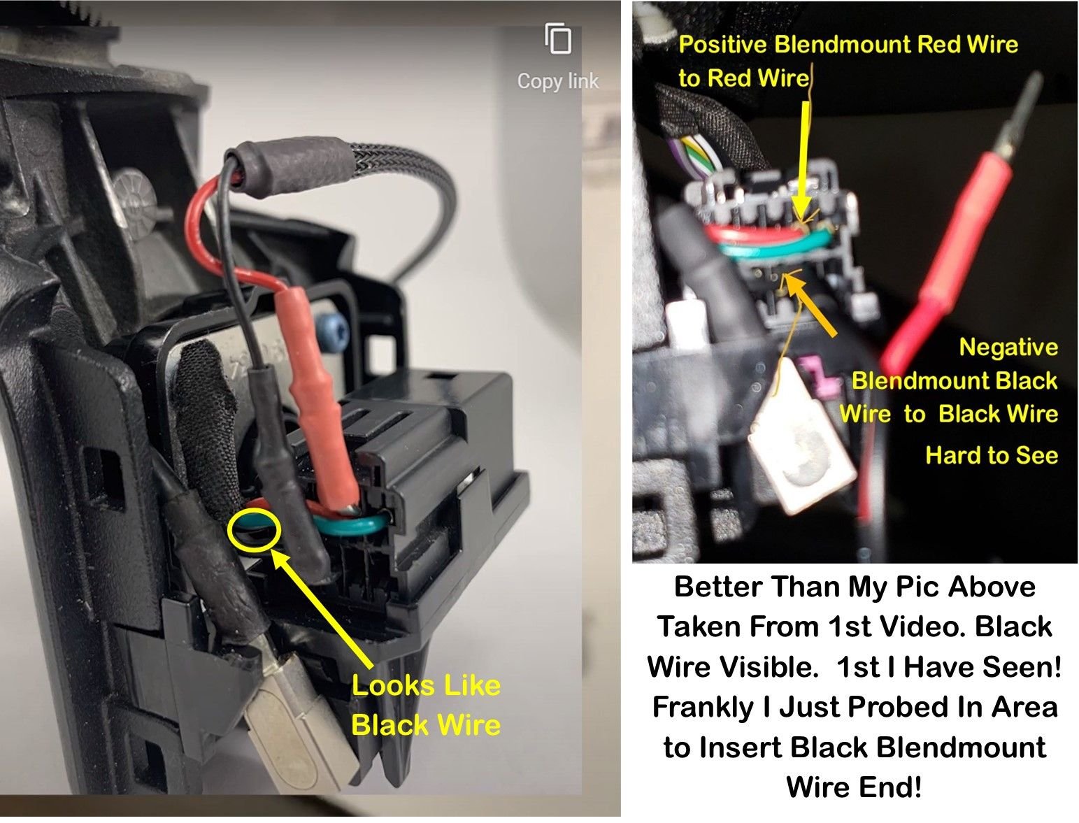

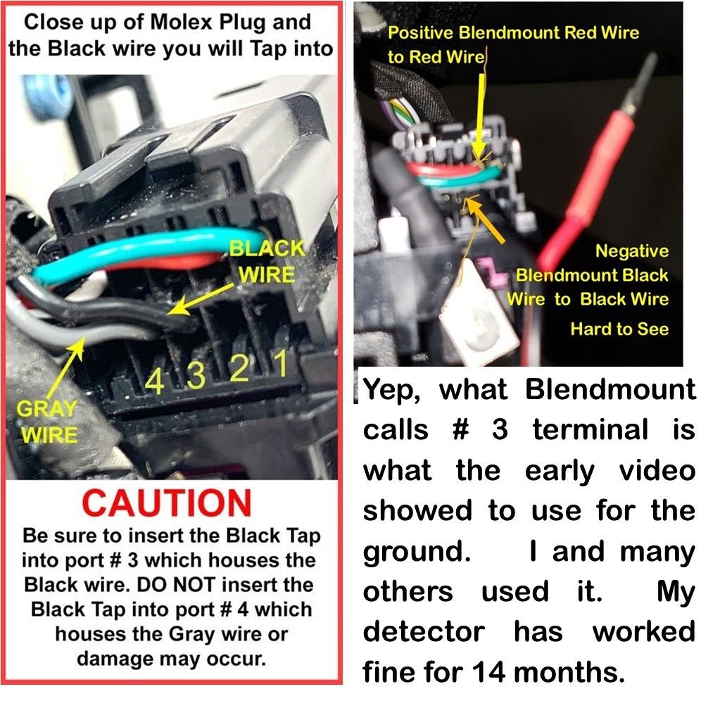

FWIW. Best Pic of the Plug Back I have seen!
I installed similar on my 2020 C8 from a Video made 6 months BEFORE Bendmount had their mount or instructions of installing. GM initially said, "mirror power can't be taped" (but the said that for the C7 as well.)
Left is the Pic from Blendmount who called GM who had issued a Bulletin for dealers saying that taping the mirror could cause driver door mirror to fail! They were warned IF that happened it was NOT covered on Warranty.
CAUTION to those installing: YOU WILL NOT see that plug and wires that clearly when you are installing!
Pic right is from an early video someone made, which is all I had. My words placed on video clip.

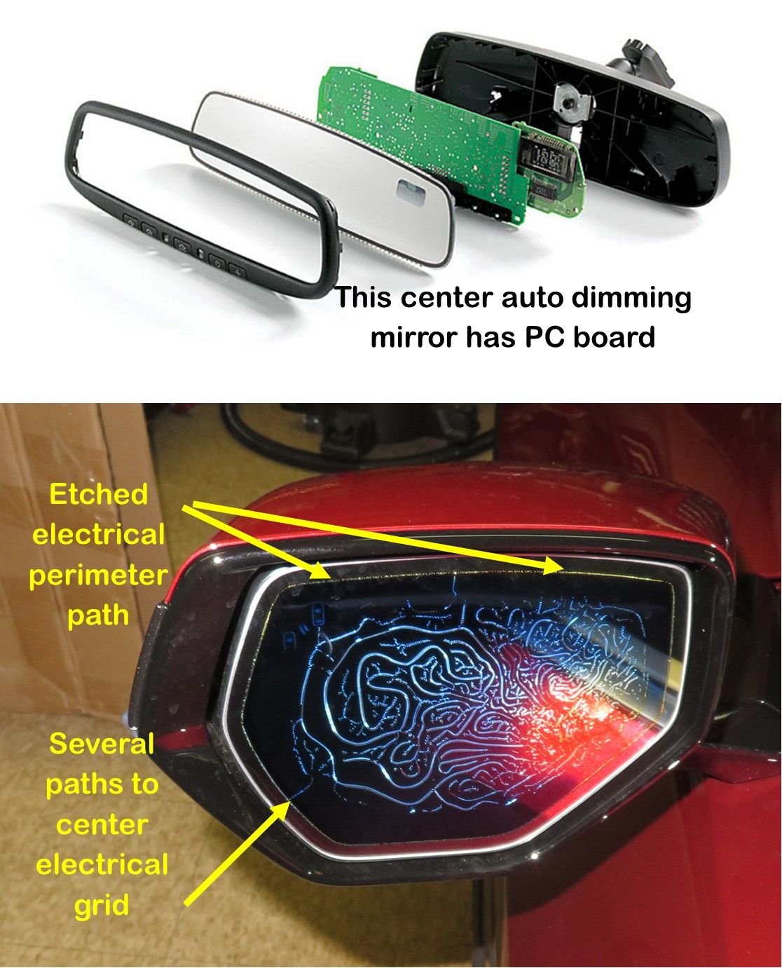

Next to the "hard to see black wire is a Gray wire." Both hard to see. IF the mirror tap is inadvertently inserted in the Gray Wire the result in pic below. Not covered in warranty!
If the Gray wire is made ground instead of black it will cause the auto dimming driver's door mirror to fail. GM Bulletin to dealers warns NOT COVERED ON WARRANTY

Thanks, @JerryU , I used your site for guidance which was very helpful!
I got lucky on the picture. I took a bunch trying to ensure I didn’t hit the deadly “gray wire” with the ground. I didn’t like the Blendmount and the C8 mirror is very different from my C7. The visor clip mount works perfectly with zero obstruction, plus in total I spent less than $25 on the mirror tap and visor clip from Amazon.
Great Pic, not easy. I tried. I had a small light weight detector for my 1988 and 1993 Vette. I used a clip on the passenger Sun Visor. I powered both from the Sun Visor Mirror light! It was not powered when car was off.
For my 2008 C6 I tapped the mirror and recall it was easy as I used a small wire tap (see Pic.)

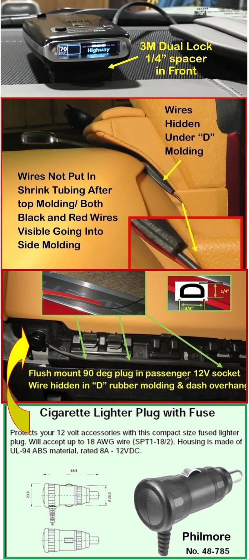

I did as well but when I bought the latest and greatest from ESCORT for my 2014 C7 Z51 did not realize it was very large and no visor clip. Really too heavy for a visor.
So for my two C7's taped the mirror for power and used ECORT large suction cup "Sticky Mount." Worked great, never fell when driving. But IF parked facing the Sun on a HOT day, the air in the cup heated and it fell. So made a tether I used on the two C7s I had for ~8 years and for 3 years on my C8 (Pic from C8.) Then when my TV Mirror failed, actually the camera failed, and dealer first ordered a new mirror so had to remove the rdar power tap. I installed the Radar Detector on the dash. Like location better. Had that for a year and transferred it to my E-Ray where it has been for 13 months. IF I park in a "bad area," seldom in my case, easy to remove with only a wire showing at the windshield.
Install for 3 years on 2020 C8 with mirror power tap. Used a Stainless Fishing Leader as a Tether so when parked facing the Sun on a Hot Day IF the air in the suction cup heated and the detector with "Sticky Mount Fell" it did not hit the Dash! Would happen 4 or 5 times a summer.
Switched for 1 year on the C8 to this dash mount. Power from 12-volt receptacle under passenger dash. Used a flush mount right angle plug that fits flush. The wire is in D shaped rubber molding that has 3M adhesive on flat side. Wires hidden util they appear at windshield,

I still think this is by far the best, easiest and most useful approach:
