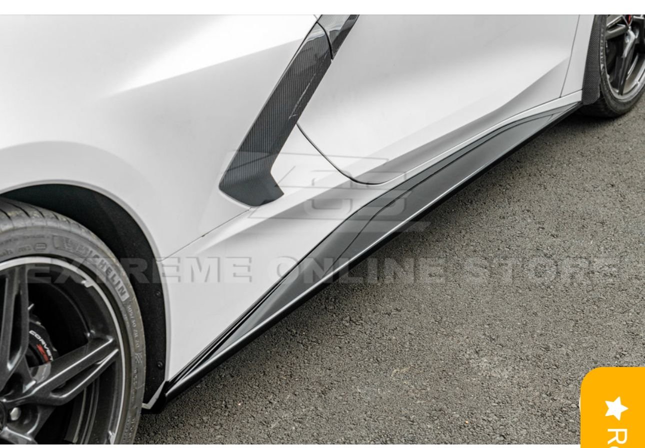

Default Help installing EOS performance Side Skirts

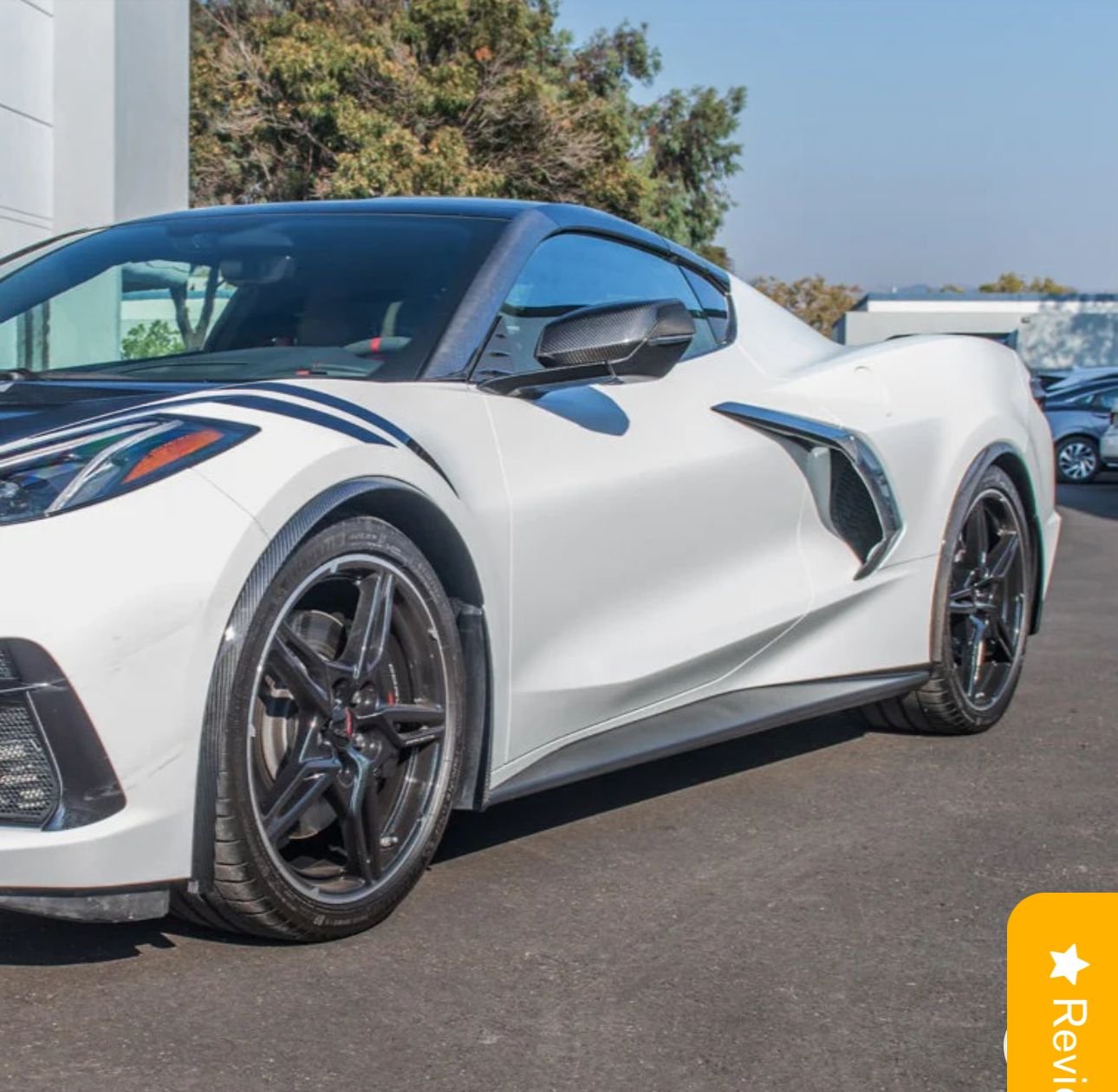

has anyone installed the performance side skirts on a c8 , need some installation guidance since those didn't come with one , same ones in pic below

I installed these on my 23. I had the same issue, so I decided to try it with the help of a friend. I don't remember if I started at the front, or the rear, but I really had to push on the side edge to get it to mate with the body. Heating it seemed to help so it wasn't so stiff. I put the two sided tape on the skirt, pealed a bit back to start and then slid it over the body. While holding it in place, my helper drilled a hole and put a rivet at the end. Then slowly and carefull worked my way to the other end, one rivet at a time. After it was in place, i tried to peal the tape from under the skirt. If it pinched and tore, i used an exacto knife and carefully trimmed the tape away. As I recall, they were a bear to fit to the body as they seemed too tight to form to the body. But woth patience, it turned out nice.

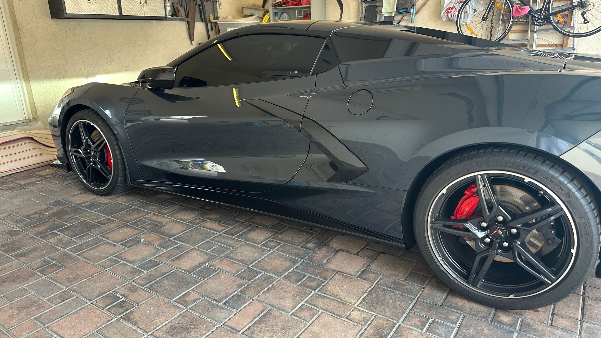

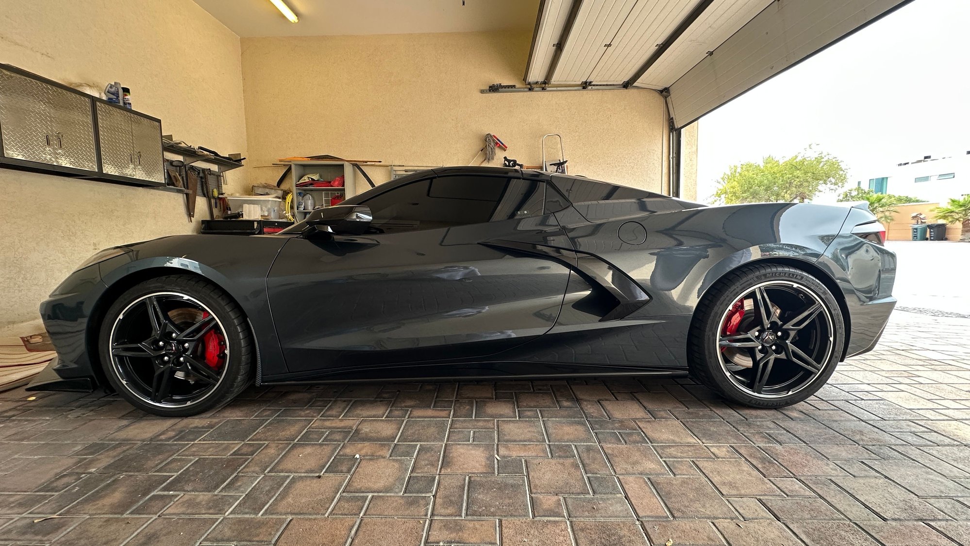

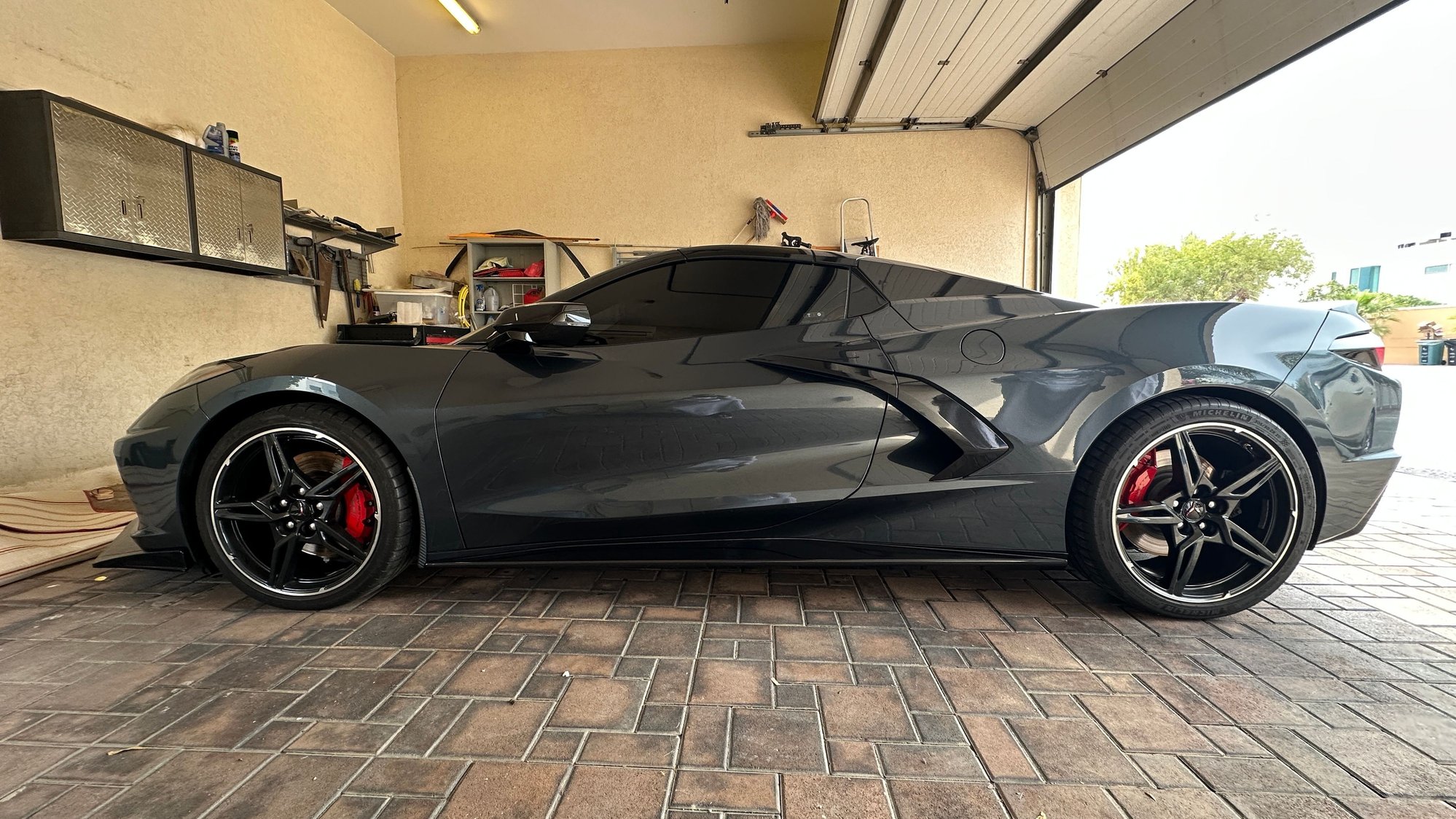

great , i took a chance today at noon and put them together friver side as mentioned rear one was tuff not gone all the way overlap the edge however it looks ok with help og double sided tape and extra screws it went fine , the passenger side was 2 minutes job easy smooth when great ,
