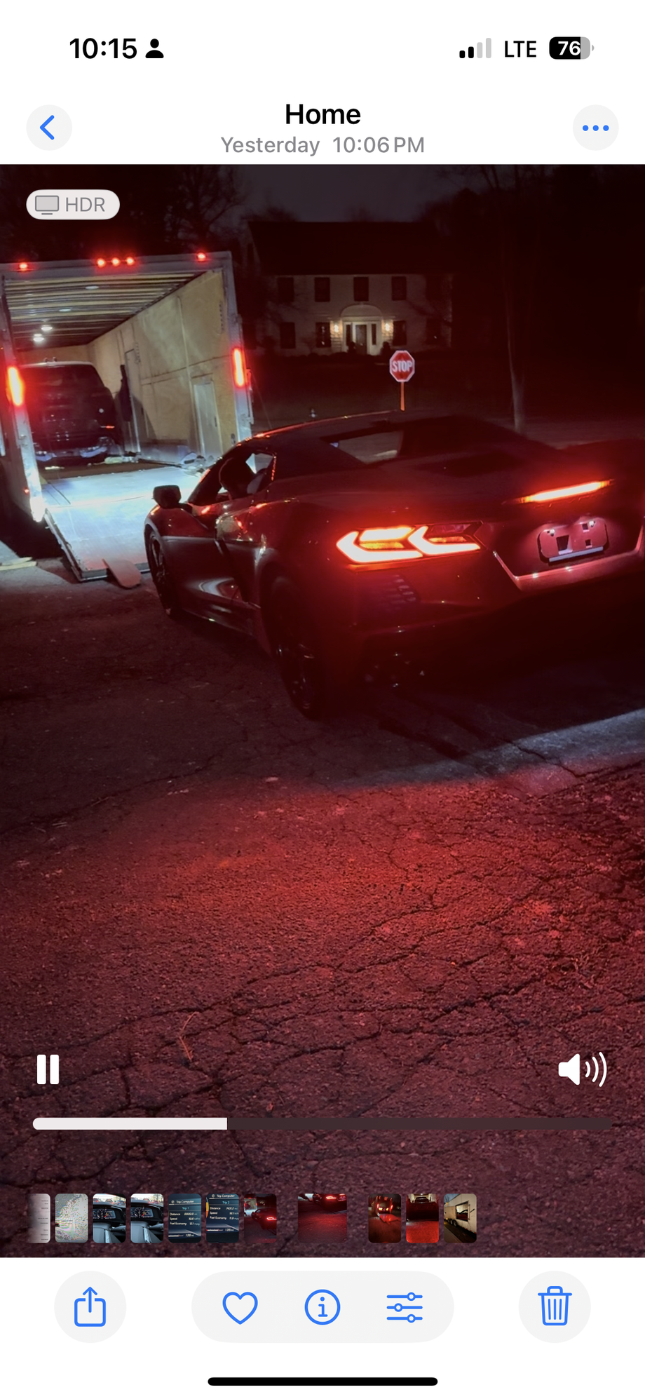

Default Problem solved
Saying goodbye wasn’t so difficult. On its way to Porsche dealer down south.  Mixed feelings many many compliments and there’s nothing like the acceleration and htc experience.  But the multiple failures I had, tarnished the experience
