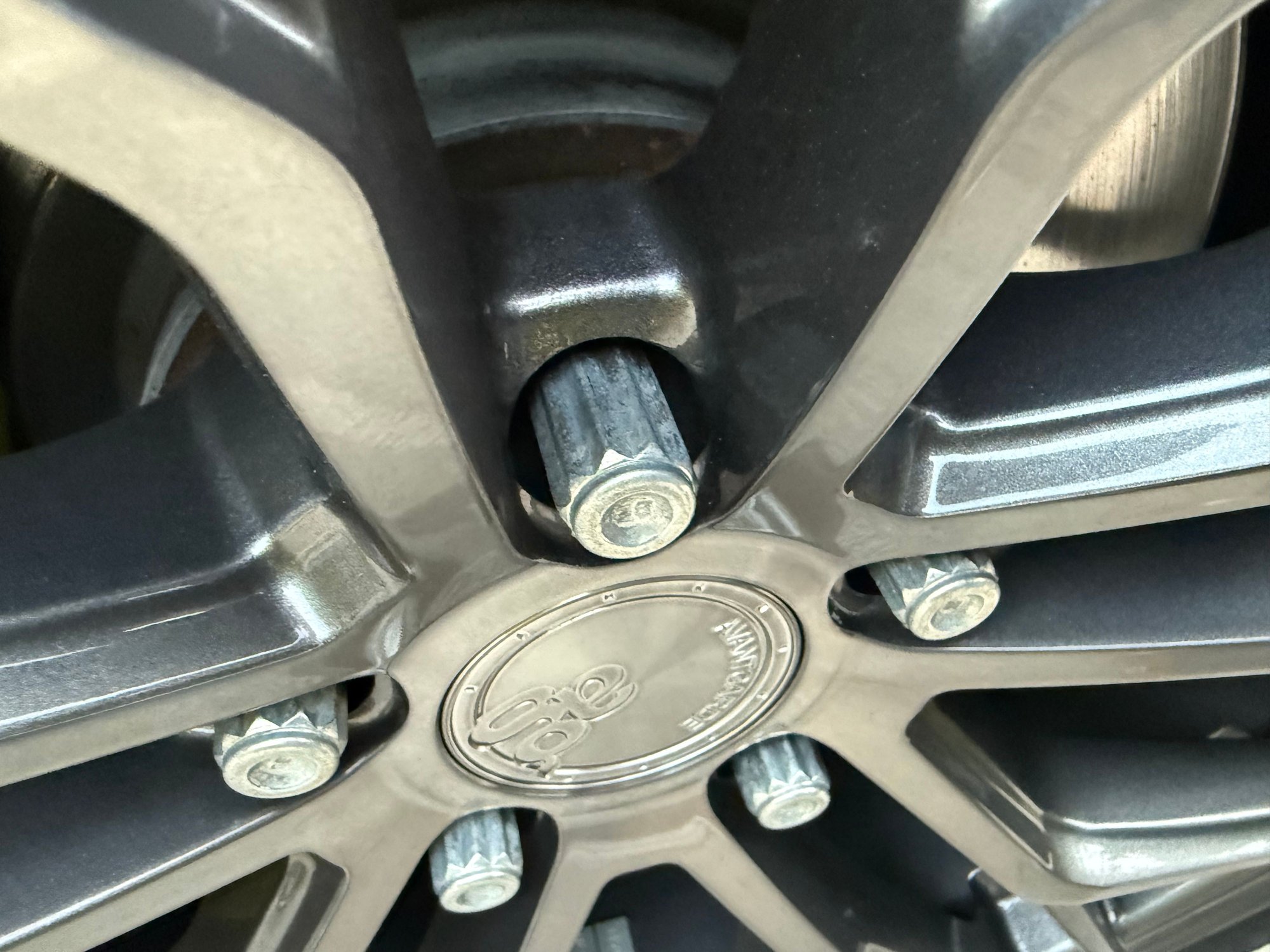

Hello,
just picked up a new to me C8. It has spline lug nuts but no socket. Is this a standard spline lug nut or is a security spline from GM. I went to a steelership but they were no help. Said they could only help if I had the code.
Thoughts? Should I just replace them or can I get a spline deep well socket?

Nearly a sure thing, you have McGard Security Lug Nuts. They are the Go To brand for most found here. And GMs OEM option. Google McGard Customer Service and contact them.
Updated this post after a jpeg of the lug nuts was posted by the OP.

If the car has aftermarket wheels, the OEM lug nuts may not fit. A lot of AM wheels have smaller diameter lug holes, and come with the narrower spline nuts for that reason.

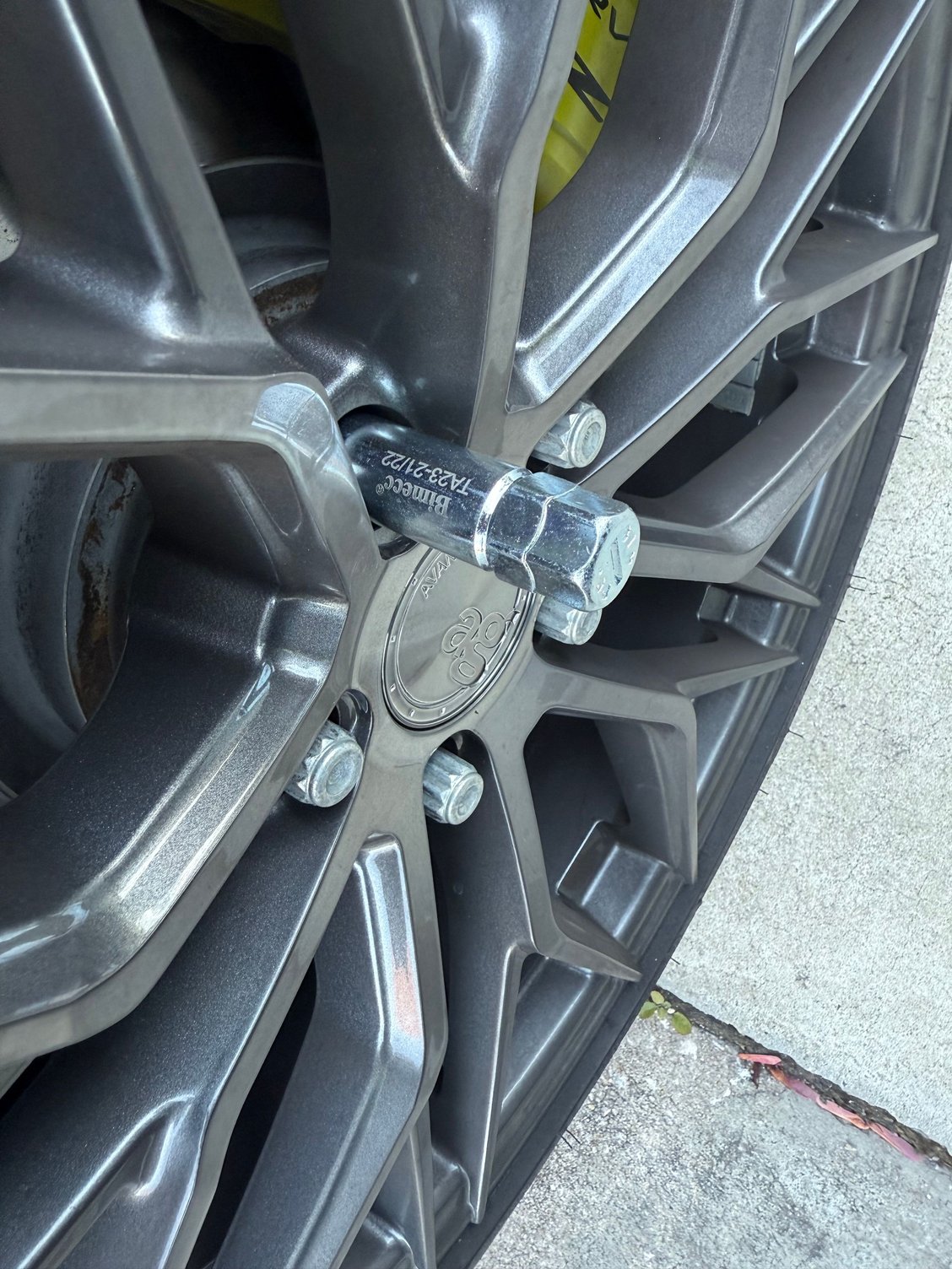

You should have uploaded your picture with the first post not your last edit. Then using the picture, you could have right clicked on it and selected Search with Google Lens from the drop down menu. Using the 4 corner adjusters narrowed the focus. So I did. And voila discovered the lug's brand and who sells them. The Bimecc Wheel Lug Kit is sold at Discount/America Tire Stores.
https://www.discounttire.com/buy-acc...ll-kit/p/47345
Wheel Install Kit

Avant Garde wheels have a smaller diameter lug hole and as such require "Tuner" style lug nuts. Standard lug nuts and sockets will NOT fit those wheels. I had them on my car so I am speaking from direct experience with this. Tuner lugs have a much smaller diameter and require a thin walled socket to remove and install them. This is very common for aftermarket wheels. That splined lug is a standard size and numerous folks sell the socket. Discount Tire will have what you need or you can easily find them on Ebay. Tuner lugs are not wheel locks. I usually get 2 sockets as the walls on them are extremely thin and prone to cracking if over torqued.
The splined tuner socket is on the left. A Titan scratch resistant 22MM socket on the right.
The splined tuner socket is on the left. A Titan scratch resistant 22MM socket on the right. The Titan socket fits stock GM wheels.
Here again, the splined tuner socket on the left, compared to a standard 22MM inmpact socket on the right. You can clearly see the diameter difference between the two.
Here again, the splined tuner socket on the left, compared to a standard 22MM inmpact socket on the right. You can clearly see the diameter difference between the two. There is NO WAY the standard sockets and or lug nuts will work with AG wheels and many other aftermarket choices.

Thanks for the information! I did attempt to add the pic but it failed to upload.
Discount had the socket. All gas, no brakes!
