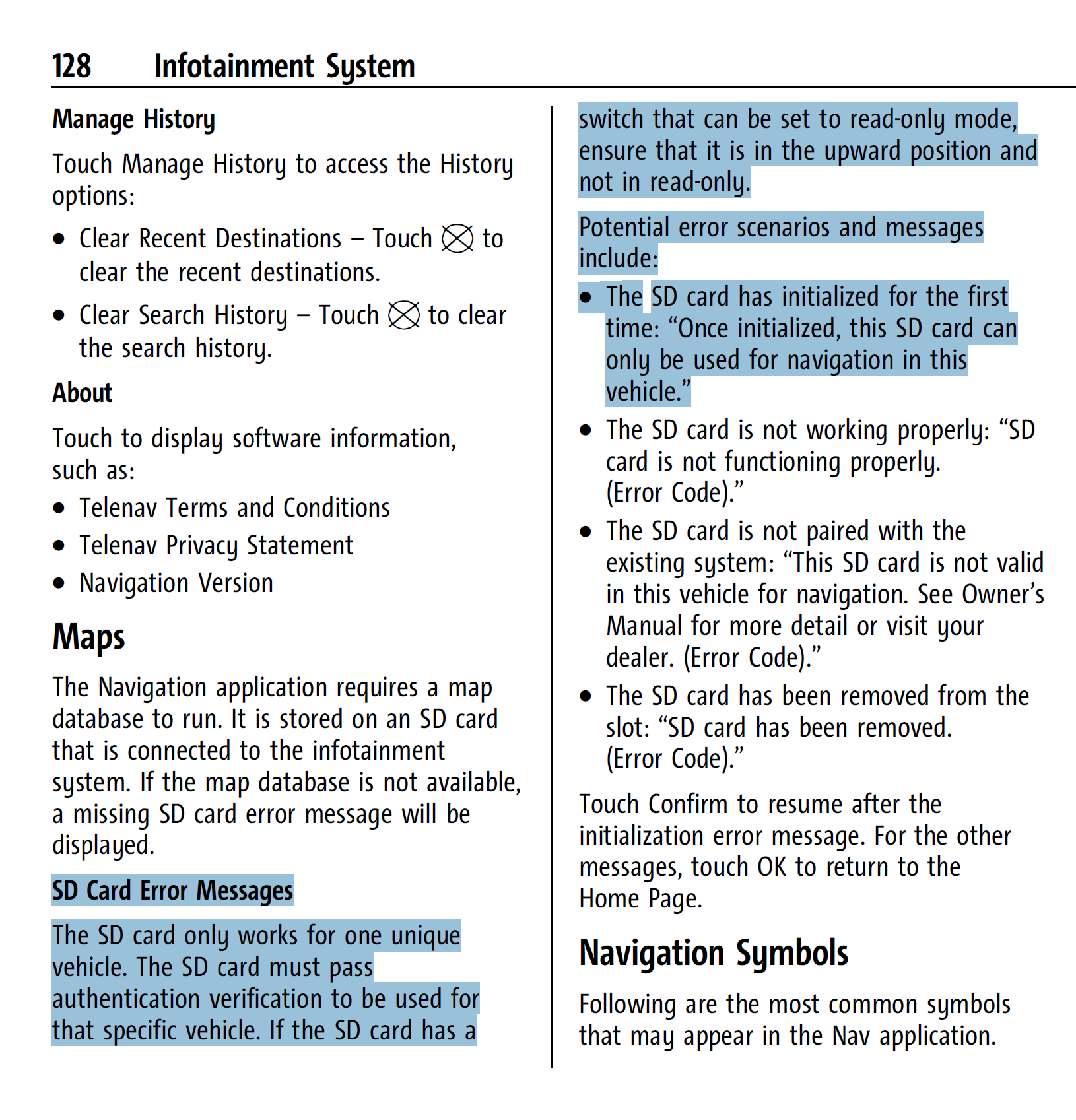

Oh C'mon! Why is that so hard to believe? Its right there in your owners manual if you have a 2020-2023 model year. See attached. Its also stated in the Service Manaul but not everybody has that.
From the service manual:
"Ensure that SD Cards are not swapped from vehicle to vehicle, SD Cards are VIN specific...... Once initialized, this NAV SD card can only be used for navigation in this
vehicle or Navigation ......"
From the Owners Manual:

Yes. But according to both the owner manual and the service manual, this card is intialized when its first inserted in to the car. A new SD card can be put in any C8. It is must not be "write locked". Once inserted, it writes something to the card that permanently pairs with that car. Thats pretty much what the Owners Manual says about it.
That why we can (or so forum member report) buy an ebay card - its not unique to a VIN until its put in for the first time.
