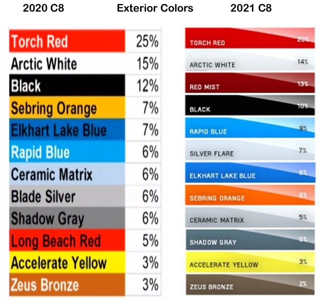

There were no significant early year issues, diffeerent than others, in my observation. My 2020 C8 Z51 3LT w/Lift & MRC was fine. No issues in 4 years. The DCT issues was more a matter of luck. Few percent failures. There were a few early DCT cases with porous aluminum castings the weeped fluid. But those would be fixed.
The real issue IMO looking for used cars is there are so many options, exterior colors, interior colors, Z51, non Z51, MRC, NPP, 1LT, 2LT, 3LT and you have very specific desires. All 7 of my Vettes were made just for me in Bowling Green, i.e made to order. In fact, all C8s up until 2024 were customer ordered as dealers WITH an allocation to buy had customer lists waiting!
You're being so specific, odds of finding a yellow with the interior you want AND 3LT at a price you want with mileage you're willing to accept get very small!

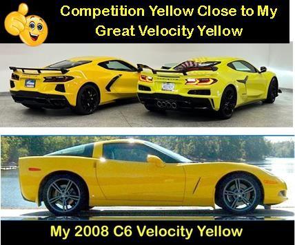

And don't put Accelerate Yellow in the same class as Competition Yellow. I was planning on a yellow C8 like my 2008 C6 Velocity Yellow BUT Accelerate Yellow to me looks like a Safety Vest! I like Competition Yellow and would order.
If you buy new be sure you have seen the color in person.
Accelerate Yellow was also only a 3% ordered color. So you may be waiting a long time!

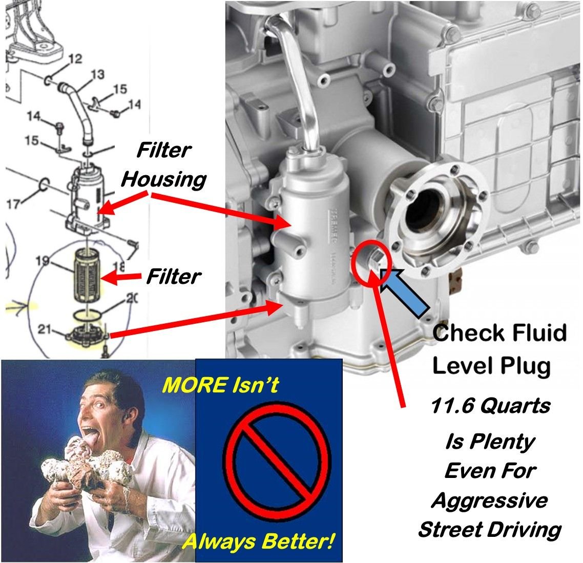

Might feel that way BUT not what gears etc need. The Overfill, which is what GM Exec's admitted it was, can actually cause issues!
In fact Harlan Charles supported by Josh Holder recently admitted they were overly conservative requiring the overfill when Tracking. Harlen said most Trackers would NOT encounter the possible issue of having fluid leave the pick-up at the bottom of the DCT pan. Appears you need to be going downhill and turning at a high lateral "g." As if going down the Laguna Seca Corkscrew!

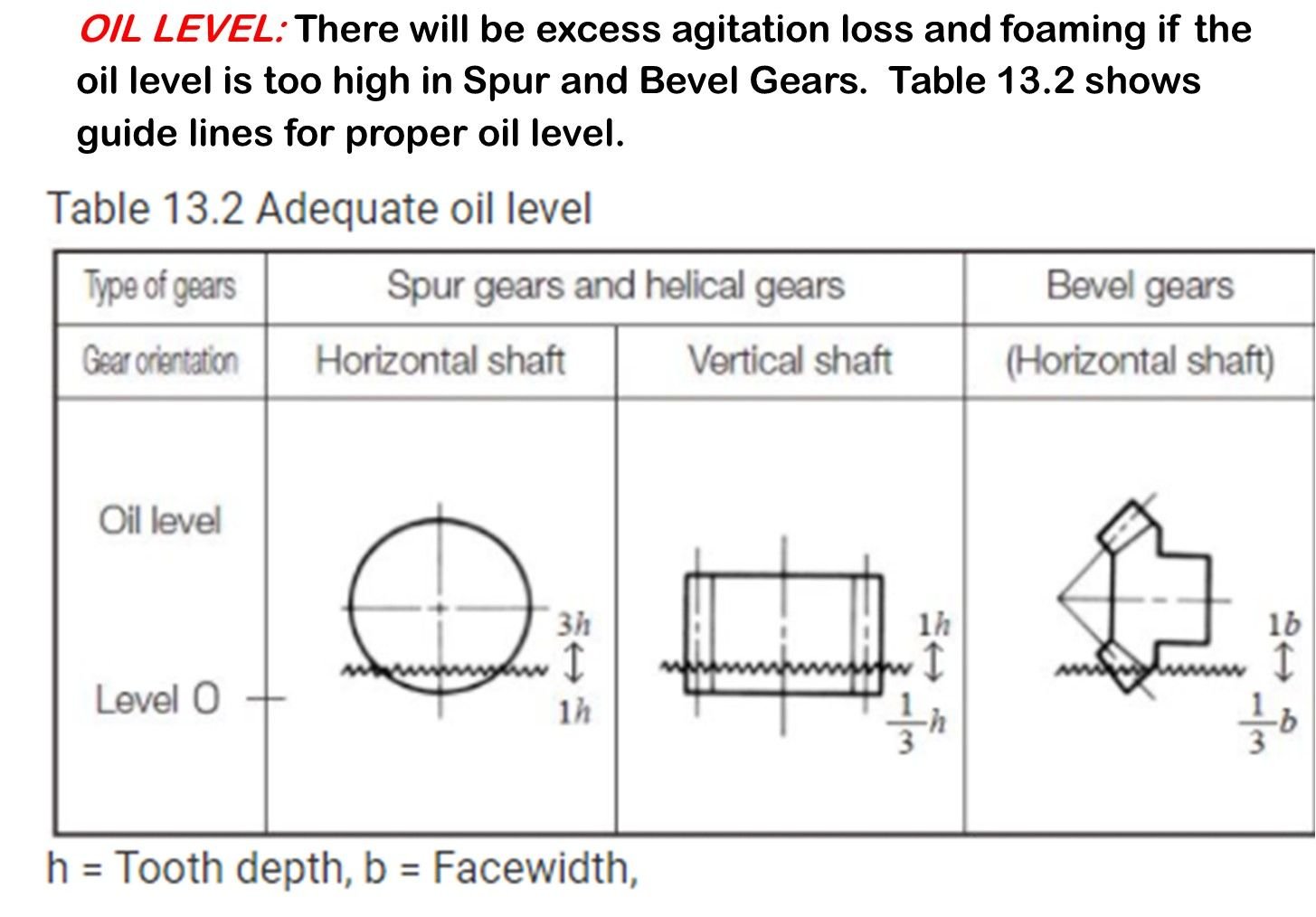

Clips from a Video by a Banks Engineer show what lubrication looks like in a dif as speed increases. The spinning gears in a DCT create a cloud of lubrication throughout the case. It's not a tranquil environment! Nope spinning gear teeth submerged on lub create drag and toss it all over! He showed excess lub caused oil foam (warned about in tech pubs on lubrication. Bubbles make lubrication worse.)
The increased level in the DCT may not be an issue other than as Tadge said causes drag and somewhat reduced mpg. BUT Josh Holder helped a fellow who does high speed straight road racing fix a problem the 2 quart overfill caused! After testing on this car and monitoring what was going on, Holder had him remove the extra 2 quarts and problem was gone.
Nope MORE isn't always better!
