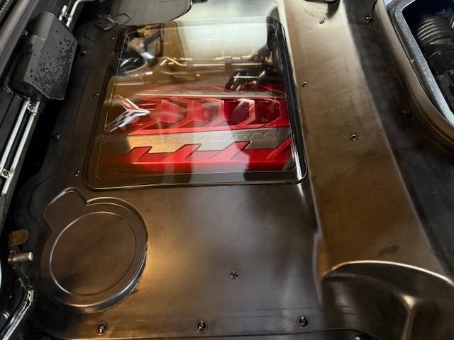

Get one of these GM OEM ones.

Originally Posted by MarkMeHopeful
No problem at all - just do it. However, if you're not going to put on a clear cover why would you want to change to red?
This is why

Just so the OP knows, the red cover he wants to put on his HTC, does not replace the ugly black cover, it goes on top of it, just like the ugly black manifold on the Coupe, without its' cover
. Adding an aftermarket clear lid, has not in my experience, caused any heat-related issues, but what do I know?

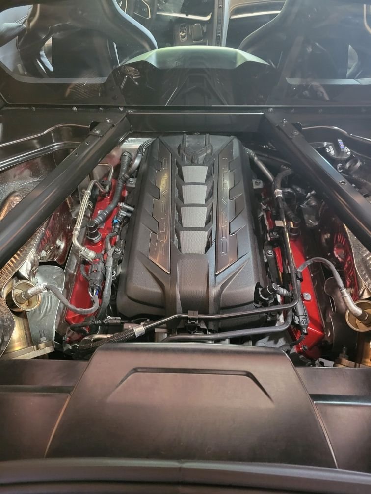

Most definitely not. You cannot run the car without a cover over the engine bay - which is what you are proposing to do. Its ok with a clear engine bay cover, or a window engine bay cover, or the black engine bay cover over the engine bay, but not "no engine bay cover".
For one thing, and I know this as fact...the space above the engine bay cover shares air with the cabin. Air can and does pass between the cabin and the area where the nacelles meet the cabin. I have noticed this while running the A/C with cabin closed, and the tonneau open, and cold air can be felt exiting around the area where the nacelles meet the cabin. With that cover removed, you will be sharing air with engine bay and the road, etc.
Next, the engine bay cover plays a role n directing the air the enters through the rear side scoops and exits out the rear vents. With that cover, there is no telling what that will do to the air flow through that space.
You can try it if you want - but its seem ill advised to me.

Perhaps as important as any. Those who have removed their engine bay cover just for inspection, have seen considerable dust and debris in the engine bay. If you remove the engine bay cover, and run with your top retracted, the top and headliner will be exposed to all that road dust from the engine bay.
