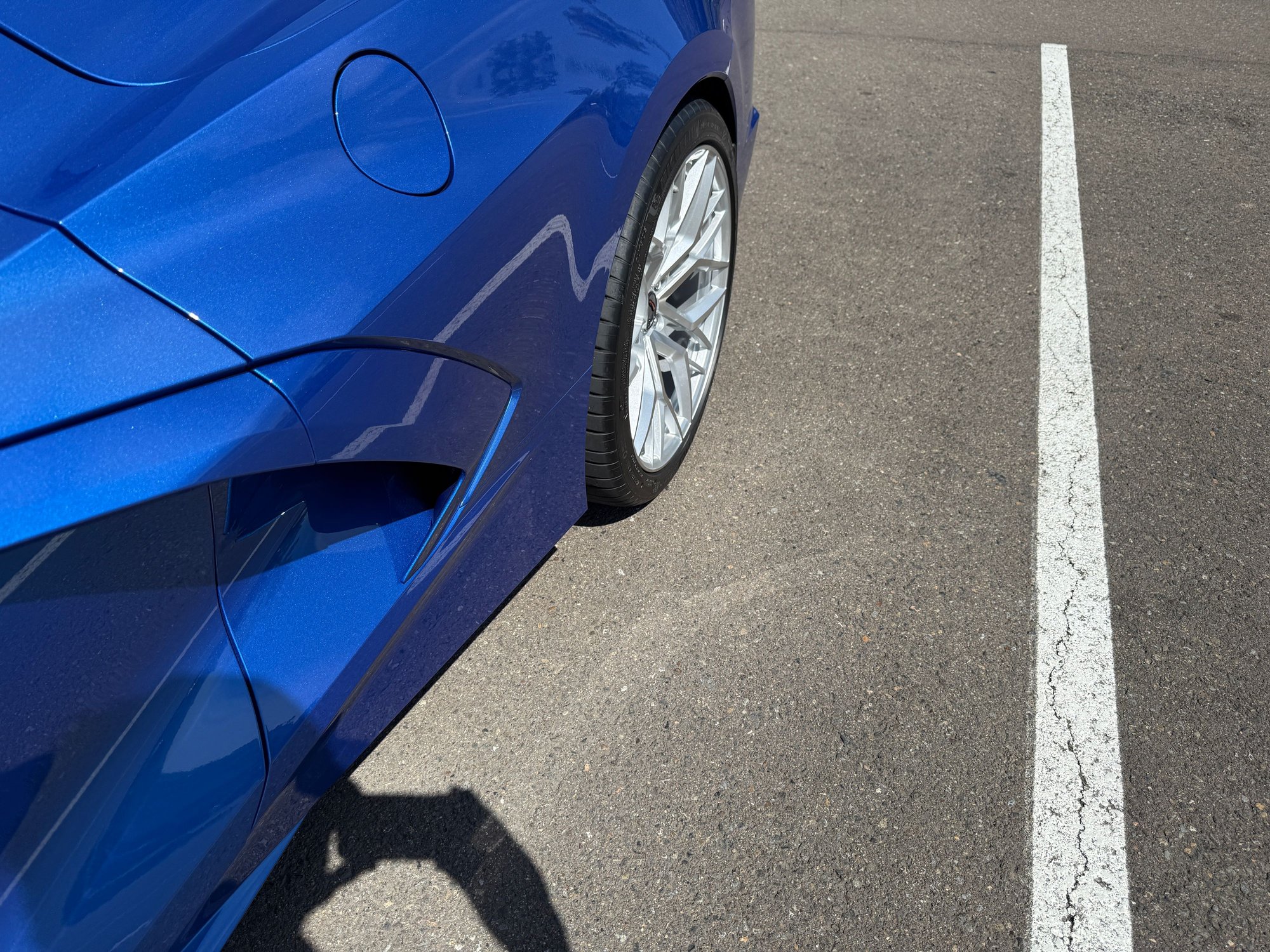

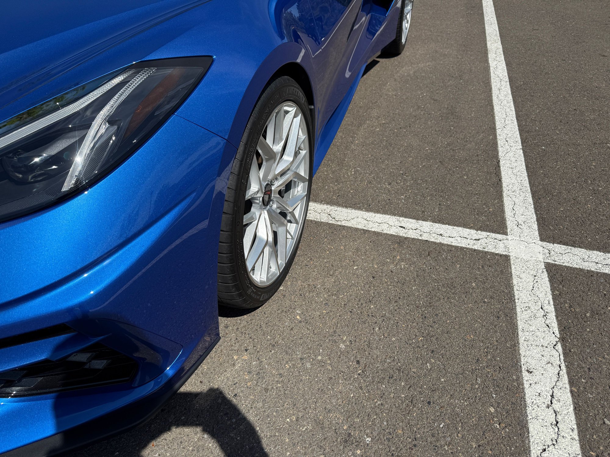

Alt Forged 34, 45. OEM width. At first they seemed really out there, but after a few weeks of looking at them, they seem perfect. I will take some pictures tomorrow from more of a front view.

No rub at all. They are perfect. They looked wide at first, but now they look perfect.
I tried to take some pictures to show how they fit in the fenderwell, but it is hard to get the right angle that shows that.
19" 20" ALT Velocity Rotary Forged Silver Machine wheels rim for C8 Corvette Z51 got em on ebay from GEM Motorsports.
