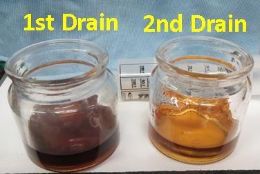

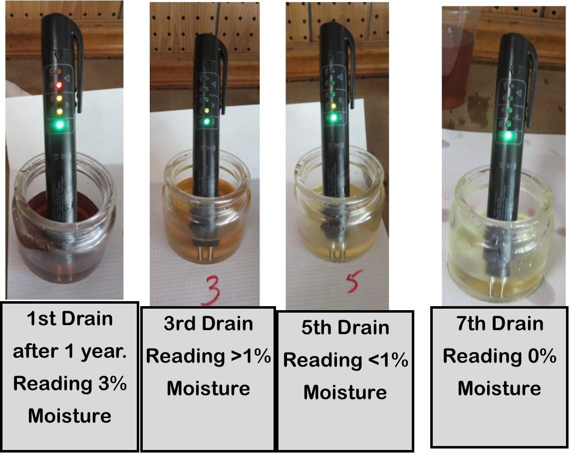

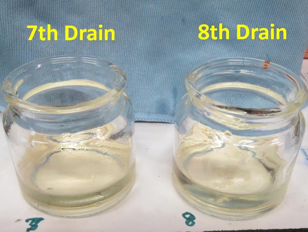

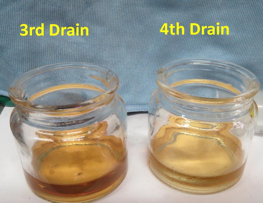

Remined what I used to do with my C7 standard shift hydraulic clutch fluid (also brake fluid.) Did it once/year. A lot easier than a flush! It was called the Ranger Method, and required removal the fluid from the reservoir, put in new fluid, operate the clutch 30 times to get the new fluid to mix with the old and repeat. I measured the moisture in the fluid after several cycles. Not sure how it would work with the brakes but may be good with the Lift.

I'm thinking about using the Ranger method when I change my front lift fluid. Replace the fluid in the reservoir, actuate the lift several times, and repeat as necessary.
People have reported good results using the gravity method to replace the brake fluid.

I just looked at my lift fluid. It's clear BUT a moisture meter is cheap. Worth checking what it is and how much in reduces. Easy to do many lifts. Just have to keep pressing the button!
I had calculated the volumes when we were having fluid leak past the original caps. My early solution was, as someone found, keeping the fluid level low. There is more fluid in the lower reservoirs than upper. BUT it all moves with a lift so should mix well. Should not take many refills to get to 0 moisture! And should NOT keep brake fluid after the container is open!

Yes, I have one. I also have some test stript but they may be old. Our old Hyundai Azera didn't have a scheduled brake fluid change but it said to check every 3 years with a test strip and replace as necessary.
