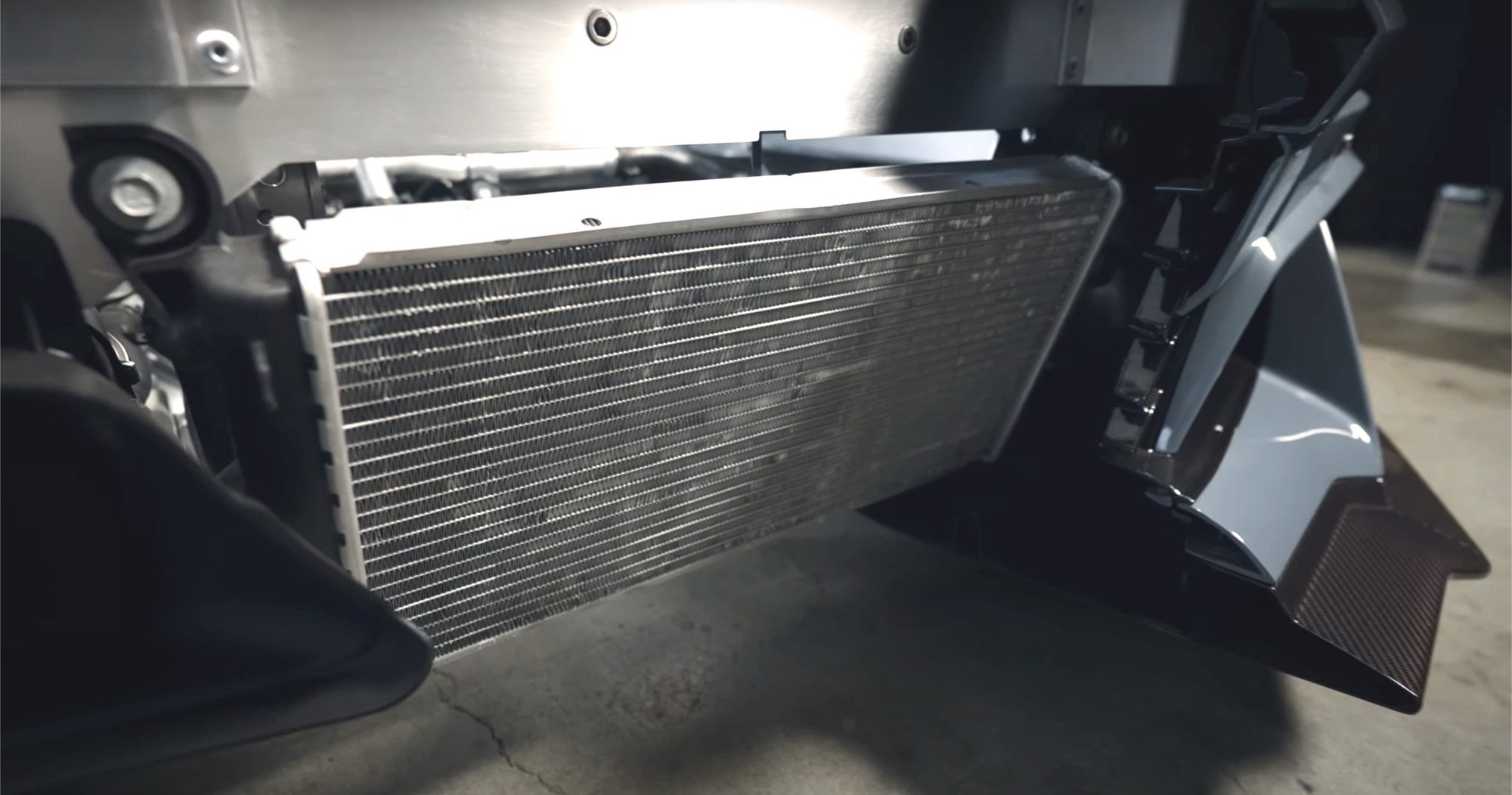

SIDEBAR
BTW I had 1/4 inch hex Custom Car Grill AC Condenser protective mesh on the 2020 C8 Z51 for 4 years. Did not see a difference in coolant or oil temp on hot days. Have no mesh on the E-Ray. It does have a third coolant only Rad in the front center (same as the Z06.) It also has an extra EV Electronics coolant rad that covers ~20% of the in front right AC Condenser/Rad. The left front rad bottom ~25% is used for EV motor cooling.
Right AC Condenser/Coolant Rad is Covered ~20% with EV Electronics Cooler Rad
Center Rad Coolant Only No AC Condenser in Front
