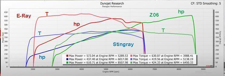

Originally Posted by Dads2kconvertible
I wonder if anyone has had a C8 on the Dyno and shared the results?
For those who want details:
Paragon used two Dynos for the E-Ray tied together with a belt. As they said the software requires feedback from both front and rear to get max power readings. Tough to beat 100% torque at 0 rpm with an electric motor AND traction from FWD. Why on street pavement the E-Ray is ahead of Z06 about a car length after about 1 second after Launch!
