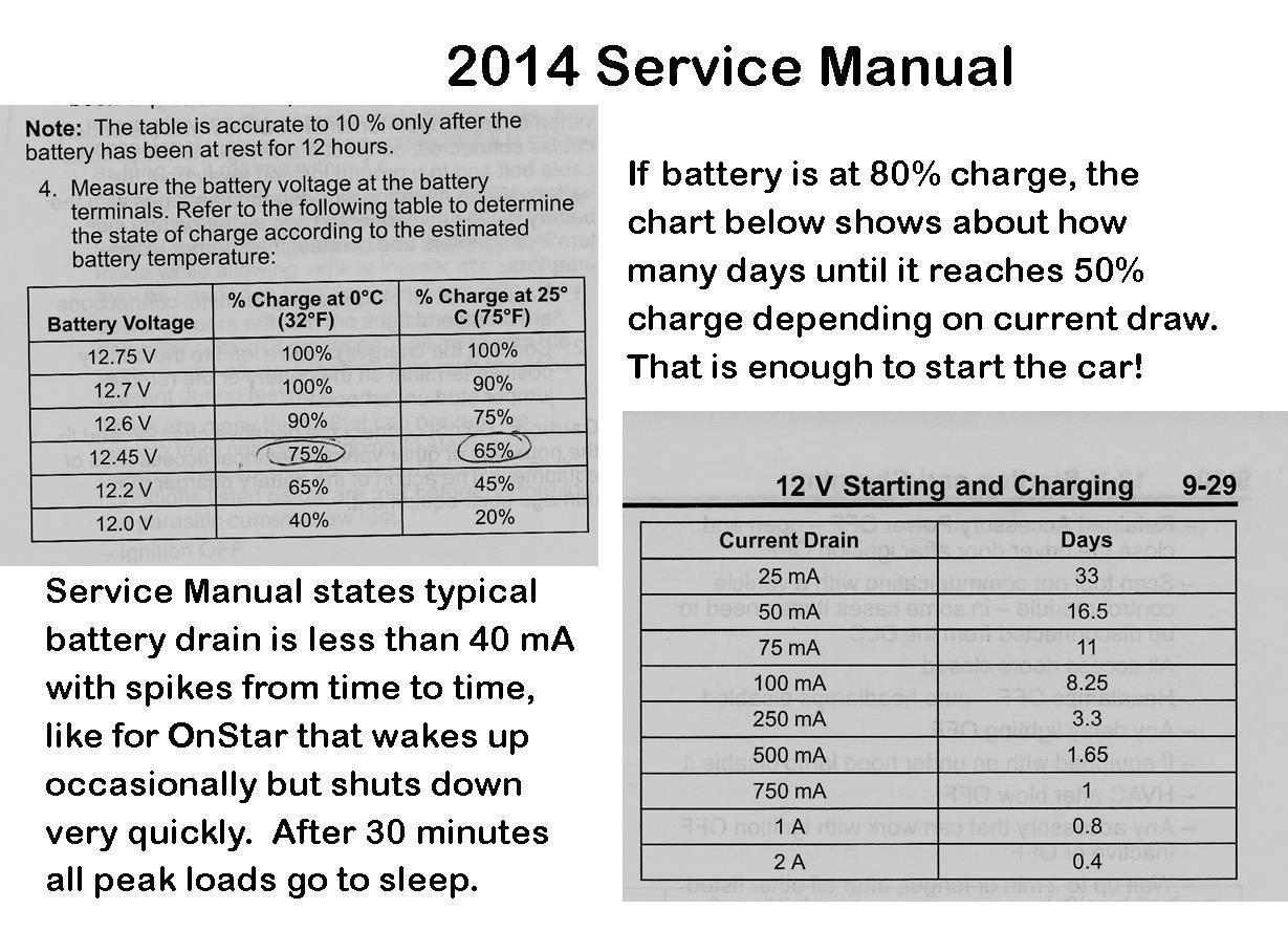

I seldom put the 7 Vettes on a charger. Since I got my 1st C7 still drive at least 2 to 3 times a week and typically ~60 mile round trip to town. That is enough for the alternator to charge the battery to the 80% GM allows as max in C7s and C8s.
Have been on 3 week vacations several times with my 2014 C7 and 2017 Grand Sport. No charger, car started fine when I got home. Recall with a C7 someone posted they had left at an airport 5 weeks and it started. that is pushing in.
This info is taken from my 4 volume 2014 C7 Service Manual. It shows with an 80% charged battery (all the C7 and C8 will charge to save energy) that with a 25 milliamp parasitic current draw the batter will be at 50% capacity in 33 days. That is sufficient to start the car according to GM. Both the C7 and C8 have circuits that shut almost all parasitic current draw in ~10 minutes. Member @Andybump measured only ~10 milliamps (that is 0.01 amps = the same energy a 0.12 Watt Bulb) on his C8 after ~15 minutes. So it should go more than 33 days. BTW 50% capacity is ~12.2 volts for a lead acid battery

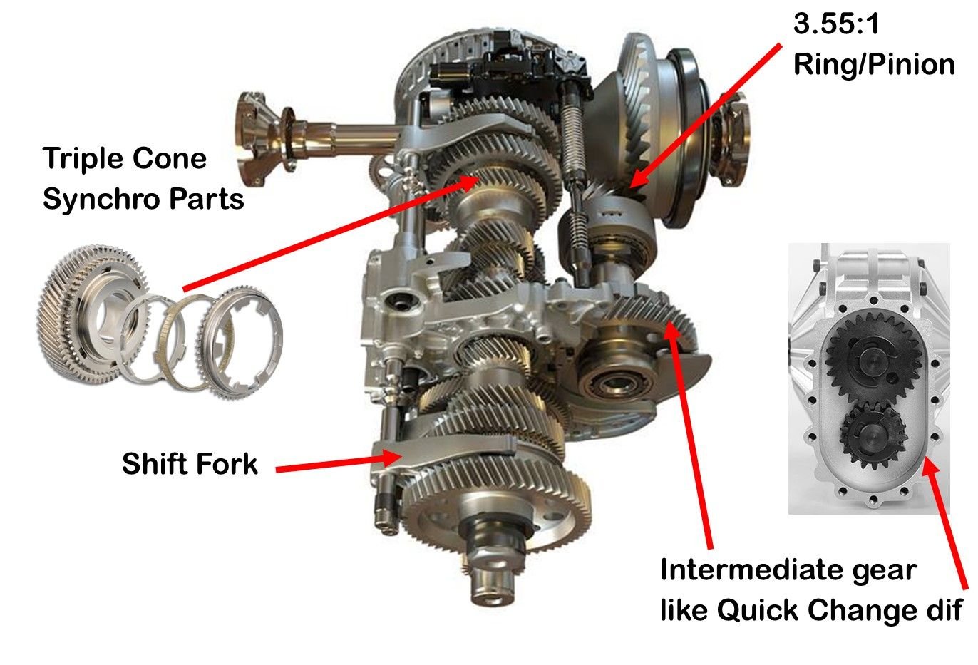

My observation re the DCT "failures" is a bit different than Chicken Little it's terrible.
The positives:
  • Folks have installed turbos and produced over 1000 hp with minor changes, like cultch disks and axles.
  • Even the ZR1 has minor DCT charges.
  • Dealers have been told my GM Service to just perform a Flush when given the CEL code #. For many that solved the issue.
  • The Tech that worked on >50 DCTs said there are so many sensors, like 3 pressure sensors, many position sensors so it will not switch clutches gears unless every Shift Fork is where it should be etc. He showed over 100 CELs and said he only had 2 the same.
IMO the reason Dealers replace the Transmission could be for one position sensor failure. Dealer Techs are not to open the transmission to find and perhaps fix an inexpensive sensor, solenoid etc. From my experience with Automotive Vendor Supplier Contracts, Tremec is on the hook to replace the Trans during GM's Warranty. And they have probably to reimburse GM a fixed fee they pay Dealers to replace the DCT.
When Warranty is up, Trans repair shops will be fixing. Probably like a standard Trans there will be few issues with shift folks, Sychros, bearings, gears. The control components, sensors, solenoids hydraulic actuators will not be that costly to replace.
I still wonder what Tremec is doing with the retuned transmission.s They are not just becoming Boat anchors. Will they be repaired sold as replacements? Is a Trans replaced with only few miles, repaired being put back in service?
Yep the DCT is essentially two 4 speed standard transmissions with hydraulic actuators moving the shift folks instead of a lever. It has many sensors, solenoids that can fail or clog with clutch debris.
