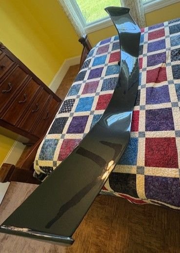

Received my wing yesterday, got delayed in Nashville for a day, but it is finally here. The box is heavy duty cardboard and I like that Paragon added the edge protection for the corners. The wing itself was well protected with multiple layers of bubble wrap. They also added additional protection for the winglets. The support bracket and associated hardware were also bubble wrapped. One negative is that those items were just laying loose in the box, IMHO those should have been secured in the box, especially the bracket. Nevertheless, all items arrived intact and no damage was noted. The wing is flawless, paint is glossy with no defects noted in the paint or clearcoat. Impressed with the seamless attachment of the vertical supports and winglets. The support bracket is made of steel, 1/8 inch thick and heavier than I was expecting. The holes are clean, uniform and free of burrs and the bracket is painted or powder coated matte black. More than enough bolts, washers and rivet nuts were provided. The bolts that hold the bracket to the wing uprights are M10 x1” and the bolts that hold the bracket to the body of the car are M6x1”. Not sure why M10 were not used, seeing that the instructions direct a 3/8 inch hole to be drilled thru the body “trunk tub” of the car. I suspect with the 3/8 inch hole and the M6 bolt there is enough play in case someone doesn’t drill the hole in exactly the right place, even though there is a template provided. Installation instructions are concise with related pics and I like how they provided a QR code to their youtube installation video. Watched it a number of times already and the install seems to be very straight forward. The one “pain in the axx” task is the removal of the bumper. Did that before, when I upgraded the exhaust, so I am hoping it goes a little smoother. The difficulty are those two upper nuts joining the bumper to the fender, as most of you know, who have done that! Well, that is it for now.
Waiting on spoiler delete fins from AG motorsports.

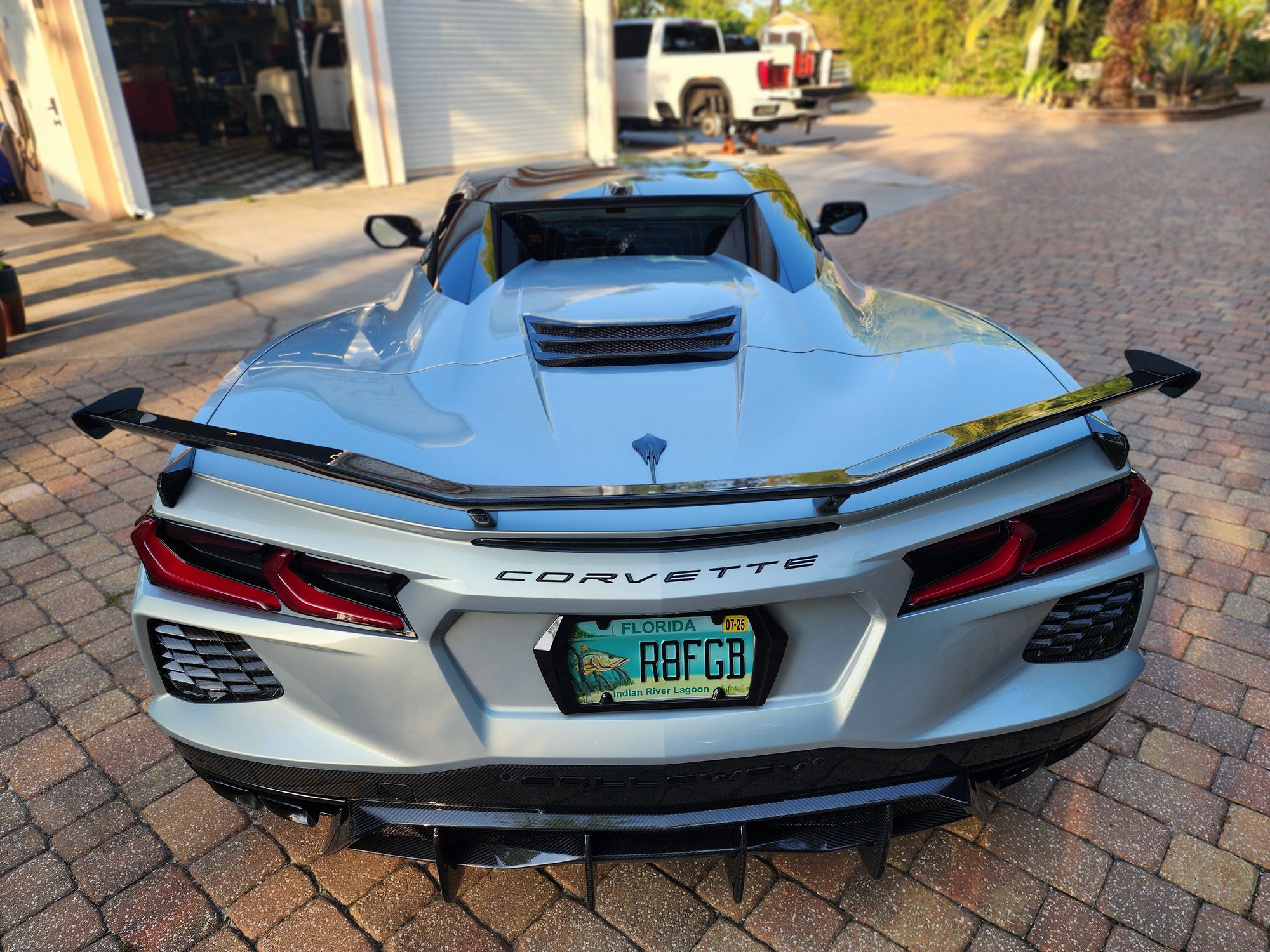

I went with AGM. This the spoiler with delete fins.

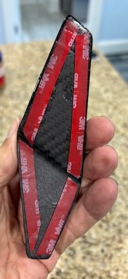

Just got my AGM Spoiler Delete Fins. They are well made. It is the best carbon flash metallic paint, I have ever seen. It is flawless with a deep rich color! Can't wait to install them. Here are a couple of pics.
