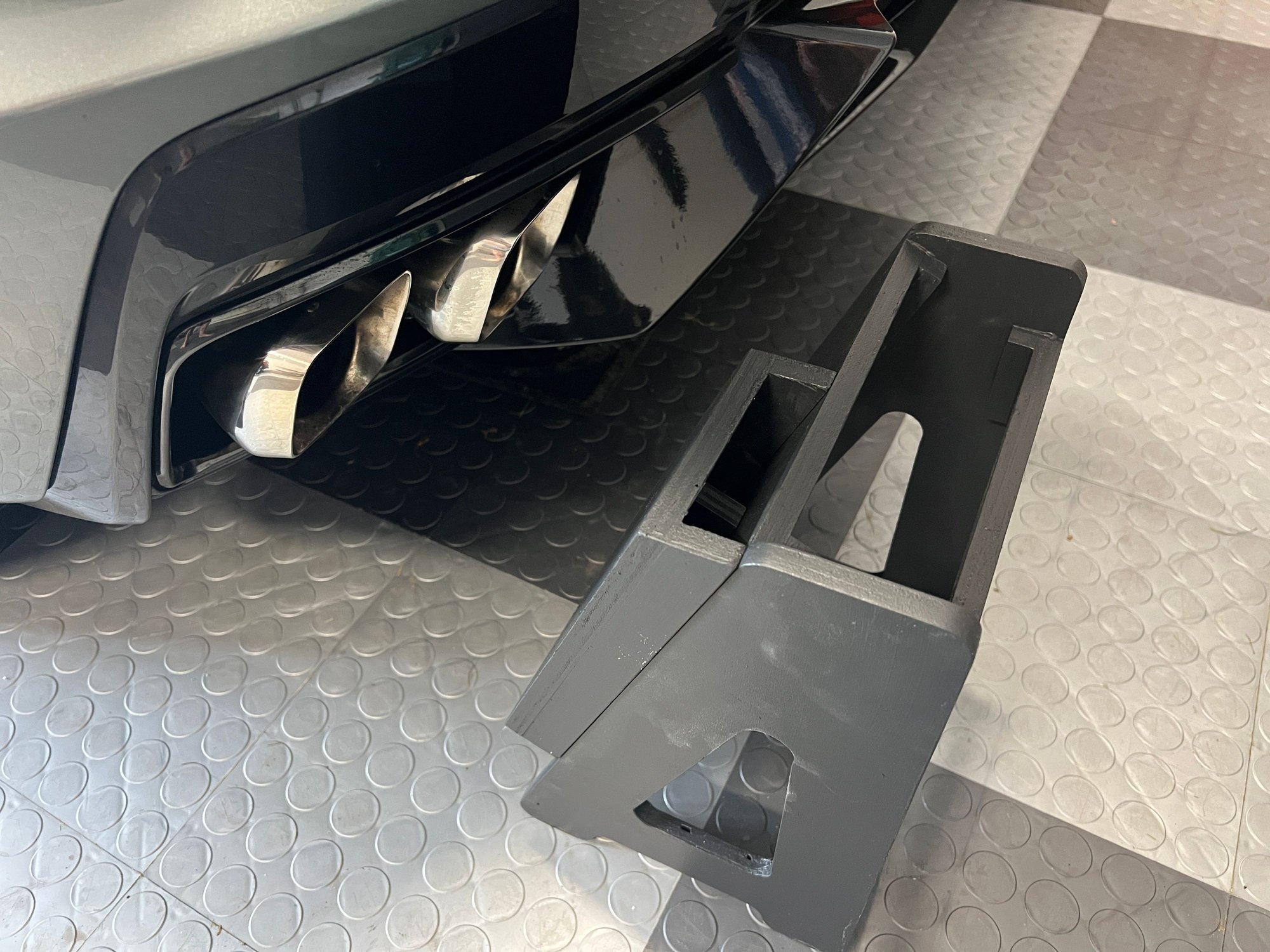

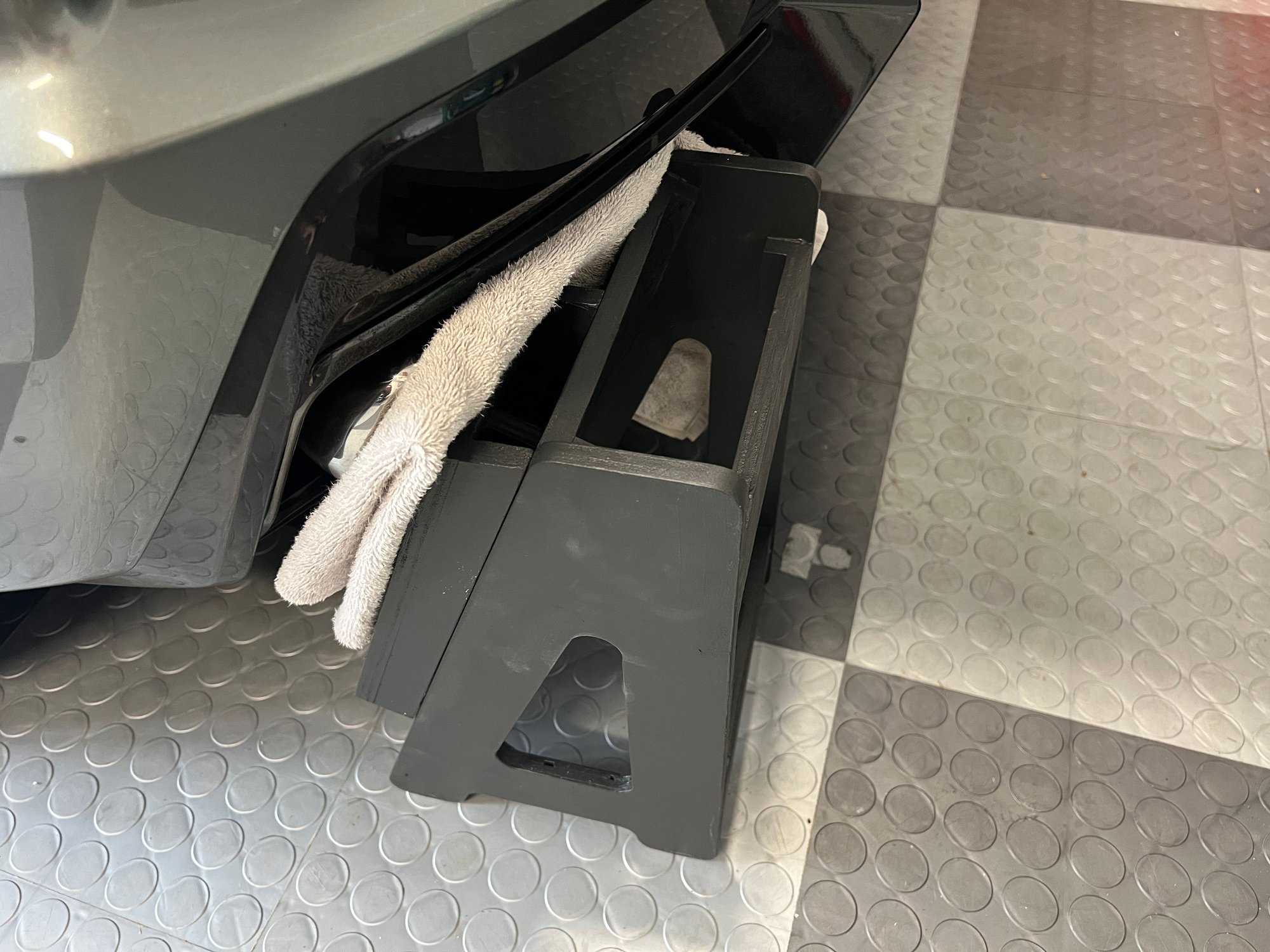

First off, I LOVE the startup sound of my Stingray. My neighbors? Not so much. I live in a condo development of duplexes (twins in some regions of the USA). We have "roofmates" that are conjoined at the garages and the living spaces. The developers did a lot of extra work to segregate sounds, but the Stingray is loud on startup. Especially since I back in to the garage. To help calm the HOA from breathing down my neck, I have made a couple versions of a sound tamer that I fondly call the "Muffler Muffler". It is comprised of a bespoke build that replicates the angle and offset of the exhaust tips. I intended on covering it with a foam product as the sound absorber, but in my excitement to test, I simply draped an old towel over the A frame and tried it.
In a startup test using an iPhone with a NIOSH sound level meter utilizing the phone's microphone I measured peak with open pipes at 124.4dB. With the muffler muffler in place it was 116.3dB.

A for effort.
A for creativity. Hope it helps.
