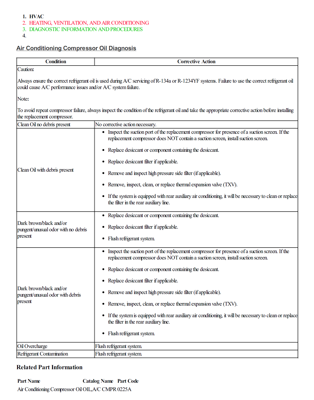

I'm gonna add to post 3, which is correct.
In the version of the service manual I have, the procedure for replacing the compressor itself does not include instructions for flushing the system or replacing other components. But like @RKCRLR said, normally with a hard compressor failure the system needs to be flushed and other components need to be replaced.
The procedure for replacing the compressor calls another procedure called "Air Conditioning Compressor Oil Balancing" . And in turn, that procedure calls another procedure called "Air Conditioning Compressor Oil Diagnosis". And that oil diagnosis procedure will likely lead to the requirements for flushing the system and replacing the components. There is also a blanket statement somewhere in there that says if the system was open for more than 4 hours the desiccant or the component containing the desiccant must be replaced - which would happen if the compressor broke open (which we have seen posted on this forum).
Sp, to wrap up this short story made long - here is list of possible issues that the indicated oil analysis may lead to - did your dealer do any of this?
