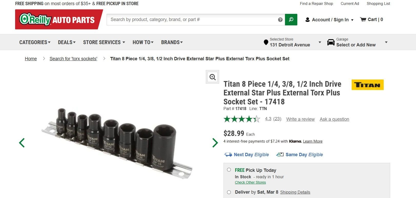

Old Aug 12, 2025 | 06:43 PM
Phil1098's Avatar
Phil1098
Joined: Aug 2019
Posts: 12,351
Likes: 14,180
From: Central Illinois
You can get a set at O'Reilly's for a fair price.

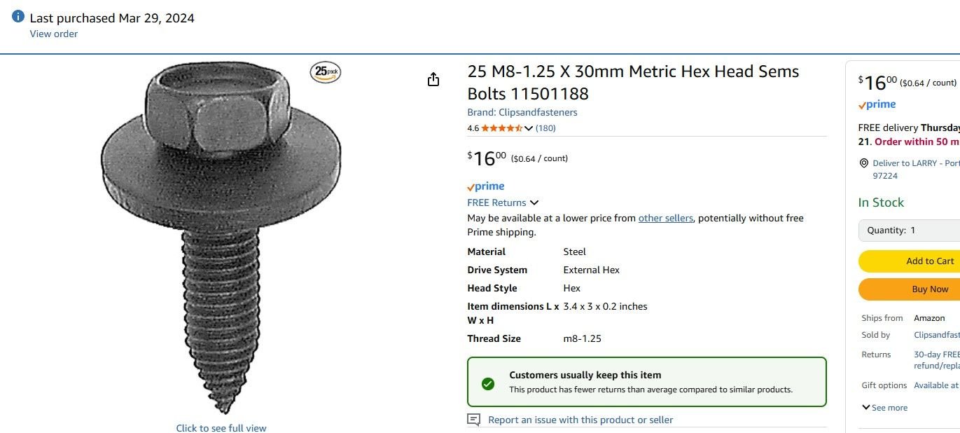

C5racecar's Avatar
C5racecar
Posts: 2,272
Likes: 1,828
From: Oregon
Buy the Torx socket. Take those bolts out and throw them in the trash.
I replaced them with hex head from Amazon.
It only took one time removing the cover and fighting with the Torx socket to realize they are a real pain, there is no benefit to them.
