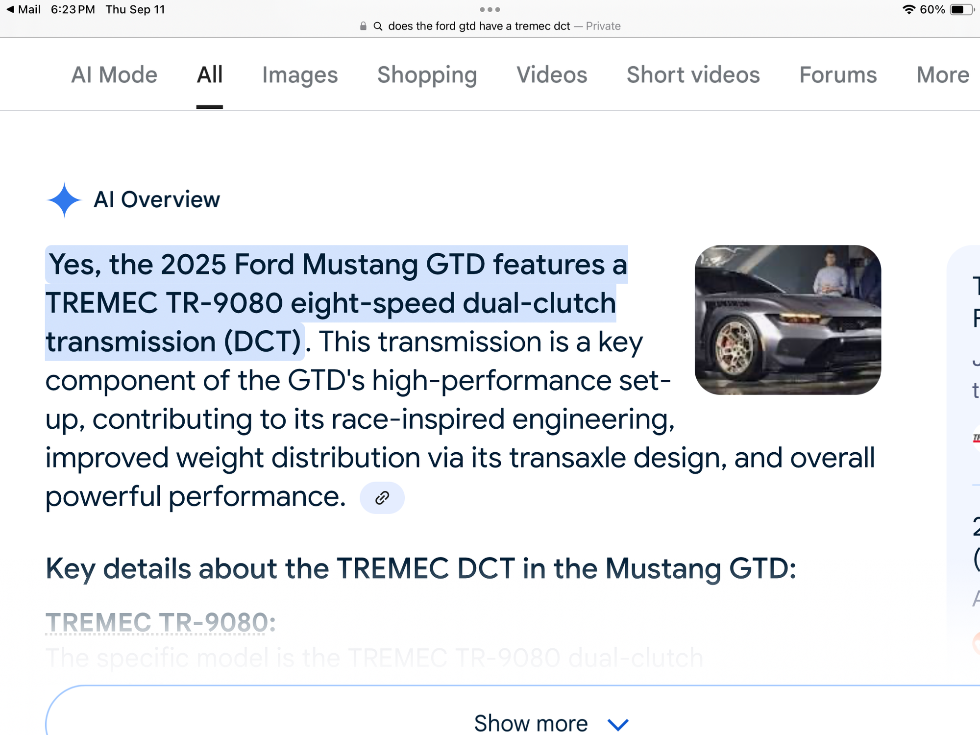

How much do we know about the TR-9080 from Tremec? I remember Tremec made the T-56 and put it in the SS/Z28 Camaro, Firebird, and likely a host of other vehicles. That was a damn fine transmission. But of course, being a manual transmission, they were very straightforward and very different than the DCT we have, with all its complexities.
I wonder if these transmission issues are all different with varying points of breaking, or if they are all following the same pattern and settle on one weak point. I don't have any information on it. But I sure would love to see a 3D diagram of the DCT and how it works.
Does anybody know if the TR-9080 is put in any other vehicles besides the C8? What about the differences between a Z06/ZR1 compared to a Z51? I was wondering if they beefed the transmission up for those models. Thanks for your knowledge and help!

I think the TR9080 is pit in the Ford GTD. I know the GTD has a Tremec DCT. I saw a Utube with a Tremec guy describing the 9080 say so. That’s a $350,000 car.

And the Tremec rep said the variant in the ZR1 was beefed up to handle the 850 ft-lbs of torque.
