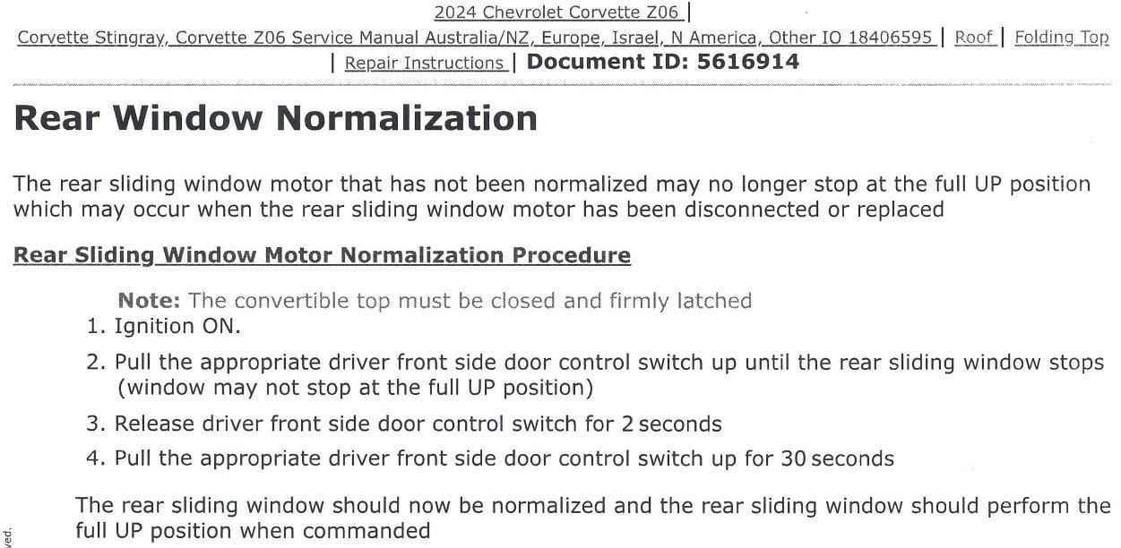

Default rear window "normalization"
Here is a procedure someone posted for "normalizing" the rear window. I have not tried it and do not know if it works.
