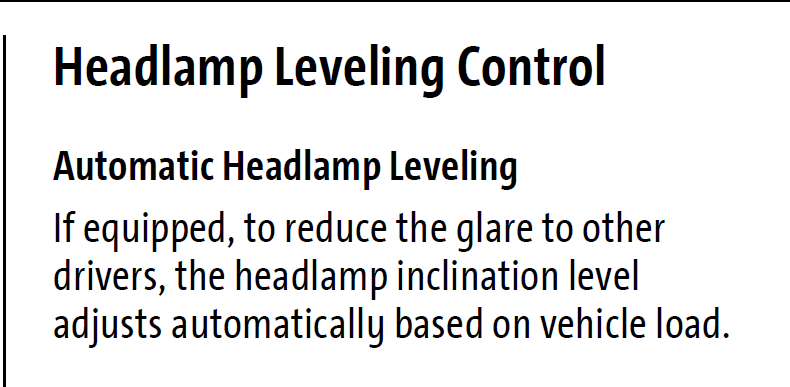

Regarding the front lift, I will add the the vehicle has automatic headlamp leveling. So that will prevent "blinding" of other drivers even while the lift is activated.
Would the car consider front lift enabled as a "change in vehicle load"?
Old Oct 2, 2025 | 07:48 PM
Andybump's Avatar
Andybump
Joined: Mar 2007
Posts: 11,376
Likes: 8,532
How would it tell the difference? Its described in some detail in the Service Manual. It uses signals from left and right suspension position sensors in the front. It does not care if the height has changed due to load, a road bump, or the front lift. From the description, it would appear that the Front Lift System is part of the process.
"Automatic Headlamp Leveling
The automatic headlamp leveling system consist of the following components:
K9Body Control Module
E13LHeadlamp Assembly Left
E13RHeadlamp Assembly Right
K19Electronic Suspension Control Module
B152LSuspension Position Sensor Left Front
B152RSuspension Position Sensor Right Front
The front suspension position sensors provides the K19Electronic Suspension Control Module with front suspension position information.
The suspension position sensors are connected to each control arm of the front suspension. As the vehicle travels, the suspension compresses and
rebounds moving the suspension position sensors. This causes the signal output of the sensor to change. The Front Suspension Leveling/Lifting
Hydraulic Power Pack Module sends a serial data message to the K9Body Control module (BCM) with the suspension position information.
The BCM responds to the suspension data by sending a serial data message to each headlamp assembly to adjust the headlamps accordingly. The
headlamp assemblies respond by adjusting the leveling motor within the headlamp assembly to the appropriate position."

Here is a schematic. The leveling motors are actually inside of the headlamp assemblies.

My only thought was that any mechanism that would tell the car to adjust the headlights would be cancelled out by the front lift being on.
Front higher than normal + FEL OFF = adjust headlights
Front higher than normal + FEL ON = don't adjust headlights
