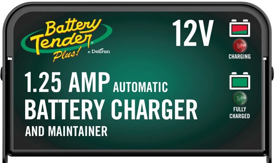

Deltran Battery Tender !!

You guys didn't read the OP's post. He doesn't have access to power where the car will be parked. He has a battery tender.
