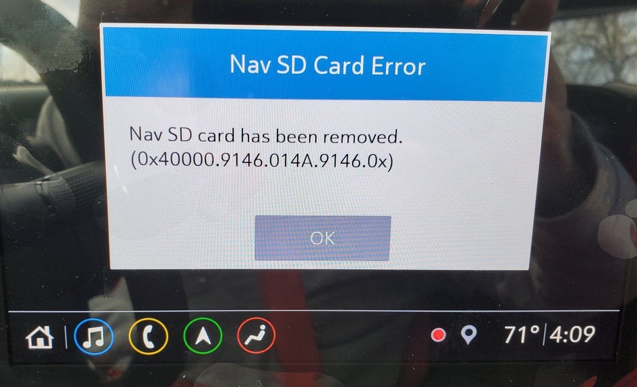

I chased the issue for 6 months on my new 2020 C8 of my >1500 songs not loading at 1st 1/2 the time and after trying a solution developed by a member 1/3 the time! Would get the message below BUT no USB songs loading. Turned out other GM Cars/Trucks with the same infotainment system got the same message AND USD flashdrive songs only loading ~1/3 the time. Member who improved his 100% and mine to ~25% the time. The USB was loading at the same time on start as other systems on the same Buss. He reduced the file size of each song. I did as well using Audacity. Helped BUT did not go away. Tried the many member suggestions re file type etc. No help.
Went to the dealer and great tech reloaded the Infotainment software. NO help. He then read a note placed in the GM Service Info re the issue that said "IF A SANDISK flashdrive could be the issue." When I asked why, tech said we often post something we found WITHOUT a reason as it is just what we observed.
Bought a new NOT market leader brand and solved the issue 100%. Working fine on my 2024 E-Ray as well.
Investigated and found >50% of the SD Cards, Flash Drives etc sold on Amazon are BOOTLEG! My Industrial experience was "copiers" are smart they copy the Market Leader. In fact our Patented Heliarc Brand TIG Torches when out 1950 thru 1970s patents were up all copiers and even competitors copied our genuine Heliarc TIG Torches and consumables like collets, collet bodies (that hold the Tungsten Electrodes,) Gas Lens, etc. In that case they did not use our Trademarked Heliarc name as our Lawyers soon stopped any who tried. BUT they used our same somewhat unusual part numbers. Today most TIG Torch products come from China and use our old 1950s alfa numeric part number as essentially the model number!
So I bought this quality but off brand name Flashdrive. Same high specs. It solved the 6 month old issue. Worth a try. Also buy from a more reliable source.
