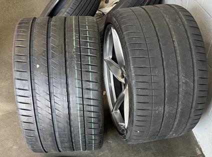

I ended up finding a used tire with a good date code and the same tread depth for $135.

Originally Posted by CorvetteFan1953
nvm Just saw above you found a used tire
Thanks. I didn't know that they did that.
Old Nov 13, 2025 | 09:02 PM
CorvetteFan1953's Avatar
CorvetteFan1953
Joined: Nov 2010
Posts: 2,281
Likes: 722
2024 C6 of the Year Winner - Unmodified
I didn’t either, Tire Rack doesn’t advertise tire shaving. It came absolutely perfectly matched to my other 3.

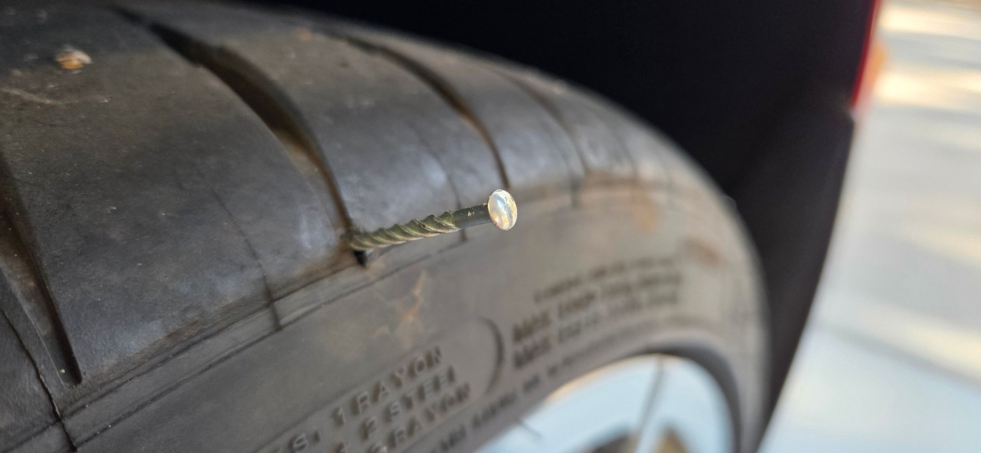

This shows where the nail was in my tire, right on the edge of the sidewall. It was a roofing nail. I just stuck the small nail in the hole to show the location.
Old Nov 14, 2025 | 05:15 PM
RKCRLR's Avatar
RKCRLR
Joined: Aug 2016
Posts: 12,796
Likes: 10,218
From: Garden Valley CA
That's definitely sidewall.
Old Nov 14, 2025 | 06:37 PM
MKC8's Avatar
MKC8
Joined: May 2023
Posts: 1,030
Likes: 370
From: Ontario
Low shoulder.
Old Nov 14, 2025 | 07:10 PM
Kbmwgt's Avatar
Kbmwgt
Joined: Oct 2019
Posts: 746
Likes: 657
From: San Jose CA
definitely do NOT plug. New tire time.
Old Nov 15, 2025 | 01:40 AM
texasredc8's Avatar
texasredc8
Joined: Sep 2002
Posts: 1,529
Likes: 53
From: Houston, TX
The problem with repairing a tire near the sidewall was never about whether the plug will hold or not. Especially with a run flat tire, it just doesn’t matter. Plug fails, air leaks out, dic warning, no problem. What does matter is how much damage the nail, screw or foreign material did to the tire core. From my years of reading and talking with tire professionals, any damage in the sidewall or in that area near the sidewall can cause enough damage internally to cause the tire to fail especially at speeds the tire is rated for. Are you okay at 70mph, probably. At high speed? Definitely a big no. You guys be careful out there. You cannot see internal damage on these tires. The tire could fail internally and come apart. At the very least, you will cause major damage to the body work around that repaired tire. If it was me, the repair would be temporary till I could replace the tire with a new tire. Used tires also need to be thought out. You dont know if that tire was abused internally.

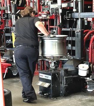

Do as you wish BUT against what Michelin recommends, which (IF not in the outer edge where yours clearly is) when repaired can't be done with a Quicky Plug from the outside! MUST be a Plug/Patch. AND checking for what every 1000 miles?? Probably won't leak BUT there is extra internal reinforcement in the high stresses edge between tire center and sidewall. Some of that extra reinforcement was damaged by the screw AND when putting in a Plug from the outside. The failure will occur when at speed in a corner, don't have to be Tracking.
And since I BOUGHT Discount Tire insurance the week I got my E-Ray (as I did my prior 2017 Grand Sport and 2020 C8 Z51) when I had a nail 1/2 inch in toward the tire center from where your screw was on the outer question, they provided a new $650 tire. AND as all their tire repair, the tire is removed, the Plug/Patch applied (as Michelin and most tire manufacturers require.) Then the tire remounted (not that easy on 13 inch wide rims with low profile Runflats. Then dynamically balanced.
Yep needed new tire with2000 miles and in two years 3 others pug pathed, FREE TO ME.
Plug/Patch, Michelin Requires.
Yep needed new rear tire at ~2000 miles. My ZER Option Summer 345s cost $650- FREE to me!
Not so easy to get a 345 wide, low profile (25's) rub flats to seal when mounting. Discount Tire has experienced folks!
Balancing after remounting.
