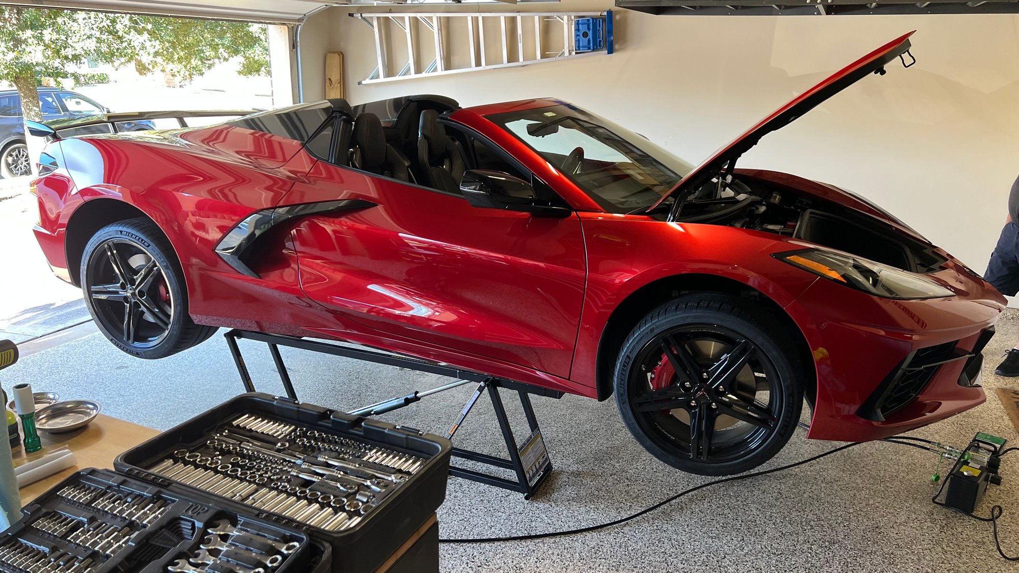

I they don’t make the TLX anymore. Therefore, you need to order the 6000TLX. My 6000TLX arrived before my ‘26 SR HTC Z51. Three days after getting the car, I used the QJ to change the dusty race pads to Carbotech 1521 pads. The QJ worked great. I highly recommend it. I hang mine on the wall when not in use.

Asleep@thewheel's Avatar
Asleep@thewheel
Posts: 210
Likes: 146
From: MD's Eastern Shore

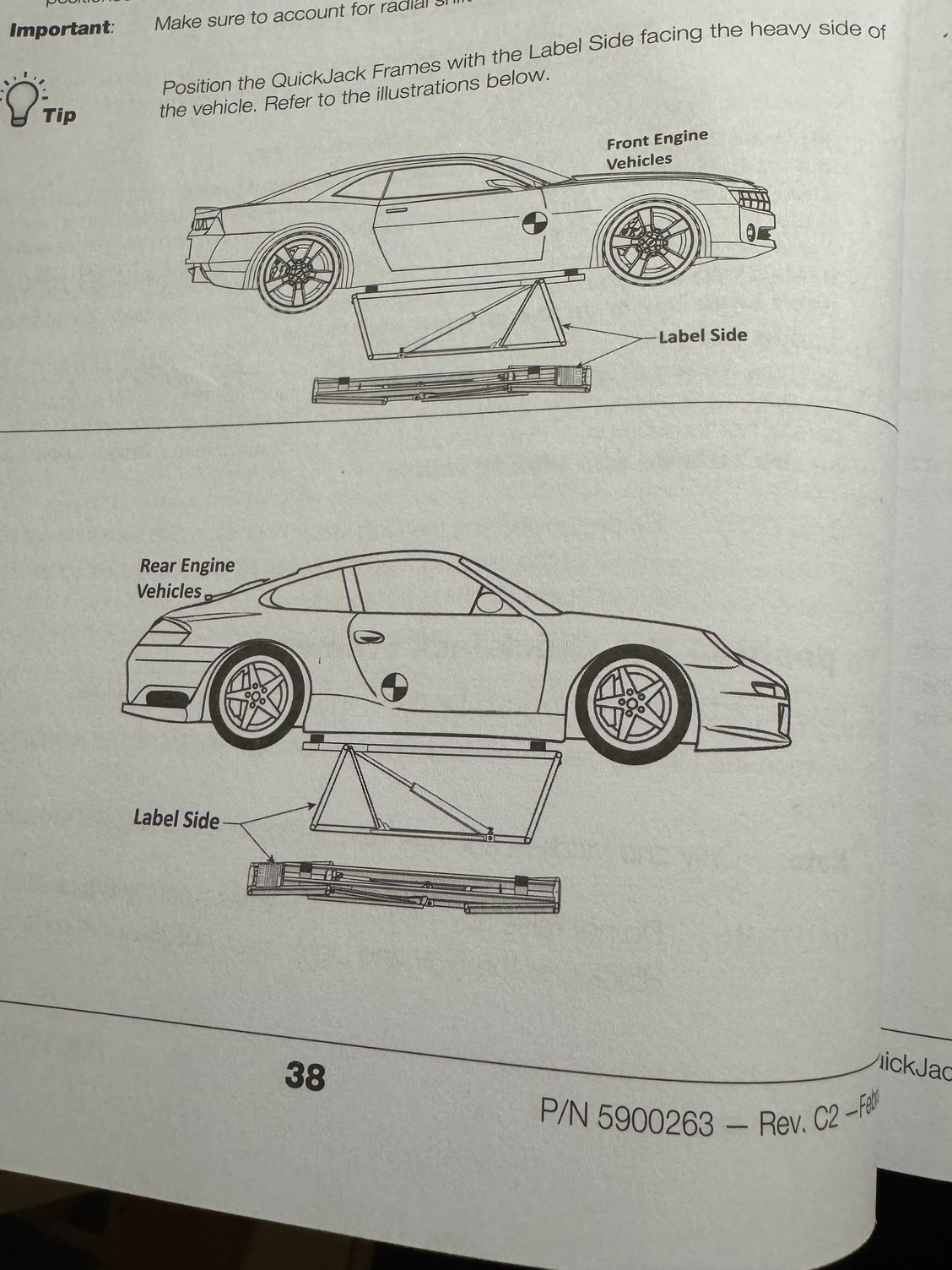

I think you have the QuickJack positioned incorrectly. According to the jack's manual the label side should be at the heavy end of the car. The label is visible in your photo between your tool box and the front tire.
Your's is positioned correctly if it was a front engine car.
From the QuickJack manual:

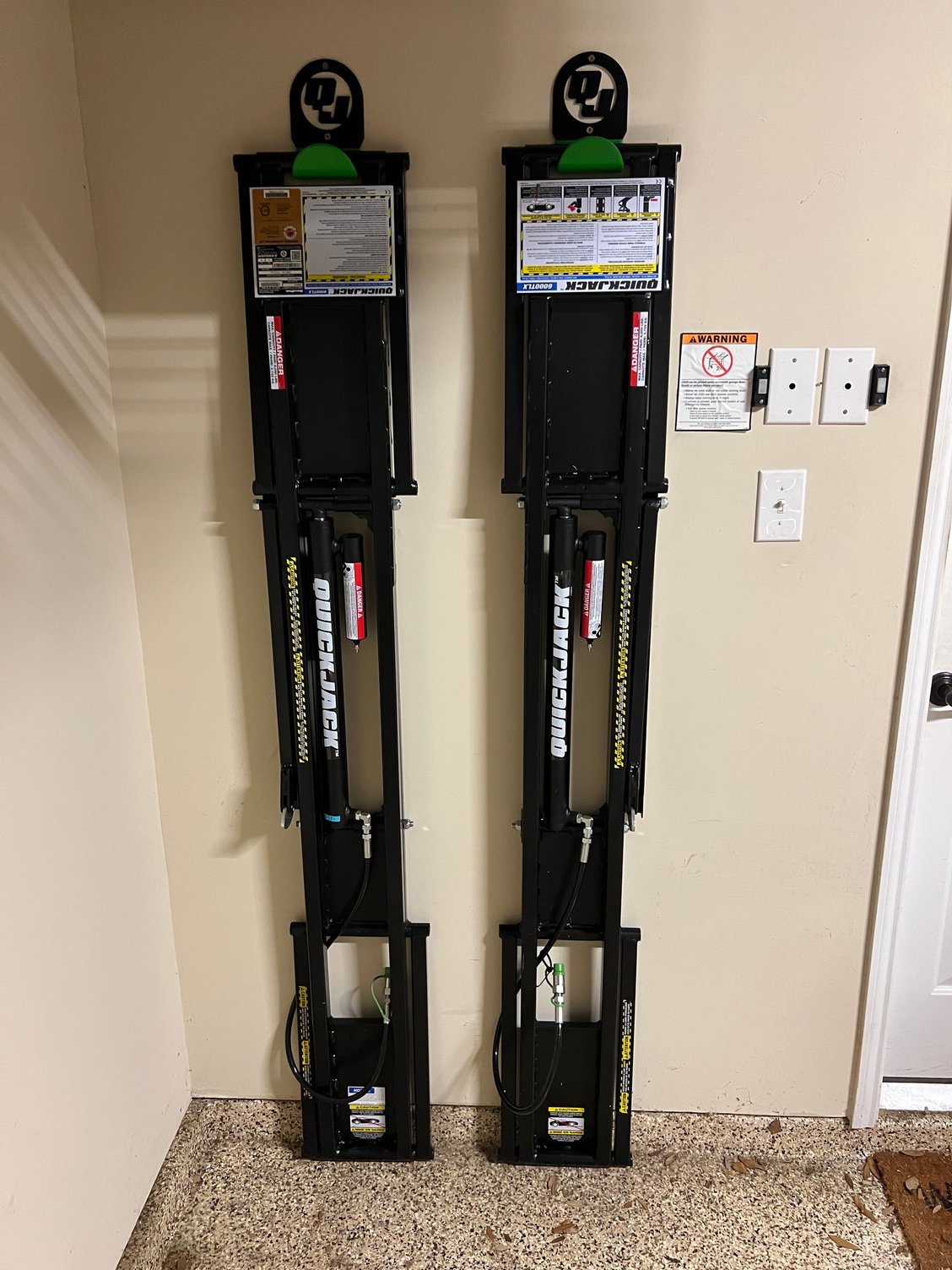

I have the 7000tlx with hangers and truck extenders. I also added ball bearing casters on the opposite ends so it rolls very easy. I also purchased a winch installed on a sliding bar to electronically raise each unit onto the hangers. They are very heavy and didn't want any accidents lifting them on and off each time.
Looks like you might be right. I used them the way I saw others use them with the C8. I will review the manual better before I use them again.
