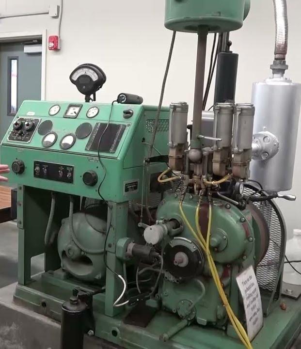

Recall back in the day (early 1960's) in a Lab having to test required octane in a single cylinder variable compression (test) engine. Not a Pic of what we used (although looks like from the era, can tell by the meters!)
Those 3 cylinders on the right look like an Orsat exhaust gas analyzer. Before electronics it used three containers of chemicals that absorbed CO2, O2 and CO and determined exhaust gas composition.
