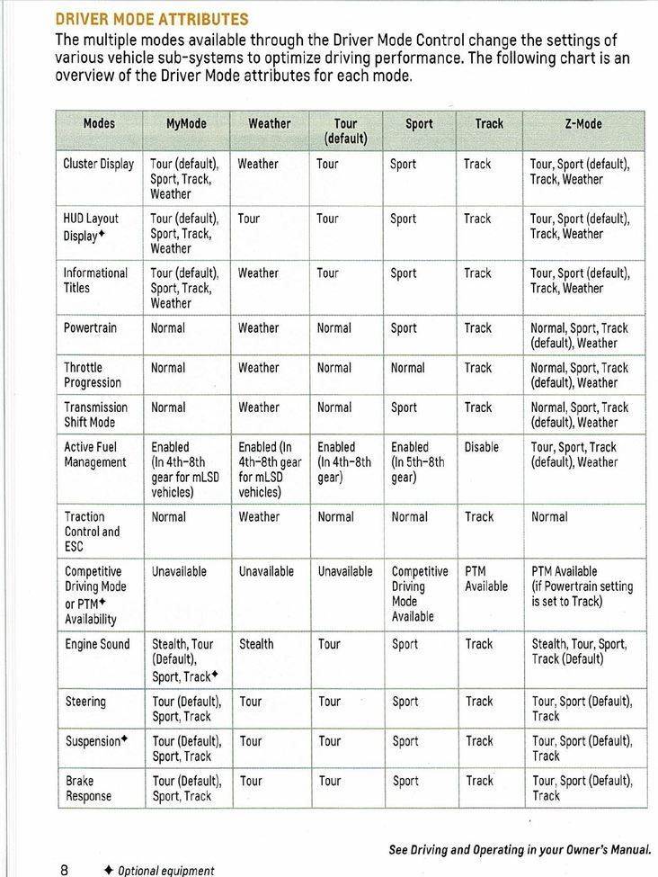

Here’s a table from this thread which is also a good read.

1: Does AFM operate in Z Zmode?
Yes, it can. It depends on the setting of the engine/shift parameter. In Zmode you can change that. If you set engine shift to Track it will disable AFM. If you use any other engine/shift setting AFM will not be disabled.
You can also disable AFM by using Manual Shift Mode, regardless of the Drive Mode or engine/shift setting you are using.

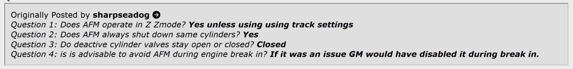

Originally Posted by sharpseadog
Question 1: Does AFM operate in Z Zmode? Yes unless using using track settings
Question 2: Does AFM always shut down same cylinders? Yes
Question 3: Do deactive cylinder valves stay open or closed? Closed
Question 4: is is advisable to avoid AFM during engine break in? If it was an issue GM would have disabled it during break in.
Answered in quote.

Just clarify the answer to question 2, in Z mode, disabling AFM is accomplished by setting the engine/shift parameter to Track. You can put all of the other parameters wherever you wish - so if you prefer the Tour setting for steering, brakes, suspension, and sound, you can use those settings. They do not affect AFM.
