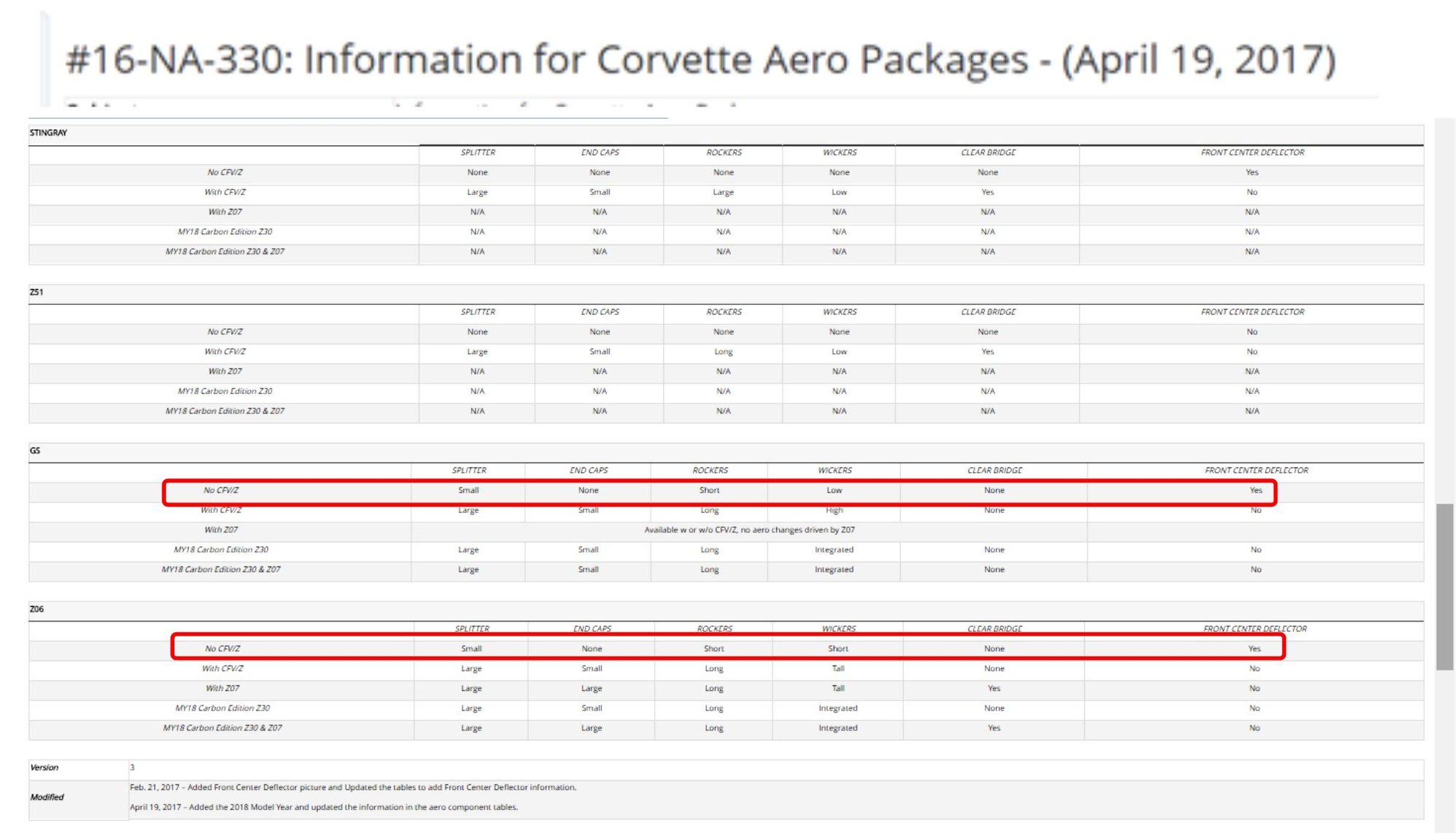

Bednarchik points out that while shapes for improving fuel efficiency typically begin to have an effect at highway speeds, lift and drag components become critical from 150 mph to maximum velocity.
He also said the air dam in the Chevy volt was a large and deep as the Corvette to add mpg at highway speeds.
I thought his comment supplied good for the OP's question: "approximately what speed does the front splitter and the low profile rear spoiler, begin to have a noticeable effect on handling?" The answer is at high speeds well past 125 mph!
SIDEBAR (posting for the Silent Majority who won't/don't post. On this thread ~650 so far versus the <15 vocal minority who do!)
Hmm, I'm not marketing anything! Just pointed out why it took ~2 years to define why the Center Air Dam that was on the 2014 C7 was NOT on the Z51! It is subtle stuff no easy answer! Accept perhaps for folks who think they know the answer!
There was finally after 3 years a bulletin that defined where a large center air dam is and isn't used. BUT only Tadge's comment re to eliminate Oversteer at high speeds,
This is data by Paragon, a good source for reliable data including this on aero effect with speed.
